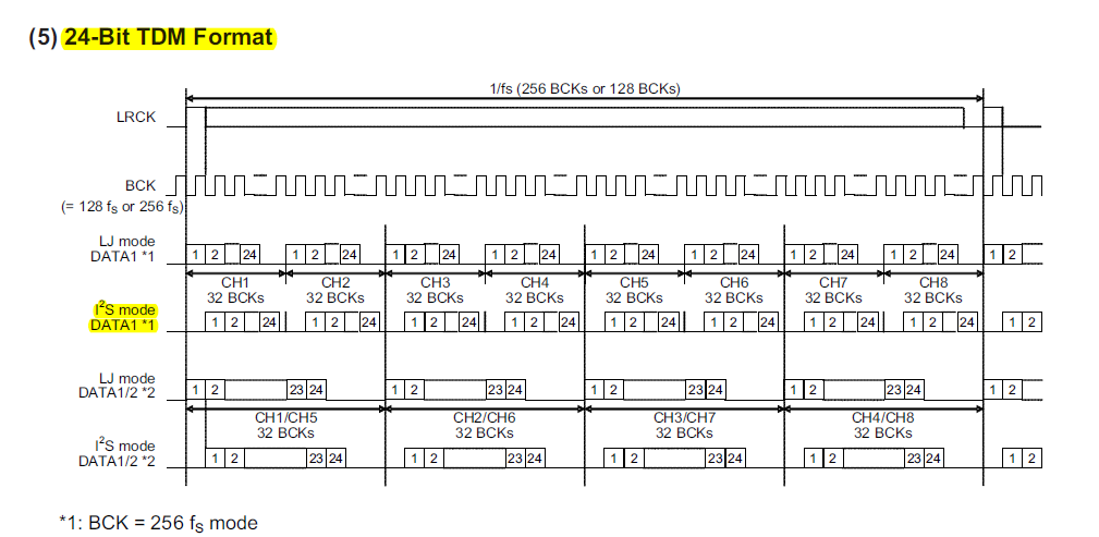

Is TDM a free protocol?

Hi Ian,
are you also developing a USB2I2S in addition to multichannel isolator re-clocker? Also isnt TDM just time domain multiplexed channels?
Yes, TDM is just a general term for everything from SONET to ISDN - all too familiar to anyone in telecommunications. For audio you have stuff like ADAT (originally developed by Alesis) that does 8 channels of 24/48 using toslink cables, and MADI (AES10) that does up to 64 channels and 96 kHz.

TDM audio interface
TDM has a least two meanings - a general one as a multiplexing method and a specific one as an interface in audio communication to multi channel ADC/DACs.
TDM as audio interface is similar to I2S interface and can be considered as a superset providing more audio channels typically 8 over the wire. I2S can be considered as a subset of TDM providing only 2 channels.

I'm not an expert, but I assume that TDM audio interface is as free as I2S interface.

Hi xaled
Thanks for those very organized information.
Please see the timing I attached. Is the 24bit TDM format over I2S correct?

Hi Ian,
as with PCM signals there are variations in TDM over I2S format that can be seen in the DAC datasheets I attached in previous post.
There could be 16, 24 (18, 20) bits, right/left justified format etc. Basically the same story as with I2S2PCM board.
Maybe you could ask diyers what multi channel DACs with TDM support they have and focus on that TDM variations.
Or maybe you can just reuse the I2S2PCM format conversation options and have the TDM formats be selectable with jumpers.
Who has developed it (or defined the standard)? Any pointers to specifications?
It is my understanding that TDM as an audio interface isn't a specific standard, and there are lots of varying implementations.
TDM is basically the same story as PCM interface. There are multiple variation from different ADC/DAC vendors around the same scheme. To cover most of them something like the I2S2PCM board options would be needed.
Not really. AES3 (AES/EBU) is pretty well standardized (albeit with a few different transmission media - balanced, unbalanced and optical). I2S parameters are pretty well specified too, and so is USB audio. TDM is another story - not only is there not a standard for the electrical connection, but the number of channels, data rates and a bunch of other parameters vary.
And yes, TDM is a form of PCM too, of course.

Thanks xaled,
Which TDM format are your going to use? Which TDM device are you considering for your future project?
Ian
To be strict, PCM is a audio coding scheme while TDM is a transmission technology to pass more than one logical channel over one and the same line. A TDM channel might contain PCM coded information... or not.

I think Ian asked for a format, rather than specific hardware. The Beaglebone is just a single-board computer, not a TDM source as such. The diyinhk is a USB-to-I2S interface, not a TDM interface.

What I want to know was which device that can have real TDM output, I think xaled's answer already very help
Maybe I still want to know how to setup to get the real TDM output. If I have a real device to test as a reference, it would be great help to my FPGA design.
