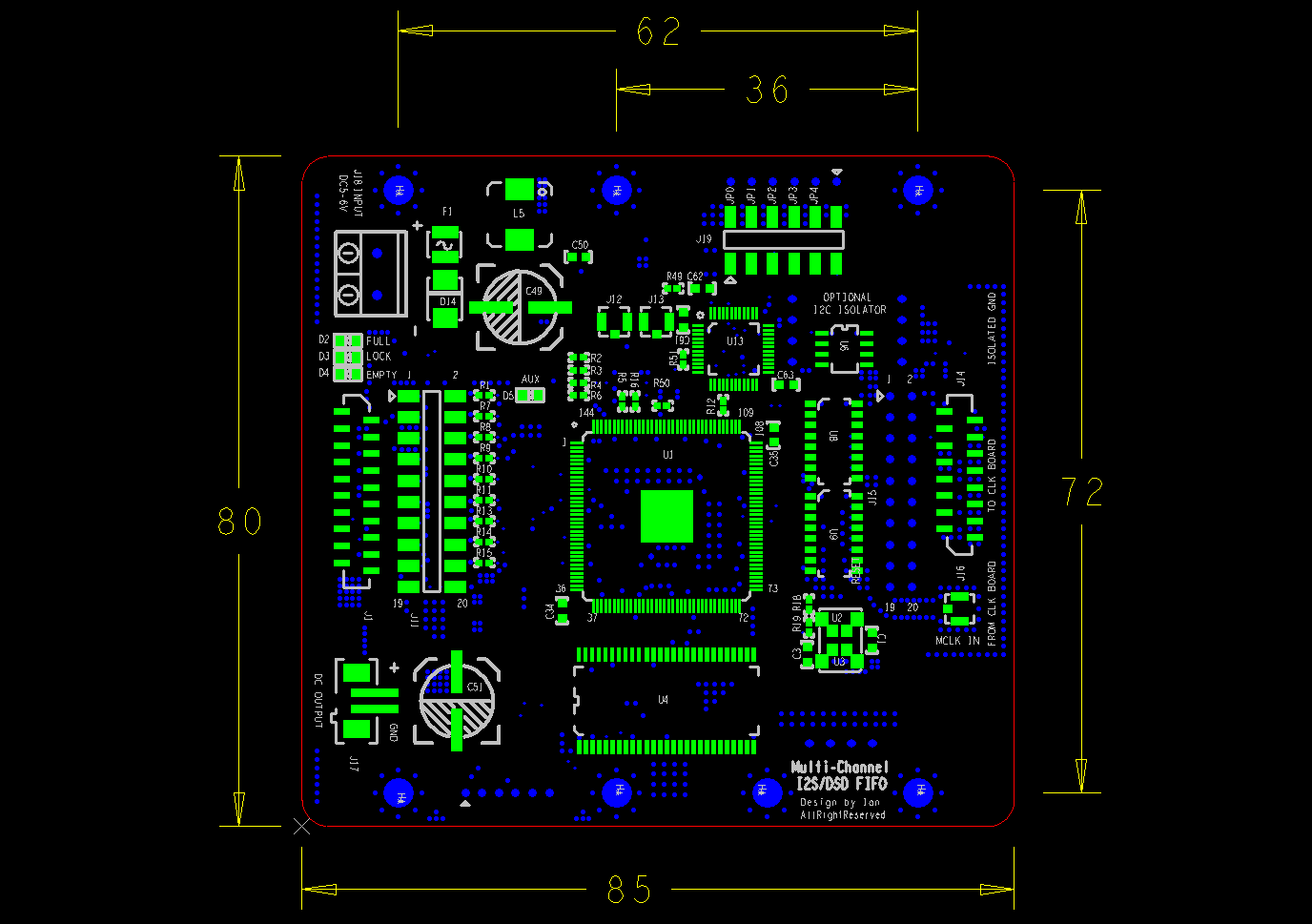

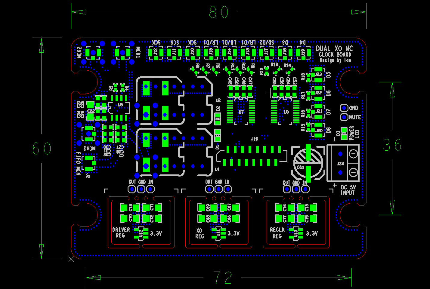

Dimensions of multi-channel I2S/DSD FIFO (prototype)
I got prototype PCB weeks ago. It was tested and now it's functional.
Ian

I'll do more application test to finalize the software. If everything is good, I'll take the MC FIFO GB into consideration.
Good weekend.
Ian
