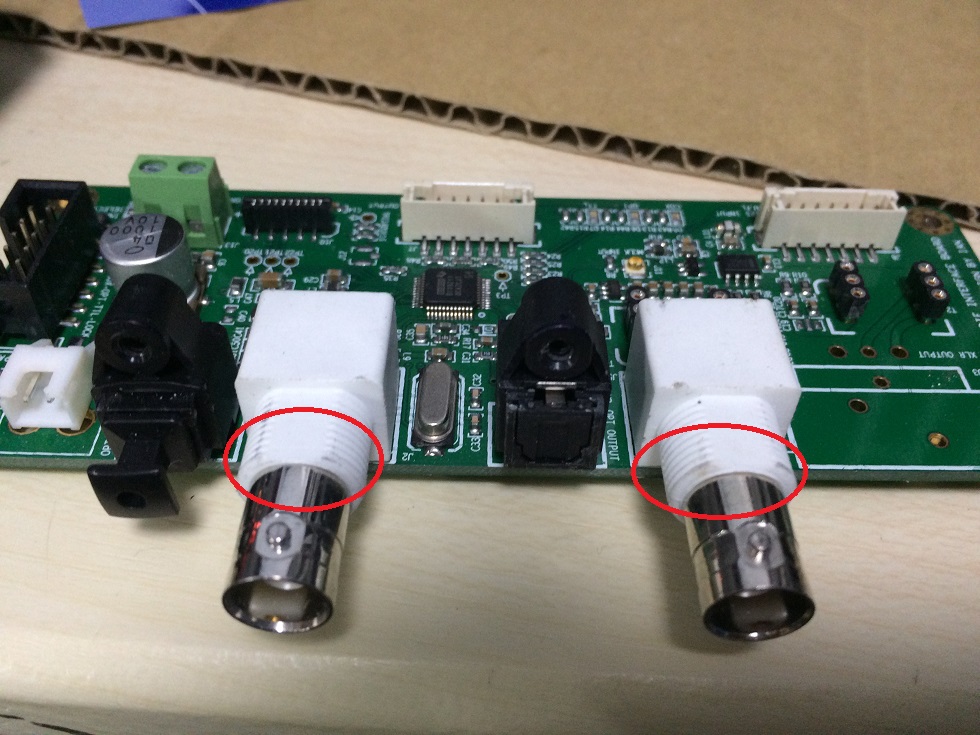

Hi Ian,
I am building the fifo reclocker and I found that there is no nuts included for the two BNC sockets. I measured it and found it is about 12mm diameter but I can't fit my 12mm diameter nut into it. Can you tell me what's the specification for those nuts? Thanks
There is nothing special about these nuts. I took the nuts off from my old BNC connectors, and they just fit in.
That's true for most of us, I'm afraidThere is nothing special about these nuts.

BNC Nuts
Kenneth,
I believe the nuts are 1/2-28, which is an imperial fastener. Mouser p/n 523-31-5652. It is my suggestion, however, not to use a nut on the BNCs unless you are very careful with the mounting of the board itself. Using a nut on the BNC could have the tendency to torque the connector and stress the soldered pins unless the BNC, the board, and the panel are nearly perfectly aligned. If you just connect a cable to the BNC once (or twice, i.e., not every day), there is not a need to fasten the BNC to the panel.
George
Kenneth,
George
Thanks. I bought the nuts required.
Also thanks George for your tips.
