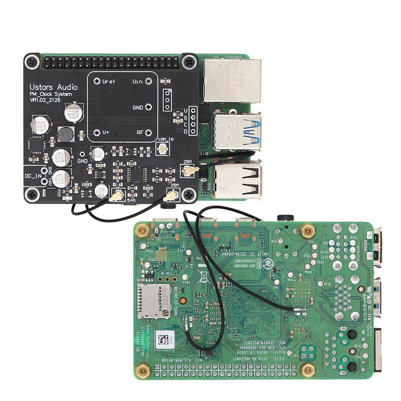

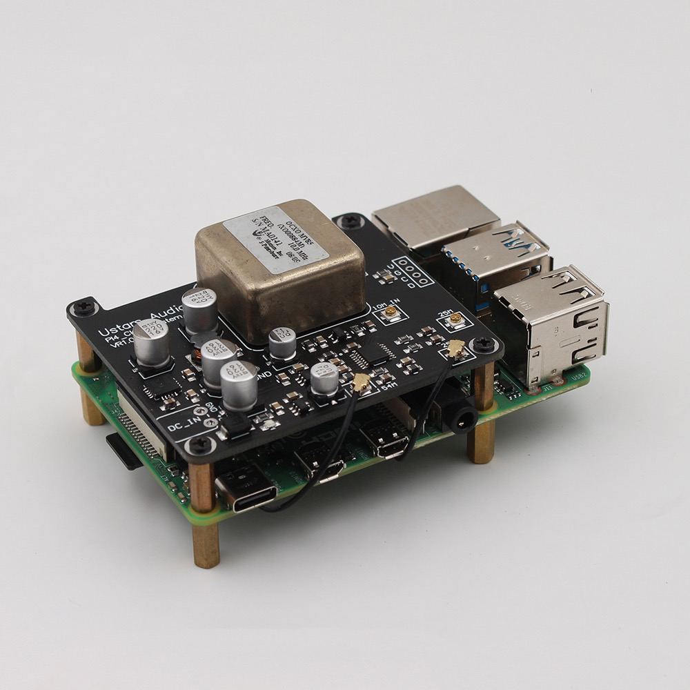

There is another alternative way, tweak raspberry pi with the clocks.
like here
![1684768426372.jpeg 1684768426372.jpeg](https://www.diyaudio.com/community/data/attachments/1084/1084504-1625e8aeaa0727b64221cd774cf641d3.jpg)
![1684768456411.jpeg 1684768456411.jpeg](https://www.diyaudio.com/community/data/attachments/1084/1084505-28eea14f9aaca14eafe3100bd8355d0c.jpg)
@Batenetalecm,I wonder how much jitter a PLL multiplier like that add,The power supply must be of very good quality also.Can of course use externaly clock,like Symmetricon Sattelite clock with antenna and lowpassfilter before input card for even better sound perhaps.
It seems to me that there are some common misconceptions about jitter values. Yes, there is a certain amount of jitter in the PLL, but in my experience, this is incomparable with the advantage that the OCXO clock gives.
I know about some experiments with raspberryPI and replacing the clocks always gave a positive effect in the case of a good clock.
And yes, power supply of clocks is always a very special theme. There are some specific moments that play there.
for example, the battery-based power supply is always very good for clocks and so on.

This clock board can only output 10MHz clock signal, but it can provide 25MHz and 54MHz clock signal. We know in theory that there will be no good results.I used. it's definitely better than the standard Raspberry 3 and 4.
everything works perfectly. but it does not fit into a standard case, you need to remove the board.
like here

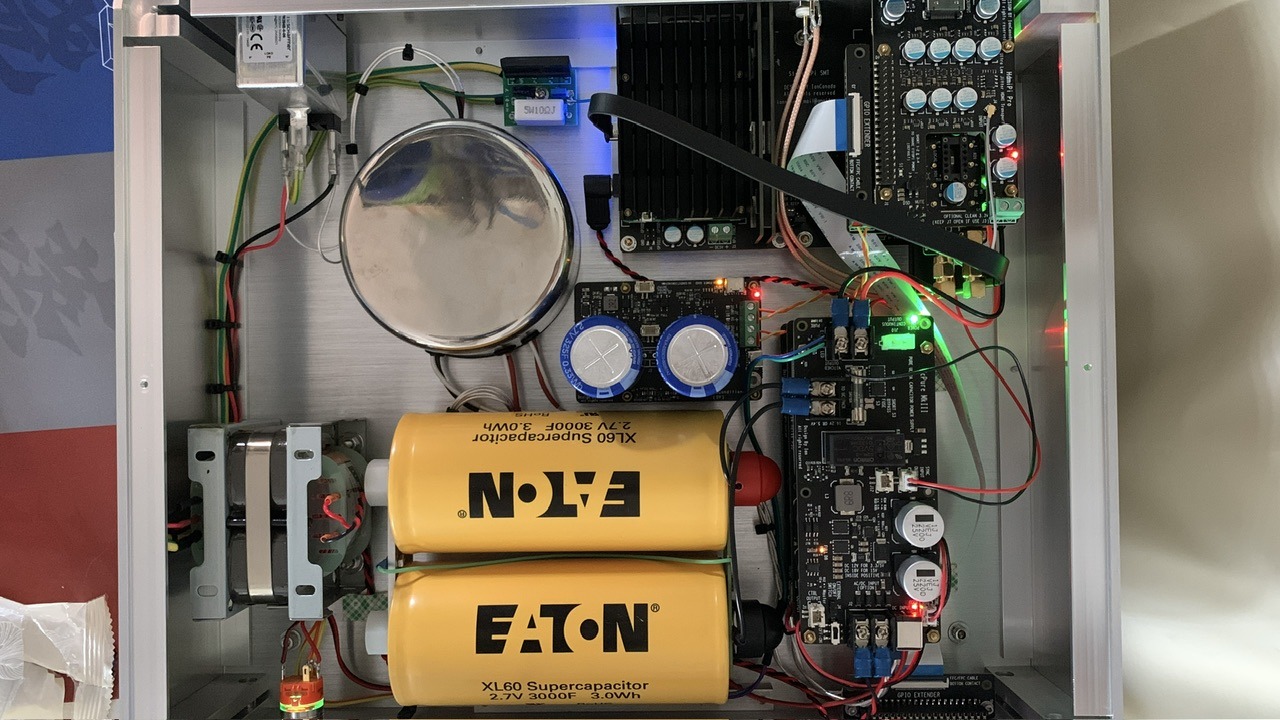

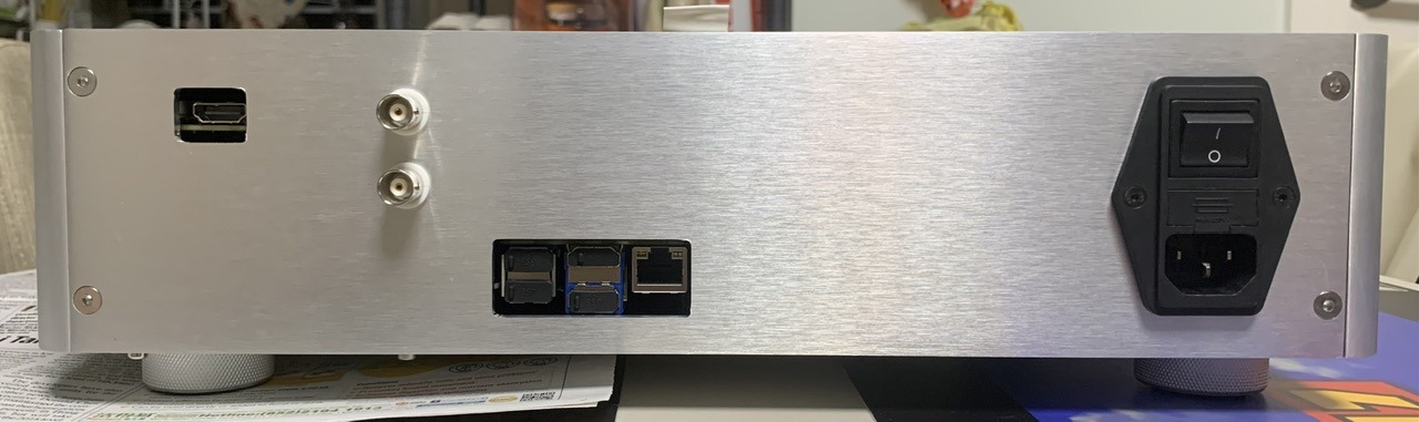

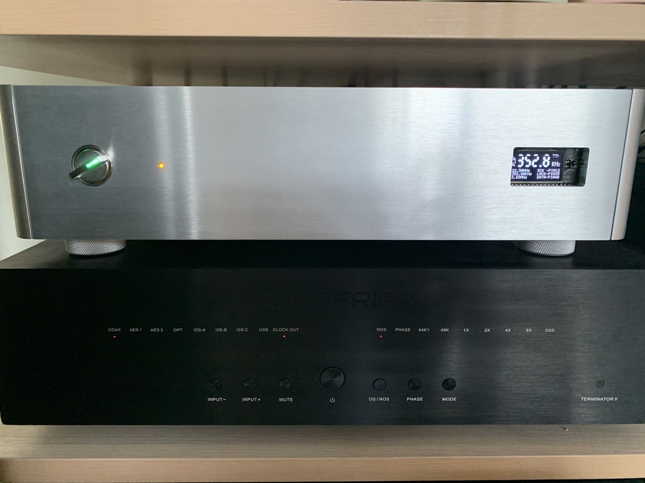

Hoi,Net klaar met de audiofiele HQP NAA, klinkt waanzinnig goed! View attachment 1178144
Which parts do you supply with the mcpure/ Eaton?? The clocks, IV converter ??
Thanks Ian@casshan
Your project looks great. The UcPure MkIII with 3000F ultracapacitors is the best ultra-low noise power supply in the real world. So good sound quality is expected.
I like the case. Is it customized?
Nice weekend.
Ian
Yes, the front panel and rear panel was customised
It provides 3.3v to FifoPi Q7 and HDMIPi ProHoi,
Just finished the audiophile HQP NAA, sound amazingly good!
Beautiful project and great layout nice to see complete projects.
which clocks are you using ?
