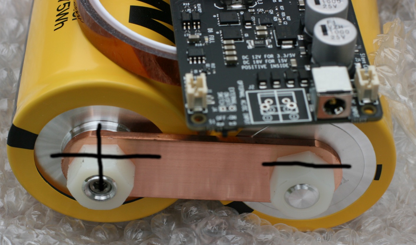

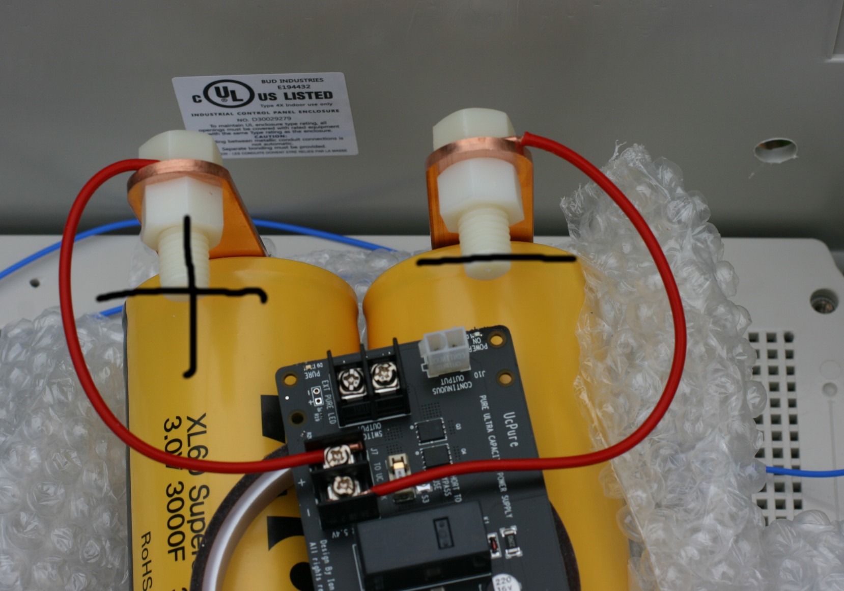

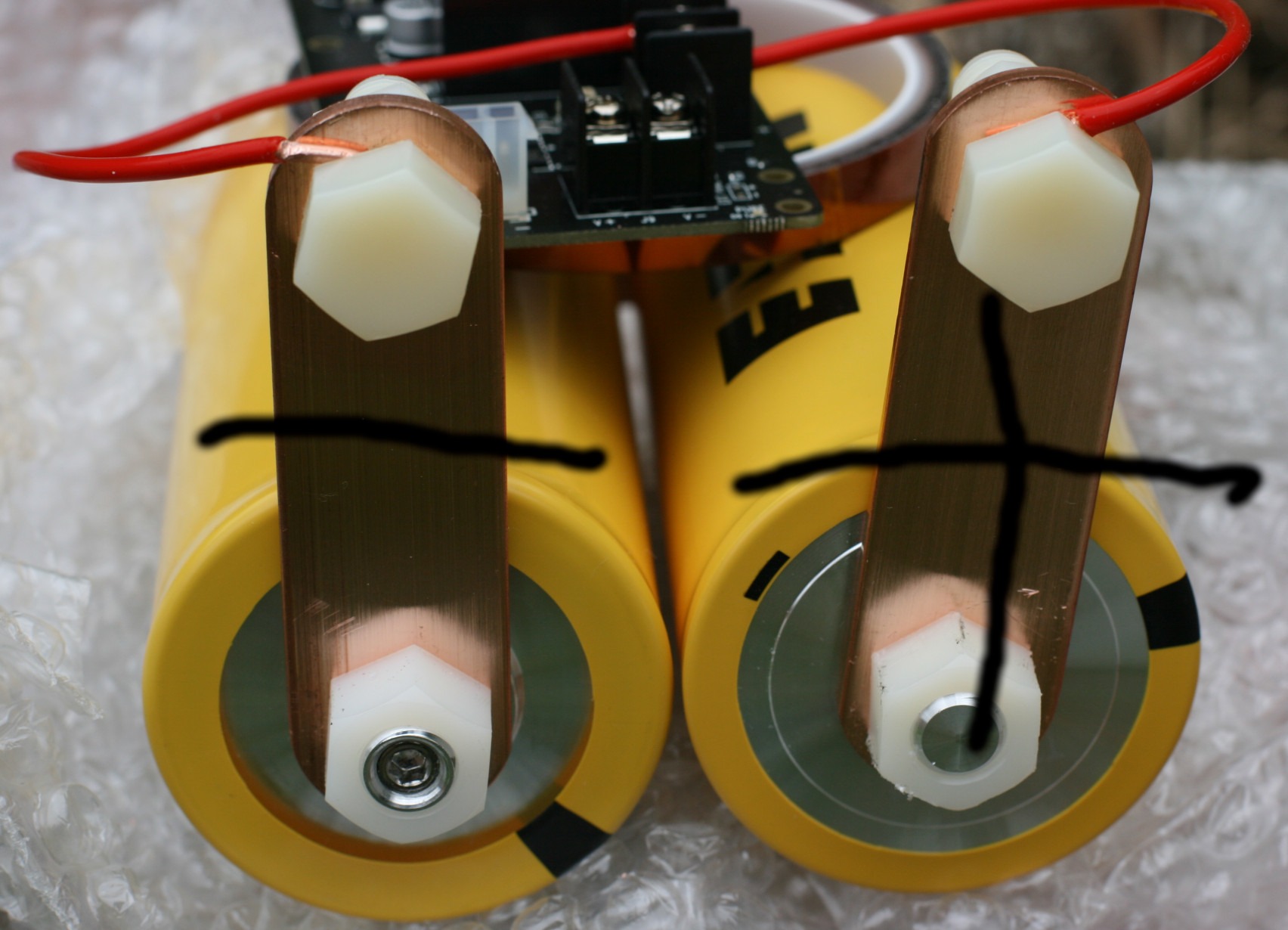

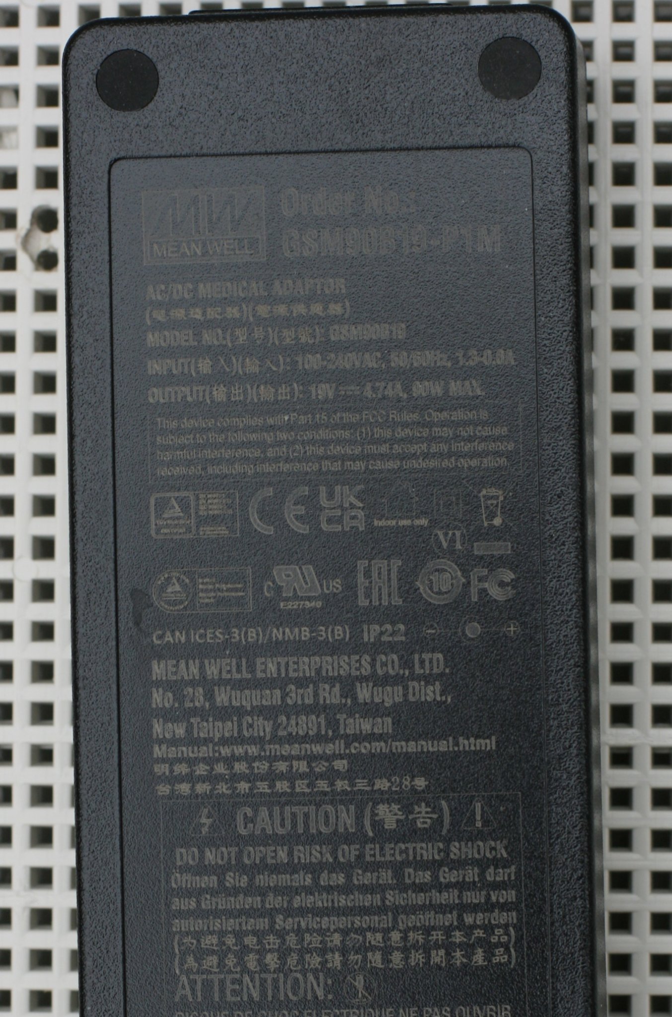

- Attach bussbar on -+ to Series Eaton 3000F.
- + - needed on other side, so they each have their individual bussbar.
- Attach - bussbar to - J7 with 18G Solid Core Cooper.
- Attach + bussbar to + J7 with 18G Solid Core Cooper.
- Confirm with community it's good to go.
- Plug in with Medical Grade Mean Well 19V SMPS.
For those whom went through the UcPure experience, when you have time to go through Steps 1-6 please let me know if that looks fine.
This is purely for 3.3V so no balancer board at this time.
I'll plug into the wall outlet to pre-charge once I have enough confidence sample sizes. Cheers.

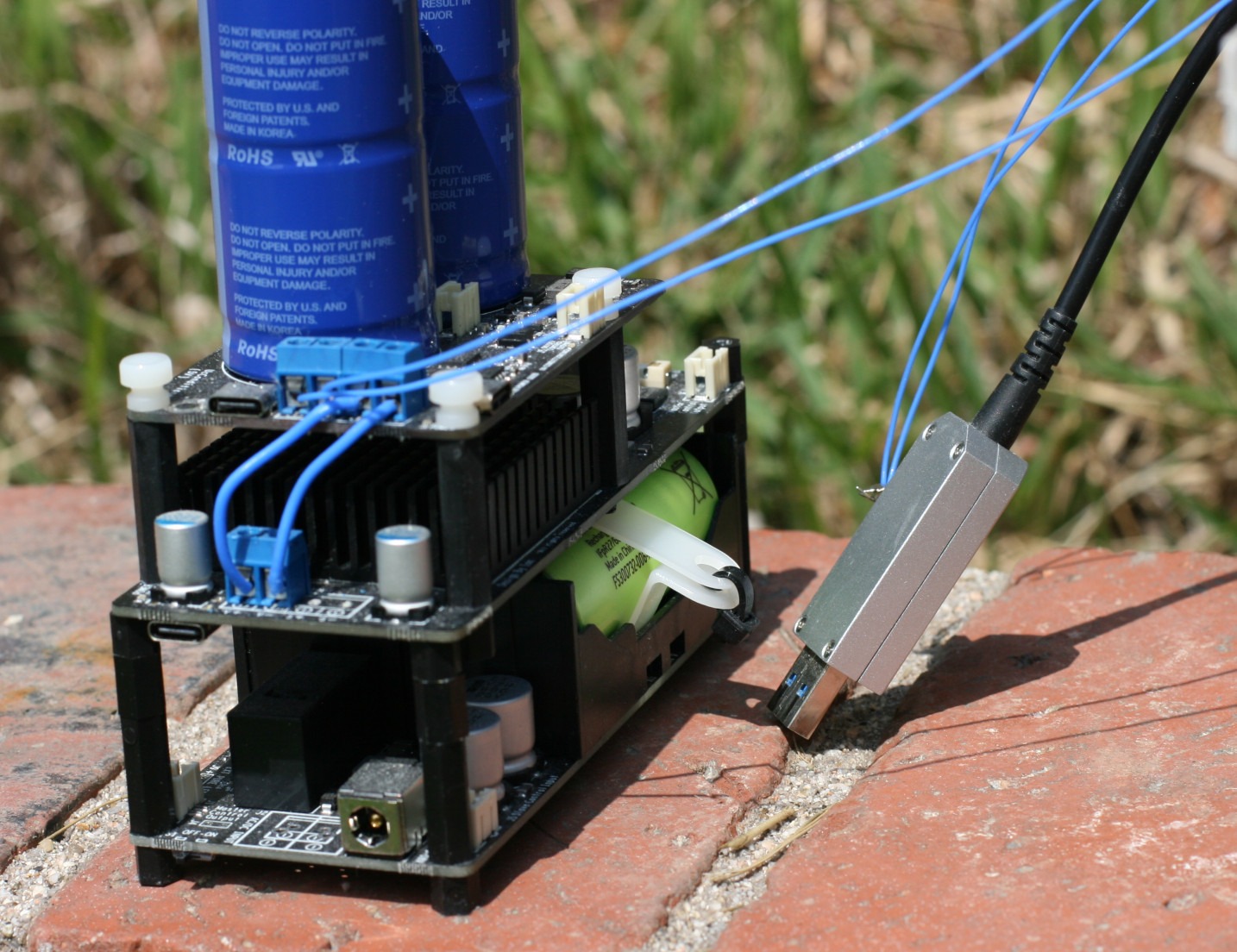

Right now I'm using the LiFePO4 6.6V -> LinearPi 5V -> UcConditioner 5V for my Monoprice USB Optical Cable. For the Solid Core wiring, I went too thin and hoping to go 20G-24G soon. This is for Gaming, not Music. I game on a low latency realtime kernel OS but for Music I prefer pure 16-bit Redbook that only Ian's gear + RPi GPIO can provide most optimally. I would hate if that 32-bit USB conversion would have to ever take place on the Music side. I also run low latency realtime on the Raspberry Pi so optimal on both RPi and PC. Both also load the OS entirely in RAM, so if I launch a game it's completely loading and running in RAM.
Custom kernel linux-raspberry4-rt 6.1.15 LTO is pretty awesome with Ian's gear.

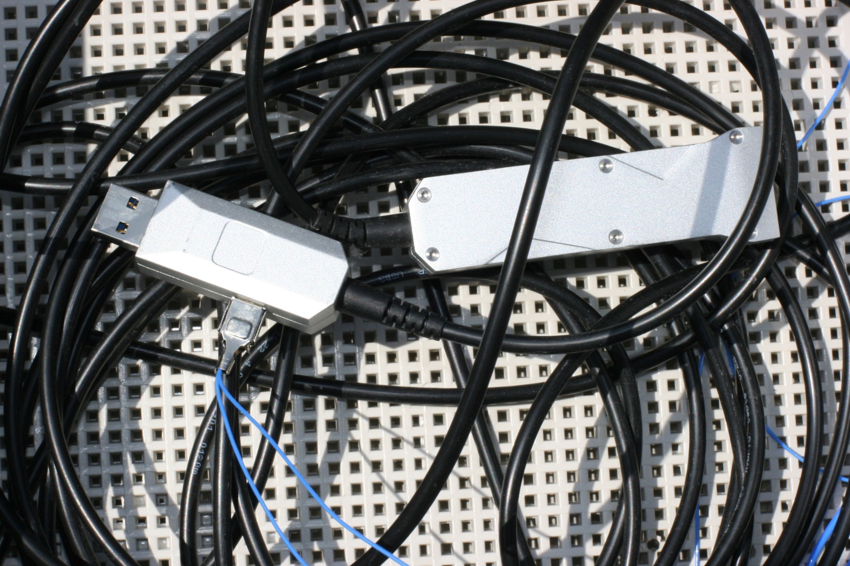

Since there has been talk of "Sharing", I'm going to try to share powering the RPi and Monoprice USB Optical Cable at the same time with LiFePO4 6.6V -> LinearPi 5V -> UcConditioner 5V. I hope no major road bumps with UcPure 3.3V.
I believe I use a Medical Grade 12V Mean Well to power this chain. Everything else I use Medical Grade 19V Mean Well.
![ian.jpg ian.jpg](https://www.diyaudio.com/community/data/attachments/1088/1088973-75d46263f9305ad370faac998419a1d1.jpg)
![optical.jpg optical.jpg](https://www.diyaudio.com/community/data/attachments/1088/1088974-50fe5b9c944bc054ea17dd41f1f495ef.jpg)

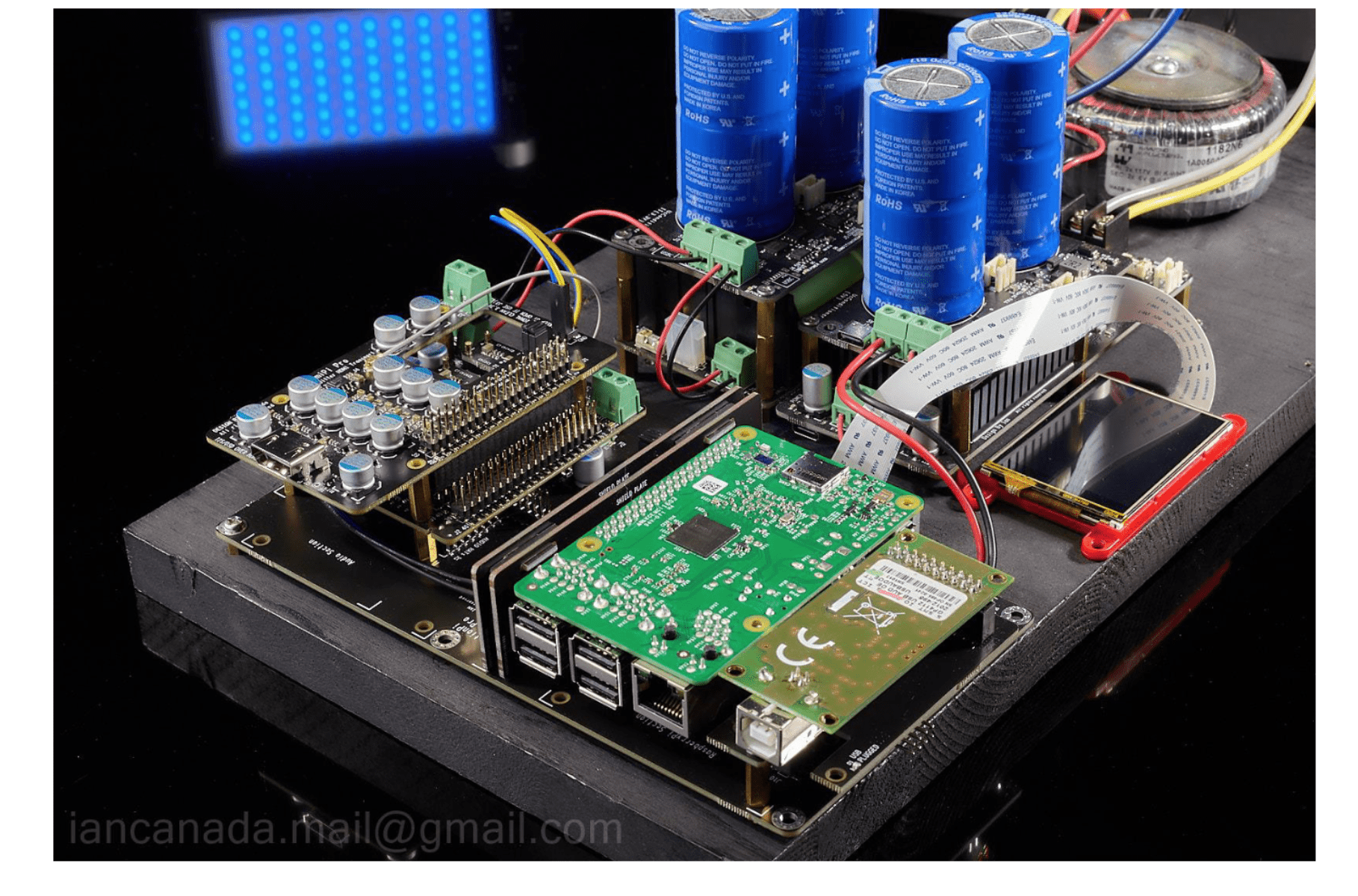

UcBalancer is a special designed protection board to integrate ultracapacitors better with UcPure or other power supply.
With a full set of UcBalancer KIT, it makes things much easier to build top level power supplies for clocks, streamers or DACs.
