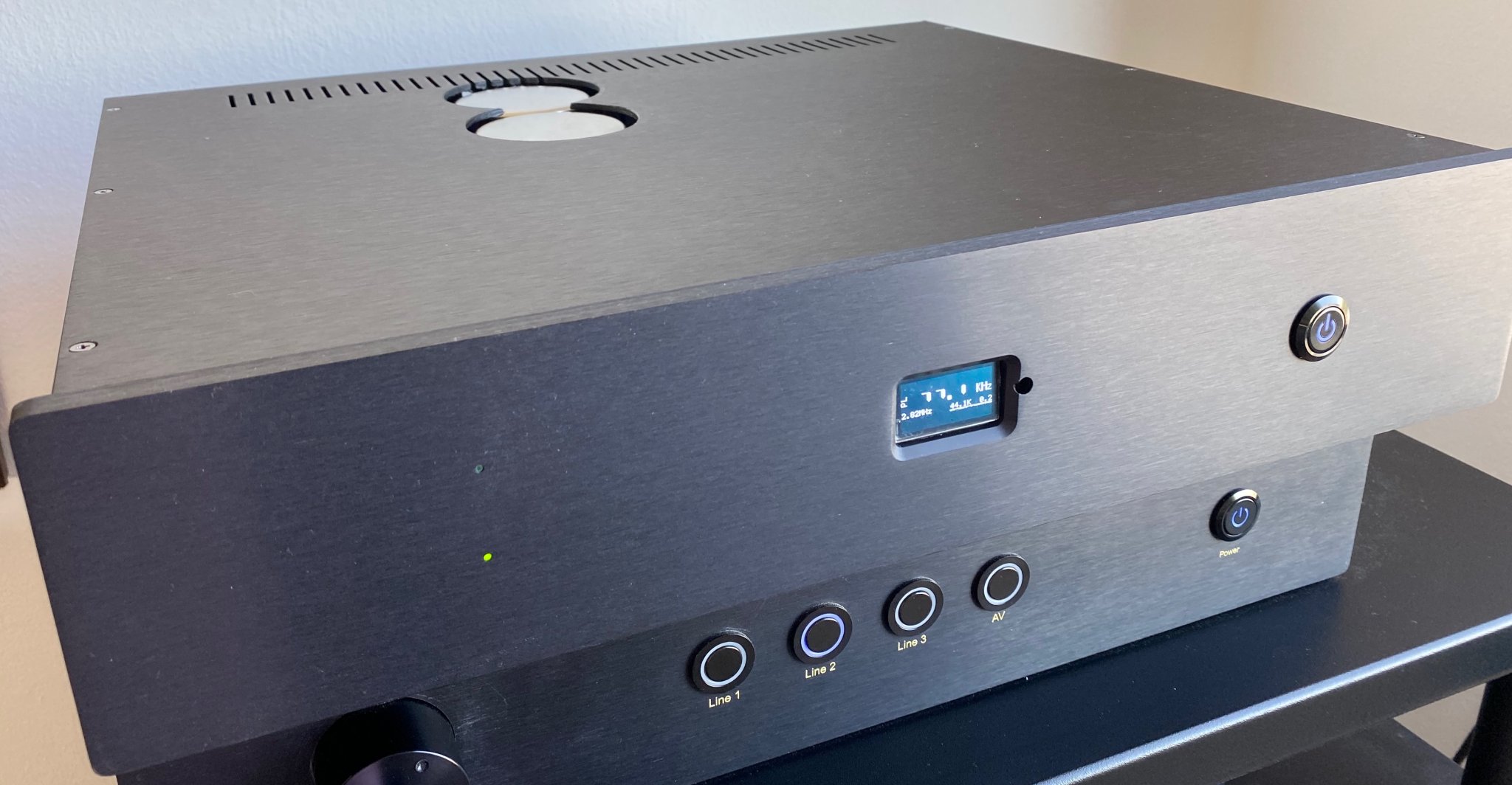

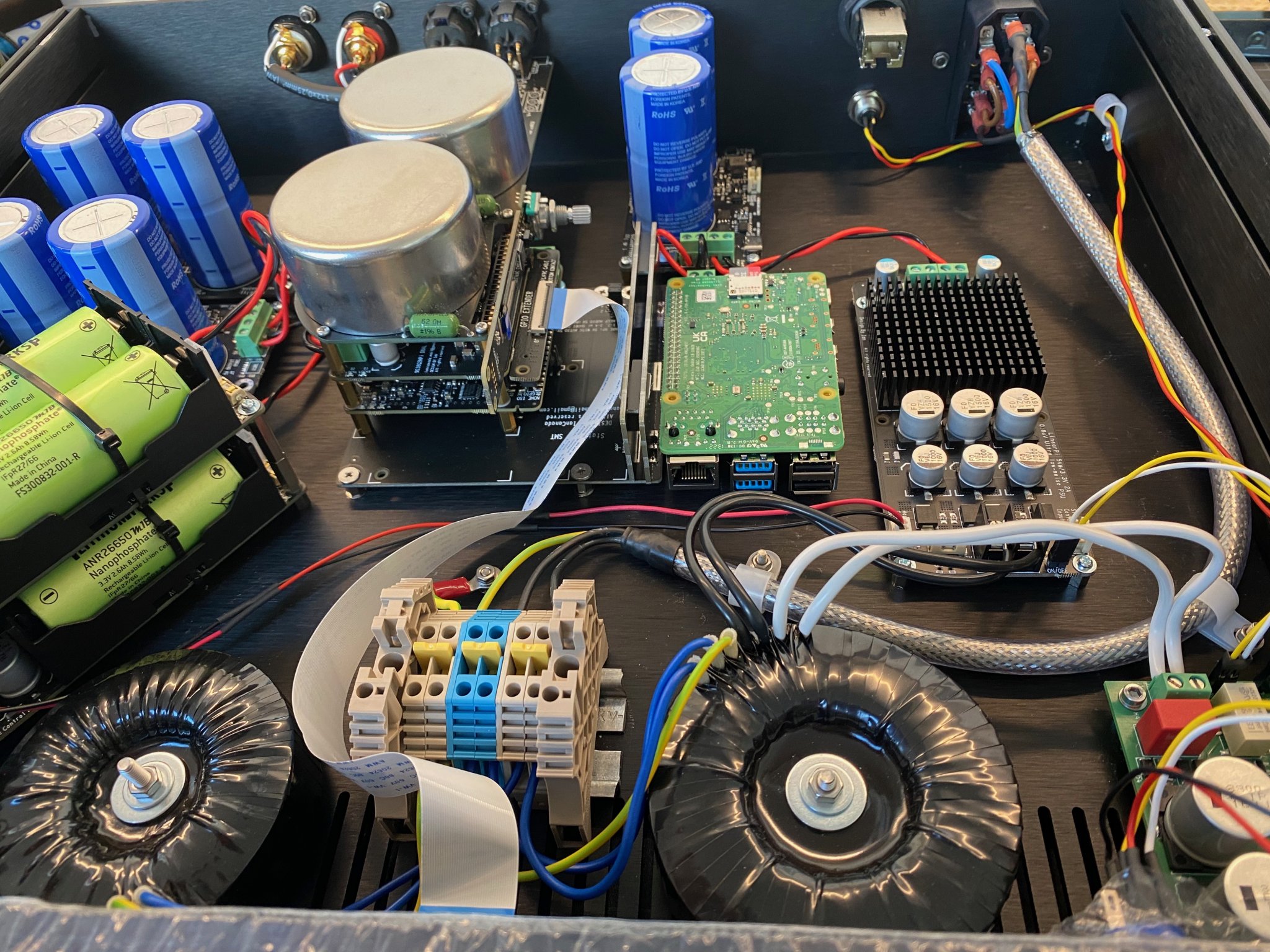

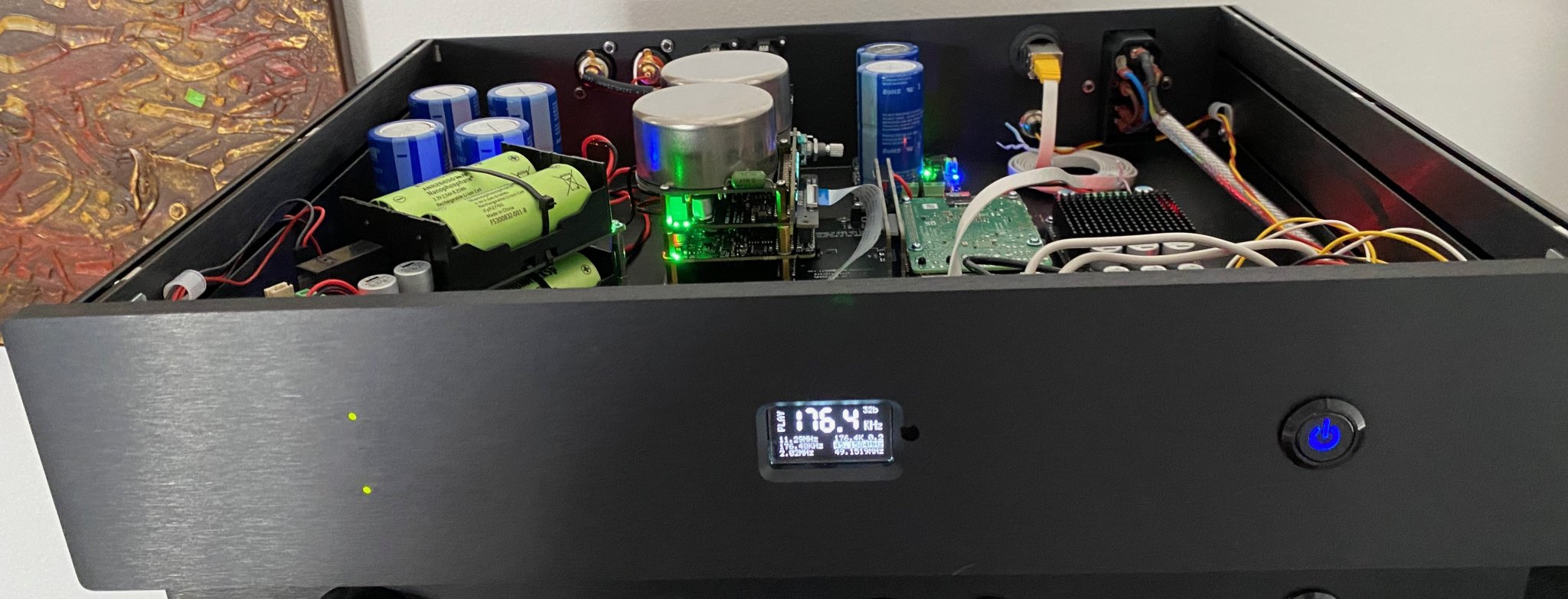

I finally scored a RPi and was able to complete this phase of my build. Thanks to Gabster for the inspiration, redjr for some tips and tricks (and inspiration) and of course to Ian for the great engineered boards and know how sharing. Now it is time to listen and fine tune. Attached some pics.
BTW: As you can see, I am using Ivan's large I/V transforms and the stack is about 1 mm above the internal height of the case. This was a design decision I (had to make) made from the start as I did not want to go with a higher case that would not fit my rack. Looks odd but came out OK.

Looks good @MartinJohn Odd looking can be okay in the DIY realm.
As long it works right and the sound is to your liking. Unlike a lot of other audio hardware, DACs and streamers are made to be tweaked - especially Ian's suite of products. He's opened a whole new world, or customization and innovation. From RPis to pure battery operation to clocks, and every conceivable I/O shield to quiet PSUs. Good stuff.

@MartinJohn,
Looks very nice your setup. Raising the output transformers to mimic a tube amp would also be nice.
What case did you use?

That is a beautiful looking setup, glad I sparked some inspiration.I finally scored a RPi and was able to complete this phase of my build. Thanks to Gabster for the inspiration, redjr for some tips and tricks (and inspiration) and of course to Ian for the great engineered boards and know how sharing. Now it is time to listen and fine tune. Attached some pics.
Feels amazing to build and finish your own Dac. Congrats and thank you for sharing.
