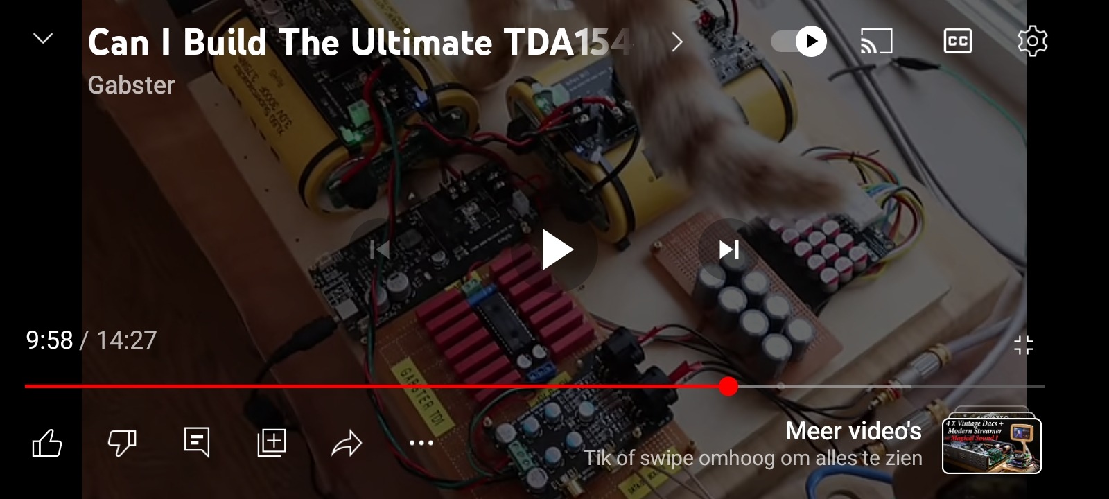

Gabsters cat walking across a bunch of ultracaps. The clocks should be powered on 24/7. I wonder how other members did organize their things. I already wrote months ago if your neighbours toddler enters your house with a metal toy, get attracted by the Canadian Christmas decorations ( like we do) and starts poking around. But people here don't realize what these caps can cause when short-circuited.

Gabster is also not using the transformer according to the datasheet. But it could be that the cat pulls some strings before it goes wrong. Cat have multiple lives they say.

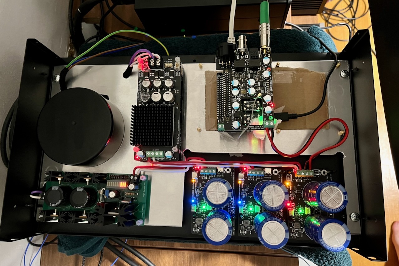

First test with all components connected! This is exciting! Thank you everyone for your help!
More pictures coming soon.
First impressions are positive but I know improvements are coming. Soundstage is already impressive. Will let you know.
Full report coming soon. 🎶🎵🎶
