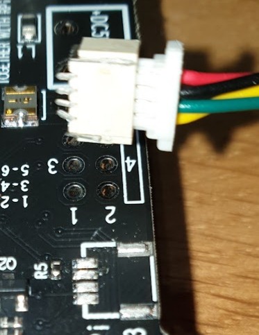

Hello,
A few weeks ago there was a member with a connector " coming off ' from the board. It looked liked a serious connector that once probably soldered could break the board in two. So maybe this one had some cold joints too?
If i am right a cold solderjoint should be desoldered cleaned and soldered again using fresh solder. Probably the connectors have rather big soldering spots so not to difficult.
What about the other parts are there no cold joints on these areas?
This is the only board with this issue?
Would be weird to have some boards in your stacks with barely good enough joints on some spots and spend a small fortune on clocks.
Greetings Eduard

Hello,
This happened to a member on another board.
I dont know if this connector has a kind of locking mechanism. Even if it doesnt it would be strange that the lock would be strong enough to pull the receiving part of the connector off the board. It looks like the pins are still there.
Could this be a cold solder joints as well. I mean there are six joints those would give a strong bond
.Greetings,Eduard
