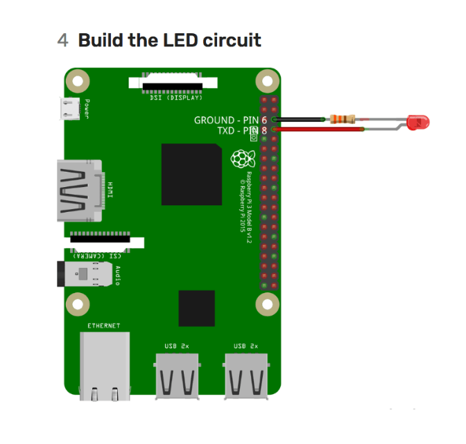

I used to manage the push on/off button with GPIO Button Volumio plugin. But I guess your solution is different. Would you share or tell where I can find a way ?
I only use the push button for safe shutdown of Raspberry Pi, for startup I use the trigger of the Ian PurePi Ultracapacitor power supply.
I also use the volumio gpio plugin (I use gpio 4 with a momentary push button) if you use gpio 3 I think you can start and shut down the Pi.
for just shutdown you could also place the below line in the boot/config.txt with a gpio pin of your choice or what is not in use.
dtoverlay=gpio-shutdown,gpio_pin=4,active_low=1,gpio_pull=up=gpio-shutdown
for the LED I use gpio 14 TXD with a resistor of 260 ohm, you also need to add the line enable_uart=1 to the boot/config.txt file so that the LED turns on and off when you use the power on/off button.

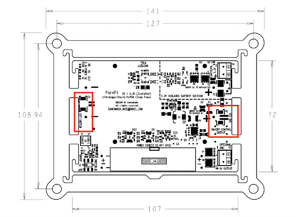

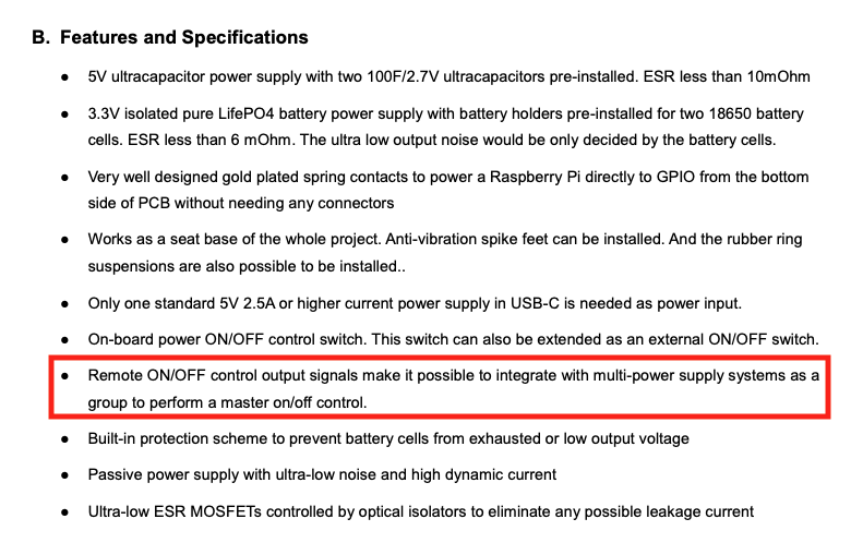

Hi @gizmo3 , so it's like I have done. Thx. I used GPIO 3 to start and stop. that's right. The ring LED is attached to the momentary button (GPIO17). Right now I use PurePi trigger too, during prototyping. But with the future enclosure, it will be not available. PupePi manual talks about external module, but I don't know where to find some (I haven't seen nothing like this on Ian's website). Any ideas ?
I use the external switch (j5) in combination with a relay.
When I turn on the main switch it is triggered by the relay.
you probably mean this on/off control j9, I don't use it myself, but I think I can also just use it as a trigger by means of a power supply, I don't know exactly how this works.

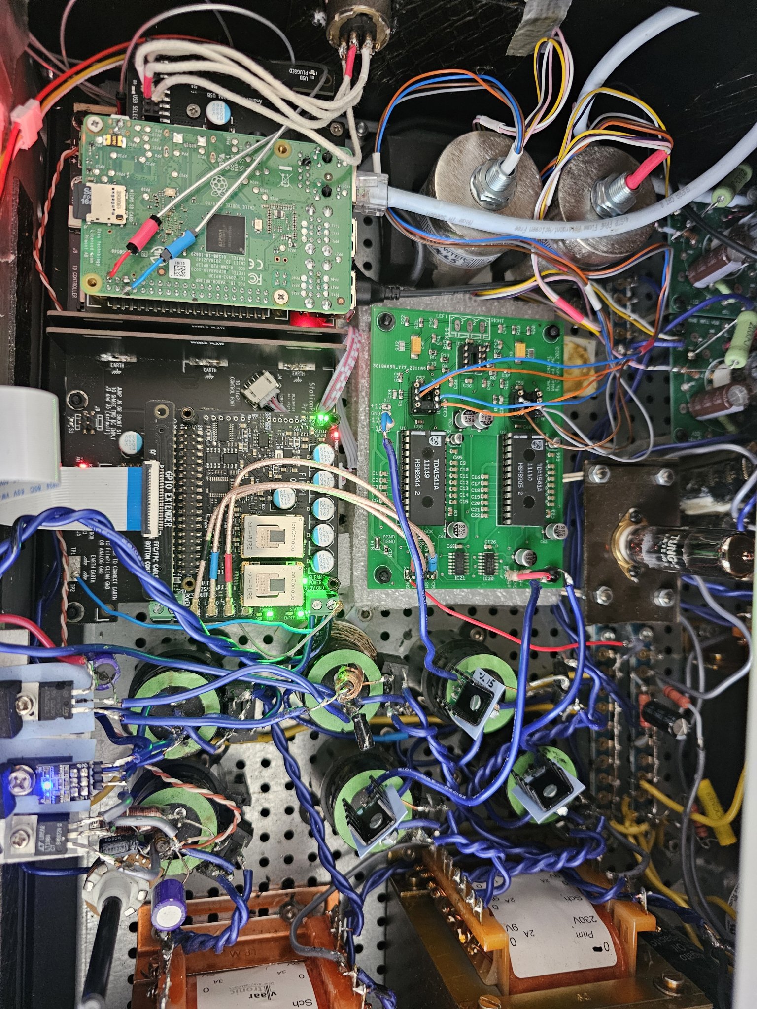

Also using 2 tda1541a in differential and Ian's stuff as well.
Reactions: 3 users
Can you tell me a little bit more (or if already posted somewhere, help to find) your setup? Particularly interested in the parts supplied by iancanada as well as the sample rates etc in which you run the tda’s.
The pcb where the dac sits seems to make use of some film caps for decoupling, which I like and usually don’t see. My home made board has decoupling caps under the tda chip.
@studiostevus
Using from Ian: stationpi pro, receiverpi pro II, fifoq7, Monitorpi Pro, raspi 3B+.
From fifoq7 i2s directly to tda1541a.
TDA's in NOS (of course). Incl 6K8 modification (- /-15v to pin 16and 17). DEM cap .470uF.
The pcb I bought with capacitors already installed.
Streaming to 96kHz which the tda1541 can handle.
Via Sowters 1465 to ecc88 tube sections.
All seperate power supplies and transformers per stage.
