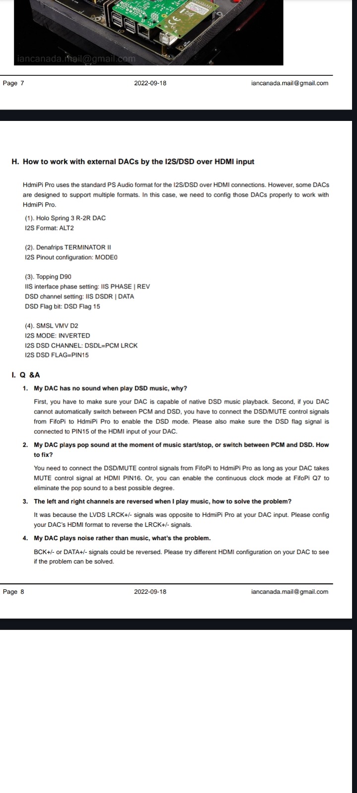

Hello @dcallende & @eduard
There is possibly some confusion here. It is only the HDMIPiPro II that allows the user to change the I2S pin-out - and indeed I believe Ian Canada has introduced the HDMIPiPro II precisely to enable users to alter the I2S pin-out to work satisfactorily with different DAC's (as I mentioned before, there is no industry standard for the I2S pin-out arrangement).
Hence, I am assuming that when @dcallende refers to the "4 switches" he is actually using a HDMIPiPro II and NOT the HDMIPiPro. If that is indeed the case, then @dcallende should refer to page 5 of the HDMIPiPro user manual since Ian has now provided details of how the I2S pin-out works on the ver2 of the board. Page 7 of the manual (as provided by @eduard) shows you what settings to use on the DAC's mentioned - not how to change the pin-out on the HDMIPiPro II board.
The original HDMIPiPro(1) does not allow the user to change the I2S pin-out. The fact that the R/L channels are switched with the Gustard R26 is NOT a fault with the HDMIPiPro(1) board - it reflects the fact that Ian built the HDMIPiPro(1) board to use the PS Audio I2S pin-out but Gustard chose not to use this on the I2S input of the R26. I'm sure that this channel switching can be resolved by using a custom-built HDMI cable but I just didn't need to. It is far easier (and cheaper!) to just switch the analogue outputs on the R26.

@BogdanS - switching of the R/L channels is also possible in software depending on what software is part of your replay chain. I use HQPlayer and this allows the R/L channels to be switched easily - I just prefer to keep the signal processing to a minimum and don't use this option.
I don't know if Roon allows switching of channels.

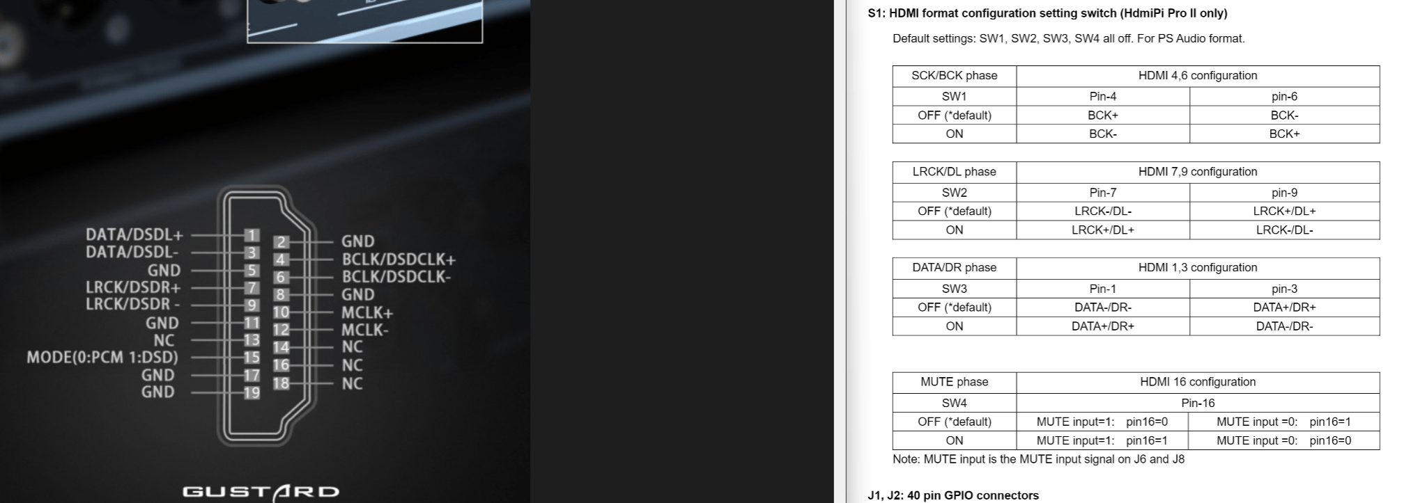

Hello @crossride
Working to get my HdmiPI working properly. I think I have figured out the right switch configuration for the Gustard R26:
SW1 OFF
SW2 ON
SW3 ON
SW4 OFF
My present journey is to figure out how to get what I think is a thin plastic cover off the 4 switches. Are you further along than I am? It has got to be something simple to get access to the switches. I have not tried using the HDMI interface yet. From what @sa3999 replied it looks like it will work without any changes to the switches, but the R&L channels are switched. I think turning on SW2 and SW3 corrects this issue.
Got Ian's goodies on Tuesday, Have been playing with them since then.
Yes your DIP switch configuration is correct. See picture attached, left side from R26 website, right side from HDMIPi Pro II manual.
I removed the plastic film from the switch block with sharp utility knife. Anything sharp or pointy enough (eg a needle) should do. Trashed the tiny piece of yellowish film.

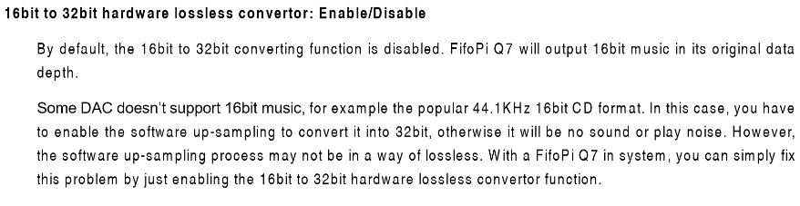

Had to read manuals of equipment involved. The answer is on Page 10 of FIFOPI Q7 manual, last paragraph. Enabled with help of MonitorPi Pro 16-to-32 bit lossless conversion. Since then, all the music I have thrown at it has been there. So it is not about the resolution but bit depth on R26 side.
My instant reflection is that I2S over HDMI vs anything from TransportPi AES to R26 gives you significantly better SQ.
Left/right channels I have correct, used several tests to verify.
