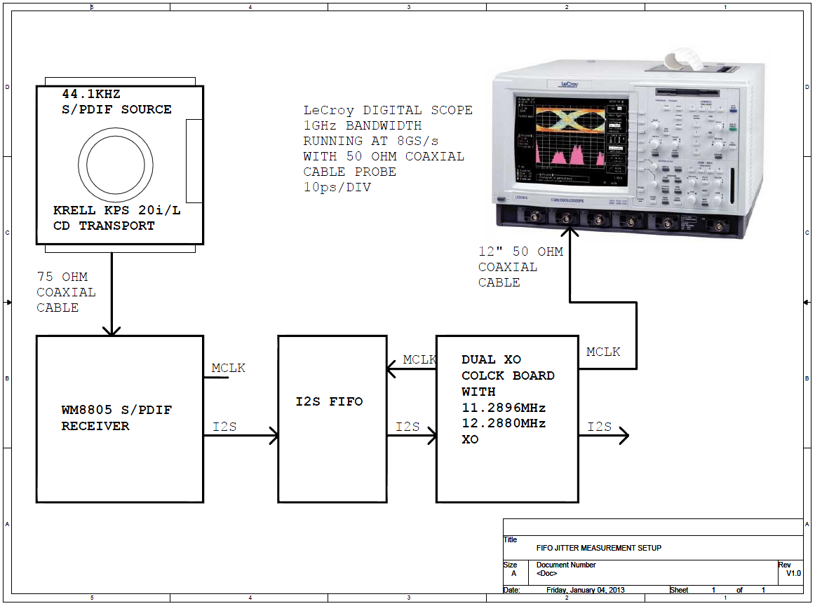

S/PDIF source: Krell KPS 20i/L CD transport 44.1KHz
S/PDIF connection: 3 feet 75 ohm coaxial cable
Test1: WM8805 output MCLK jitter
Testing setup:
Jitter display: 50ps/DIV
see the first picture for details

Test2: MCLK jitter after FIFO
Testing setup:
Feeding WM8805 I2S output into FIFO, and then measure the output MCLK of the asynchronized I2S stream.
Oscillators on the dual xo clock board: onboard generic 11.2896MHz XO
FIFO running at *256Fs
Jitter display: 10ps/DIV
Please see the third picture for details

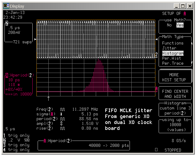

Testing result:
Period jitter RMS:5.13 ps
Period jitter peak-to-peak:+-18ps
Jitter distribution: Gaussian
frequency: 11.2897MHz
Please see the fourth screen shot picture for details
Some comment:
1. Please note, the jitter noise floor of my scope is 2ps, so the actual jitter numbers should be even smaller. Since it’s Gaussian jitter, we can roughly estimate the actual jitter from the RMS result. However to get more accuracy jitter testing result, or to test a really nice clock, we need better tools, I like LeCroy new 65GS/s scope, as well as Agilent E5052B phase noise analyzer, but I couldn’t afford those house price toys. However I don’t think we need them to get today’s testing conclusion, by comparing with the two testing result, it’s already telling the story.
2. Actually, my testing result on WM8805 is very close to the specification which was 50ps RMS. My result is even better, I think it was because I have a better S/PDIF source. However, the peak-to-peak jitter was poor, I don’t believe WM8805 can make any good DAC without help of other technology. Sorry about telling the truth, I know there are a lot of Wolfson users. Qusp is a talent, he predict the result a couple of days ago
. Yes, it “20x” better, of cause for CCHD957 or equivalent low jitter XO, at least.
3. Again, I’m neither from a certificated test lab, nor a testing engineer. Both my measurement setup and my equipment could be wrong. So, my testing result is just for reference. It doesn’t prove anything.

Ian, very nice Results!
Do you think you can do better than 5 ps RMS? Isn't the jitter dominated by the flip flop?
hes already done better than 5ps RMS, its 5ps RMS including the 2ps noise floor of his measurement rig and this is with only the generic test XO in place, not the crystek or si570.
As he said, he knew given the results and his measurement capability that measuring with the crystek would result in a number dominated by his noise floor, so he intentionally crippled the fifo to get a somewhat more meaningful result
so rather than the flipflop dominating, here its the noise floor and the generic XO that dominates the results, it would seem the fifo and buffer/flipflop itself has jitter hardly worth mentioning.

Hi Ian!
First you measures period jitter not phase, correct you post.
To measure with better accuracy and lower minimum jitter values with you lecroy osc (because of not perfect timing for interliving adc, amplitude-time distirtion conversion etc.) you need to
1. Apply ERES (3bit) function
2. Apply SinX interpolation before eres function if you sampling rate is lower than 4Gs
3. You signal must have maximim amplitude, just before clipping of ADC, use variable attenuator of you scope to maximize signal level.
4. Rise time of you signal should be 3-4ns for lowest osc jitter
regards, Nazar
