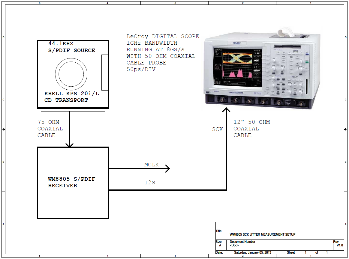

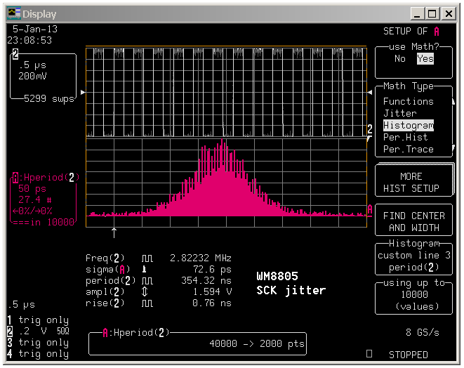

S/PDIF receiver SCK jitter measurement report:WM8805 vs. FIFO
Test3: WM8805 output SCK jitter

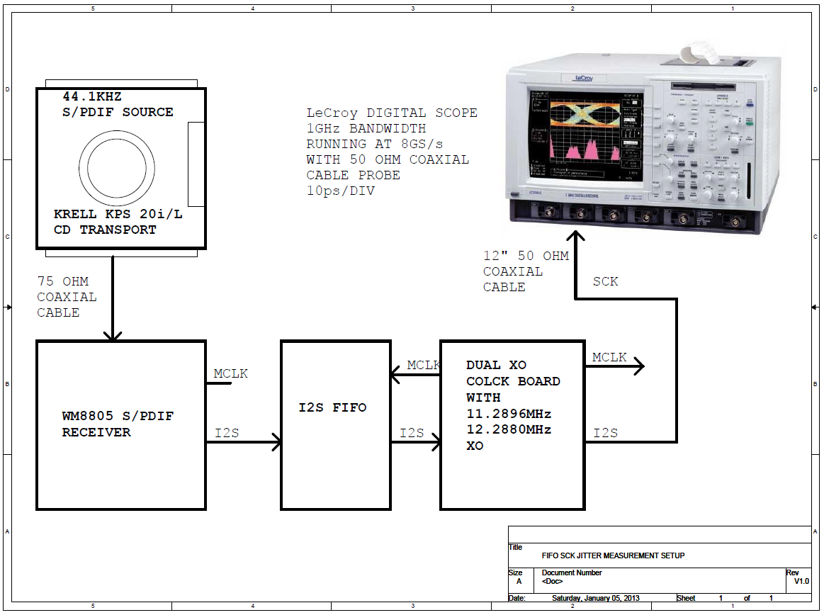

Testing setup:
Jitter display: 50ps/DIV
see the first picture for details
Testing result:
Period jitter RMS:72.6ps
Period jitter peak-to-peak:+-250ps
Jitter distribution: Gaussian
frequency: 2.82232MHz
Please see the second screen shot picture for details

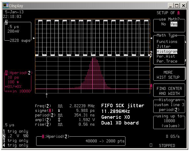

Test4: SCK jitter after FIFO
Testing setup:
Feeding WM8805 I2S output into FIFO, and then measure the output SCK of the asynchronized I2S stream.
Oscillators on the dual xo clock board: onboard generic 11.2896MHz XO
FIFO running at *256Fs
Jitter display: 10ps/DIV
Please see the third picture for details
Testing result:
Period jitter RMS:5.988 ps
Period jitter peak-to-peak:+-21ps
frequency: 2.82239MHz
Please see the fourth screen shot picture for details
