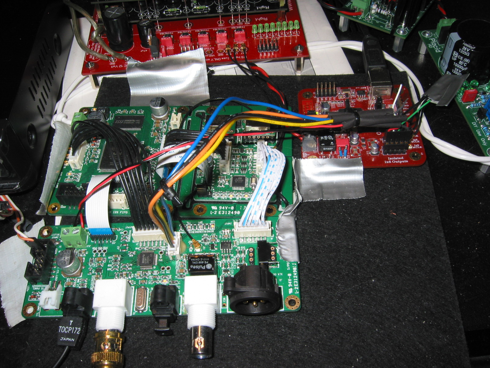

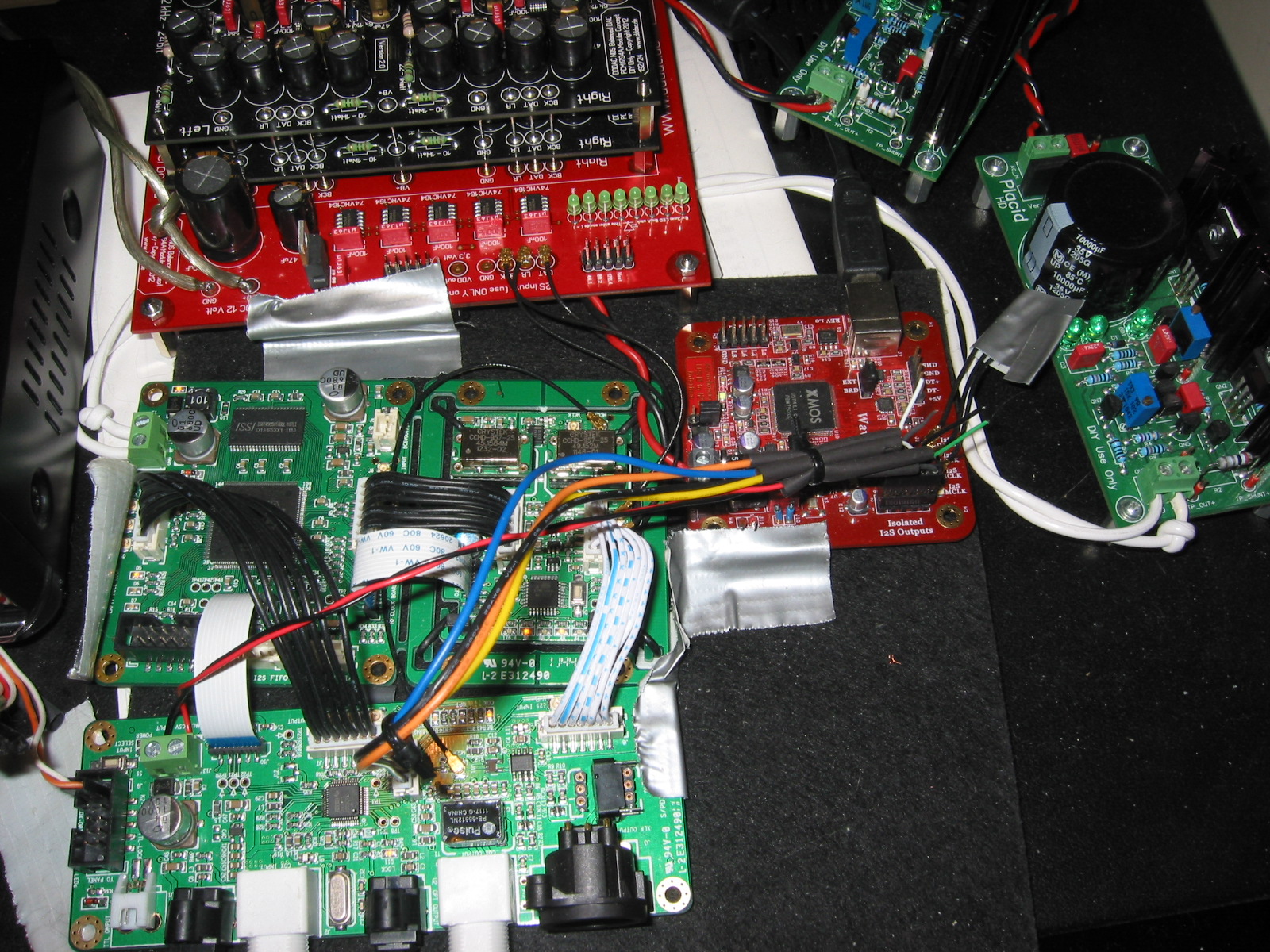

SPDIF board out?
Hi Ian,
About everything is working fine. What NOT for heavens sake than?
Its the Ians Fifo-Out! I get no signal whatever I try to record from its output.
I tried a lot of things that came up, but I ran out of ideas.
Te thought that has left, is maybe feeding the USB-card from
the I2S backdoor ?
I included some pictures.
Somebody can advise?

1, Connect J14 on the FIFO Board and J10 on the S/PDIF board with the 10 pin FFC/FPC cable, the connectors are double contacts, so the cable could be either faced up or faced down

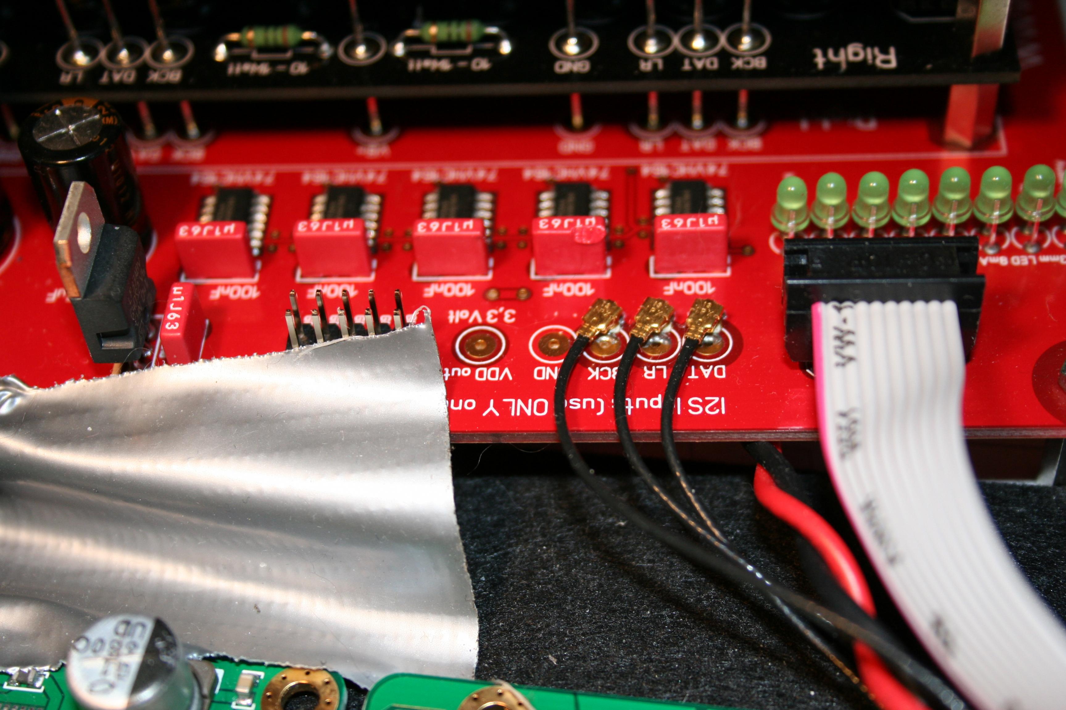

aside from your problem, you really should make some attempt to use the ground on the u.fl cables, as it is (not even using the single GND he provided on the dac, just one for all the connections to share is bad enough) they are aerials.. big time. as you have them there you would almost be better off just using ribbon cables.
like that the return currents from the i2s signals are having to find some way back through either a shared power supply ground, or perhaps a ground on that ribbon cable from the dac to waveIO and back through the i2s backdoor to the fifo, across the ribbon to the fifo and another ribbon to the clock board....
also the fifo input is being reclocked again by the onboard flip-flops on the dac board?
as for the problem, it could indeed be the backdoor interfering, I havent tried this combination, i'm not using the spdif out; but that wouldnt be beyond the realms of possibility. Can you test by disconnecting the waveIO and trying to loop through with one of the spdif inputs and spdif output, without the backdoor in place?

As for the grounding, I had the same remark from Doede, The grounding is done by each Ufl coax directly next to the signal connection.(just with the same Ufl connector) On first sight it is difficult to see, but the grounding really is okay.
I am thinking about the backdoor because of the resitor bridges I had to remove.
I love an output which makes me possible to do instant recording on my HD.
I will disconnect the WaveIO and make a loop. Let you know what happens. Unfortunately I did not try the outputs before the backdoormod! When I try recording I yust hear irregalar ticks, no sign of music signal.
And thank you TNT for your suggestion. I was shure I had the cable right but dit change it for safety sake for an other one. But no succes.
Thanks for the help so far, Ed
Hi Qusp,
Disconnected the WaveIO, fed toslink with a signal, looped coax in-and output.
Nada! Checked the boards for loose contacts/parts but Ian did a too good job on them.
Could not find irregularities of course.
Make myself a litlle but very aromatic Espresso! (That's about the only thing I am good at!)
Thanks for now,
Ed

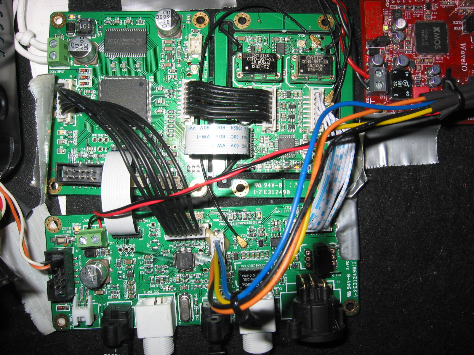

1, If you don't use the spdif output function for now, please disconnect the MCLK and I2S output cable to the spdif board.
2, Replace the dual xo clock board with the standard single clock board and play 44.1K, to see if everything is OK.
Good luck

Hi Ian,
Thanks for your advice of checking!
I can use all inputs, normaly spoken, with a terrific good SQ. So playing music does not give any problem. It is my missing of the possibility to record from the Fifo....
With the single board and 44.1 khz, using the WaveIO via backdoor, output sends rather continuous static, about max level.
These are the findings so far.
I must add, that the static ticks occur continuously at the (coax)output even when no input is connected to the SPIDF board , not even the backdoor!
Ed

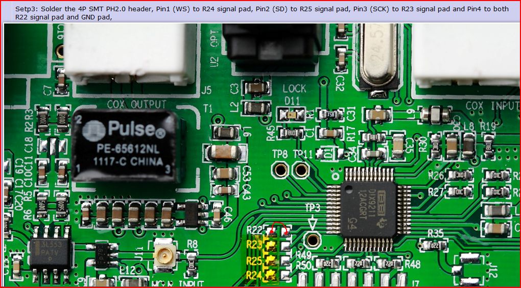

I had the same problem before, did you short one of the pin to ground (R24 if my memory correct)? this was the step I did not realize and caused no output.
Yes, this step was and is still not very clear to me to. I remember I questionned it it the forum.
What I did, I used a small piece of wire to short pin4 to the nearby groundplane, while connecting it to the signaltrack as well. I am though not shure I did the right thing here. Maybe I should try and cut that wire and see(hear) what happens.
Ed
Hi Ian/Bigpandahk
Not succesfull until now. I took the backdoor-connector from the board to check it. Found no problem and reconnected it. In the picture I show you how I did that. It is the manual from Ian himself. I show you how I bridged the ground- and the signalpads on the R22 position.
Ed:confused:
