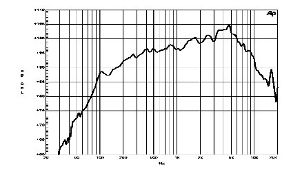

OK, I'm game, Magnetar. If the mid-horn mouth diameter is 12.5" and the throat is 3.65", what profile is the horn you're using with the B&C 6PEV13? Tractrix? LeCleac'h? Or are they all pretty similar when all is said and done? Inquiring minds would like to know. You've mentioned earlier that the low and high pass crossovers are at 350 Hz and 3 kHz, both 4th-order active. Any EQ within that range, or does the rising response pretty much compensate for the horn loading?
If a lower-slope lowpass filter was used, if the B&C data is right, then a 4.7 kHz notch filter looks like it would be a good idea. With a 4th-order crossover it probably wouldn't make difference, particularly if listening off-axis.
I'm guessing it would take a quartet of 6ND410's or Audax PR170M0's to match what the horn/waveguide/6PEV13 is doing.
