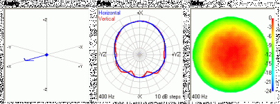

Re: Quick Question

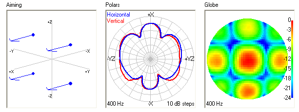

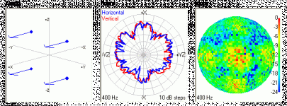

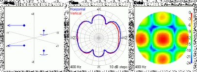

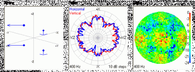

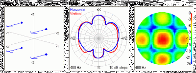

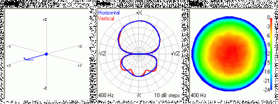

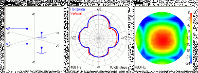

The sim confirms that an outwards bend increases the horizontal dispersion. Mic at 10 feet, 400Hz. Same thing happens @ 250Hz, Only the lobes are fatter. Best effect was with 45deg. Hey, that decreases baffle width substantially too.
See zero deg bend first.
Lynn Olson said:
Assuming we're going to use 4 12 or 15-inch drivers in a square configuration, how much of a bend would be desirable - 15 degrees maybe? More? Less?

john k... said:Salas,

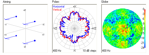

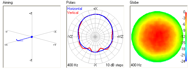

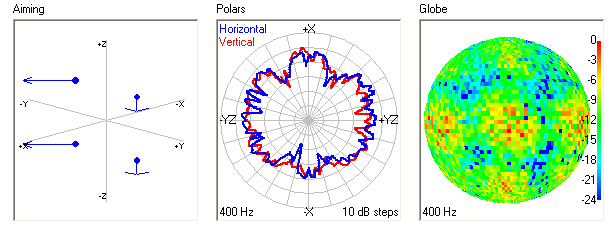

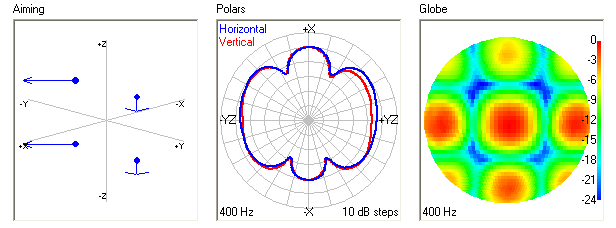

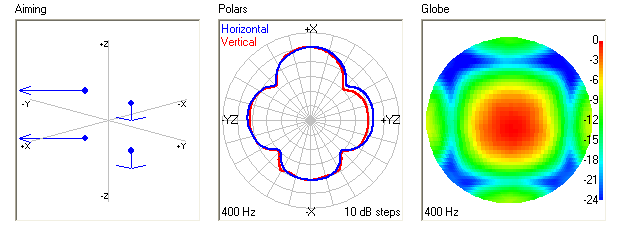

Aren't those simulation just 4 directional, monopole sources positioned differently? How do they relate to open baffle?
You are right. Forgot that. Can they still indicate a wider front if in dipole but with different lobe shape?
Joined 2003
Hi Salas,
I just don't think what you see with ArrayShow has any real relavance to OB systems since it doesn't consider the baffle. It is just looking at how arrays of the specified systems will sum.
What did you load as the device? What do you see when you change the device? The radiation pattern for each device is built into the device file.

Paul W said:Salas,
I believe you may have provided a link before, but what software are you using for your simulations? Somehow I managed to misplace it in a recent move.
Thanks,
Paul
You must go to EV site and get ''Arrayshow''.
