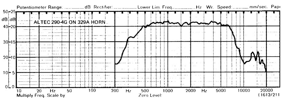

If the Altec/GPA 290/390 is this good, that certainly makes it promising.

Well, as part of research on the 290/390 I saw your many favorable posts about it over in the AA-HE zoo. You've owned and listened to both the 290 and the B&C cone, so I take your comments quite seriously. We may have different sets of subjective impressions, but you're certainly speaking of some of the same things I've heard directly for myself.
I've heard hints of greatness in A4-style systems, and I know there's something of value there. Never was a fan of the A7, 604 Duplex, JBL L100 or L200, but the big dog with the large-format multicell horn is another league altogether. I'm very curious just what a modern Tractrix or LeCleac'h horn can do with a large-format compression driver or a professional-grade cone midrange. Now that I've settled on a 3-way with crossovers in the 400~640 Hz and 3~5 kHz range, it comes down to selecting the right drivers, extensive measuring, and listening at length. JLH is out of the horn-building business, so I'll have to look elsewhere for the Tractrix or LeCleac'h confection to work with these drivers.
