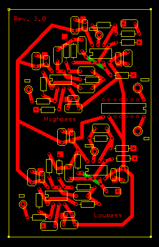

I've decided to use shelving LR4 active crossovers for my 400Hz Tractrix and 105dB 38cm woofer.
