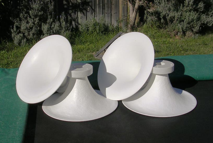

More AH-550 Information
Here's Martin's measurement of the frequency response of a JBL 2420 (aluminum diaphragm, 1" exit, no longer in production) mounted on a AH-550 with a 350 Hz 24 dB/oct highpass filter - microphone at horn mouth, 1/24th octave smoothing.

Re: More AH-550 Information
Good question. I suspect LeCleac'h horn/waveguides are in a different family than constant-directivity oblate-spheroid and other constant-directivity waveguides. It seems entirely possible that LeCleac'h profiles optimize FR and time response over constant directivity design goals, following the guidelines of Philip Newell and Dr. Keith Holland for minimum horn coloration.
From page 108 of Newell and Holland's "Loudspeakers for Music Recording and Reproduction":
"By the very careful choice of design parameters and construction, horns can be produced for use above 1 kHz, or thereabouts, which approach the performance of electrostatic loudspeakers with their very low levels of of deviation from their intended amplitude and phase (and hence time) responses. It would appear, however, there are finite practical limits to the performance ranges over which horns can produce near optimum results:
1) The cut-off frequency of a horn is a function of its rate of flare. A low cut-off frequency demands a slow rate of flare.
2) If "horn-like" sound characteristics are to be avoided in a practical horn, the length should not exceed 12" (300 mm) or thereabouts.
3) Taking 1 and 2 together, if a horn has a low flare rate, and cannot exceed 12 inches in length, then given a 1" throat diameter, and, say, a 250 Hz cut-off frequency, the horn will inevitably have a small mouth area. There will be consequently be an abrupt change in cross-sectional area where it meets the outside air. [Impedance and FR graphs of two horns like this are shown.] As musical reproduction devices they were not considered smooth, flat, or natural, despite not sounding horn-like.
4) In order to achieve a smooth and trouble-free mouth termination, from a 1" throat of a horn not exceeding 12" in length, a mouth diameter of of around 12" would appear to be the smallest practical size. This dictates a flare rate which results in a cut-off in the order of 1 kHz, but can yield exceptionally smooth performance through cut-off if carefully designed, even allowing use through cut-off, and utilising the acoustic roll-off as part of the electroacoustic crossover [Impedance and FR of sample horn shown.]
5) To minimise internal disturbances which can cause disruption to both the on- and off-axis responses, all corners, angles, and obstructions should be removed, rendering axial symmetry and smoothly contouring surfaces. Figure 4.11 shows the logarithmic throat impedance plots of all but one of the horns used in these tests. The vastly superior characteristics of AX2 (Sample 8) can be readily seen.
6) "Squashing" the axisymmetric shape into an ellipse would perhaps allow some change in directivity pattern without with undue disturbance of of the time response.
Sample 8, mated with the TAD 2001 drive unit produced what would seem to be a near optimum response in terms of both phase and amplitude (hence time), smooth directivity, a very smooth overall performance from 1 khz to beyond 20 kHz, and was deemed to be very musical, natural, transparent, and definitely not horn-like. It is interesting that in physical dimensions, though not in its drive system, it strongly resembles the Tannoy Dual Concentrics from around 40 years before. The fact that the shape and size were so similar to the Tannoy 15 inch Dual Concentric HF horn served to explain why the latter had enjoyed 40 years of use without being considered to sound horn-like. It would appear that the Tannoy, all of those years ago, defined the physical limits for accurate performance, beyond which horns run into trouble."
From page 113:
"The AX2 was designed to minimise the impedance irregularities, which was clearly successful, but the size and directivity were the natural result of the design, and could not be controlled. Larger mouths could be smooth down to lower frequencies, but could give rise to difficulties in closely locating adjacent drivers at crossover points. The practice of mounting HF horns and/or drivers on the central axis of the larger horn may ruin the mouth termination of the latter. The AX2 just about defines the practical limit for a MF/HF horn if the highest quality audio is the sole aim."
I am in agreement with Newell and Dr. Holland on essentially all of the points. I'm primarily interested in smooth FR, time/phase response, and directivity (most importantly, without narrow spikes only a few degrees wide). I'm less interested in a specified degree of directivity than I am in freedom from narrow artifacts in frequency, time, or spatial domains - thus the interest in drivers that are free from breakup in the working band, horn/waveguides that are free of internal obstructions, and phase-plugs that emit coherent wavefronts. Smooth driver response without a lot of wacko equalization is a major advantage in my book - and I'm aware this isn't a fashionable viewpoint in the pro and audiophile worlds these days.
From page 113:
- Beyond the Ariel
