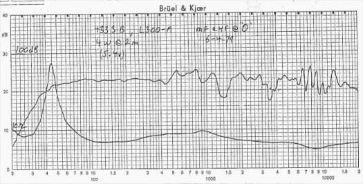

Hello Lynn
"I am in agreement with Newell and Dr. Holland on essentially all of the points. I'm primarily interested in smooth FR, time/phase response, and directivity (most importantly, without narrow spikes only a few degrees wide). I'm less interested in a specified degree of directivity than I am in freedom from narrow artifacts in frequency, time, or spatial domains - thus the interest in drivers that are free from breakup in the working band, horn/waveguides that are free of internal obstructions, and phase-plugs that emit coherent wavefronts. Smooth driver response without a lot of wacko equalization is a major advantage in my book - and I'm aware this isn't a fashionable viewpoint in the pro and audiophile worlds these days."
If something is fashionable or not is really not important. The reason the SR community at large embraces Constant Directivity and CD type wave guides is because they make so much sense in that application.
I think you should be looking at what's happening off axis and particularly what the directivity is around your proposed crossover points. All the phase, frequency and time anomalies you are trying to avoid potentially will be present is a 3 way using midrange and tweeter components that have narrowing directivity patterns on axis. Just the diameter of the horn and the voice coils offsets will almost guarantee comb filtering through the proposed crossover range. All you need to do is look at the various system measurements from the classic JBL 3 and 4 way monitors.
If you look at the 2420/2307/2312 compression driver horn combo the directivity of the chosen horn has to be close to them to flatten the on axis response of the 2420. The directivity of the 2405 is similar to what the ribbons are far a directivity is concerned with narrow in the vertical and wide horizontal axis. Both the horn and 2405's directivity were very limited through the crossover range and above.
If you look at the monitors the 2405 and 2307 are side by side. Looking at the directivity it easy to see why. These systems sound the most balanced when your ears are on axis with these drivers. Putting them side by side cure this does not effect the comb filtering through the crossover range.
The best way to avoid this in simply not add a tweeter. It's name your poison though as you don't want to run a 1" driver to low. If you look at the 4 ways, which are arguably the best sounding a 10" midrange covers the 300hz-1.2K range. It's all about compromises.

Attached is a system plot for the 4333.
Just food for thought.
