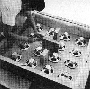

1) Obviously, the popularity of systems like the Bose 901 and 902 prove that many people are not bothered by interference patterns. Those of us that do find the interference patterns of full range side by side arrays both audible, and objectionable, disagree with your assessment of them.
Of course, if you can't hear them yourself, the interference patterns only exist as a measured reality you can choose to ignore in a domestic environment.

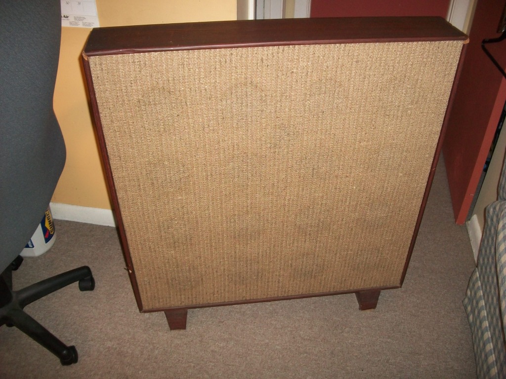

Not that we can't all suffer from sonic hallucinations, several years back I purchased a pair of Renkus Heinz ICX7 mini line arrays after hearing them demoed in a large room with a Nora Jones CD playing through them, an artist I had not heard before. Later, I realized that in spite of a complex shading crossover scheme on the 7 tweeters (to avoid comb filtering), a simple column of eight 4 inch five watt fifty cent full range NSB (No Stinking Badges) buyout speakers had more dynamic range, better overall sound above 100 Hz, and cost a small fraction of what I paid for the ICX7

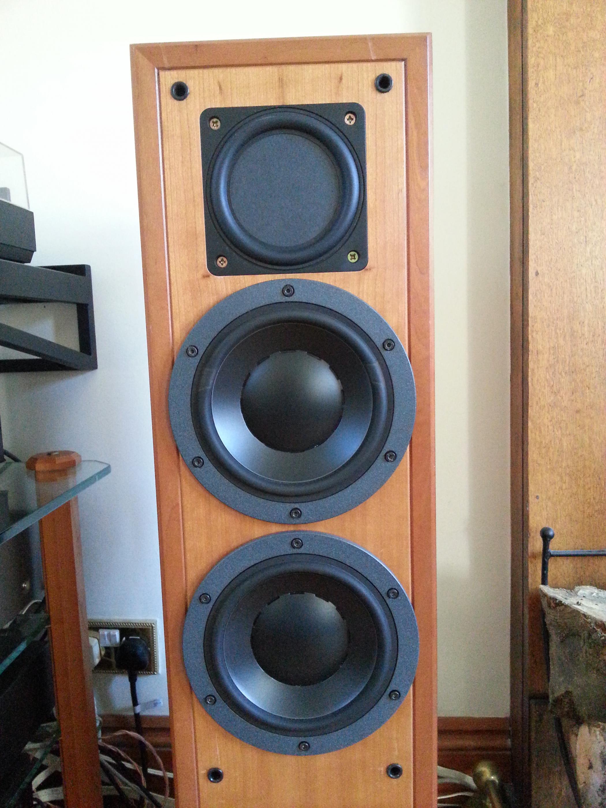

Just to put some perspective on the single BMR driver used as point source, not in a line array or panel....
The attached single BMR is crossed over ( via a low cost AV amp) at 160Hz to a pair of 6.5 inch bass drivers, active amplification via Musical Fidelity on the BMR and Audiolab on the bass.
The speakers fill a medium room (8m long 5m wide) with a powerful and natural sound, easily hitting 97dB music peaks at the 5m listening position. This is equivalent to 108dB at 1 meter...Not to shabby for a 4.5 inch full ranger!

Having gone through the excitement of "discovering" and building speaker designs over the last 44 years, I can relate to your enthusiasm. Each "new" design's flaws always somehow seem to be overcome by some perceived sonic advantage.
To put some perspective on the "single BMR driver" again requires interpolation of your limited description.
1) You say "The speakers fill a medium room" implying a pair of speakers, each using a pair of 6.5" bass drivers and a BMR, all six drivers contributing to the SPL level, with the bass drivers likely some unknown amount louder than the BMR. Assuming the pair of BMR alone can achieve 97dB music peaks at 5m (unknown, though if you specified dBA scale, it would be known) we must subtract 6 dB since it takes two drivers to achieve 97 dB, so the level required for each driver now drops to a bit below 103 dB per driver assuming a six dB drop per doubling of distance, as would occur in free space, outdoors.
2) Indoors, sound does not drop at 6 dB per doubling of distance, the reduction in level is dependent on the reverberant field. An acoustically "live" room may show virtually no change in SPL as measured on a dB meter from 1m in front of the speaker to the back of the room.
As an example, in my listening room of 6.1m x 3.3m x 2.15m containing no acoustical treatment other than a sofa, some chairs and bar stools, I just measured myself singing a "room filling" continuous note at 100 dBC at 5 meters, then taking the meter outdoors, my singing level at that distance was only 90 dB, sounding only half as loud to anyone that would care to listen.
3) Having used Galaxy Hot Spot monitors over the years, I have verified the 5" "full range" driver they use is about 90 dB 1w1m above 160 Hz, at 100 watt peaks it can do around 110 dB. Depending on your room reverberation level, the Hot Spot driver is capable of somewhere in the range of 7 to 17 dB more output than your BMR.
Like you say, not too shabby for a 5" full ranger
Art

Hi Derek,
If those panels work that well, maybe you should consider building an updated version of the sweet sixteen.
A problem with those and other multiple source arrays is that for a single impulse fed into the system, what arrives at ones ears is an impulse from each source separated in time according to the differences in path length from each source to ones ears. DSP can correct that in one location but always at the expense of all other locations.
Well I did put the smiley there for a reason...
Here's a quote from the thread the picture was in:
Source thread
Sure, there was a Popular Electronics article about a project called "The
Sweet 16". It was composed of 16 el-cheapo AM radio speakers in a minimal
box. This was around 1960. I heard one at the time in a local electronics
store, and thought it was some kind of a sonic disaster. It realized every
cliché about trying to make a silk purse out of a pig's ear etc. that you
ever heard. Later on there was a sequel project called "The Sweet 16+1". It
added a cheap tweeter. This was basically trying to put lipstick on a pig,
polish a turd, you name it.
In the day of "The Sweet 16", remarkably little was generally known about
loudspeakers and loudspeaker systems, compared to what is known today. So,
it can be excused on the grounds of general ignorance. The first problem was
that the speakers the Sweet 16" was made out, of were systematically
low-fi. The article argued that by combining many of them, the random
variations would be evened out. In fact the speaker drivers were
consistently low-fi.
Then there was the problem of the Sweet 16" speaker array itself. When
speakers are placed close together, a variety of complex interactions
result. These tend to add many more frequency response variations on top of
the many that might be present in the individual drivers themselves.
It turns out that there is a similar array that can work, but it has 25
speakers, not 16. It's called a Bessel array N=25, and details relating to
is can be found in some posts I made in the past few months. I recently
built a Bessel Array N=5, and it works, but.
When all is said and done, the Bessel array N=25 does not deliver 25 times
the sound of one of the speakers that it is composed of. Some of the drivers
must be connected with reversed polarity. The performance of about a
quarter of the array is sacrificed to make the rest of the array work
reasonably well. In the final analysis, you end up with a system that
performs pretty much like just one of the drivers if you sit some distance
from it. Close up is still not a pretty picture. However it does get
considerably louder if you apply much more power.
Source thread
