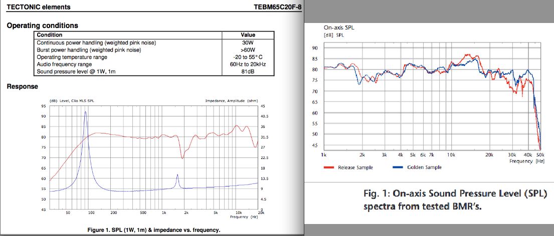

Derek,Your quote :
" Assuming the pair of BMR alone can achieve 97dB music peaks at 5m (unknown, though if you specified dBA scale, it would be known) we must subtract 6 dB since it takes two drivers to achieve 97 dB..."
Wrong! You add or subtract 3 dB for each doubling or halving of the Sd (number of drivers in this case)
In addition you add or subtract 3 dB for each doubling of power, assumed for two drivers, totaling a +6 dB change for two drivers over one.
You conveniently ignored the part about indoor measurements do not fall at 6 dB per doubling of distance.

Full suite of independant measurements ...
Hi Art,
No worries, I can understand your scepticism and once the production drivers arrive I will commission the professional independent measurements.
Its important that I only publish 100% independently verified measurements as I am serious about the long term commercial side to these drivers.
I would happily publish my indoor graphs with a caveat if I was only planning on selling drivers, DIY kits and speakers direct to the public, but that is a small niche market and not my main focus.
You can imagine the problems it would cause a year from now if my pre production indoor measurements were used by my soon to be commercial competitors ....The web is a small place!
I hope you understand and don't mind being patient.
If I were to guess at the final out door or anechoic sensitivity measured with top grade gear, I would still say above 87dB for 1 watt at 1 meter....Should know for a fact round Christmas.

Derek,Hi Art,
Based on measured response of the Tectonic and other BMR, other than at the upper HF peaks evident in their published response, it appears your sensitivity "guess" may be about 6 dB high. Of course, a simple dB meter test would read those peaks as very close to your guess.
If I were planning a release of a commercial product, I might commission professional independent measurements after I had already conducted my own. Why you would not conduct measurements on prototypes prior to commissioning more product is beyond me.
So I don't really understand, and am not feeling particularly patient with you promoting your future products with unfounded claims and guesses, rather than measurements that would back up their merit. Well actually, the skeptic in me thinks you don't share measurements because either they look bad (the reason you don't see polar response measurements for any panel based systems) or you simply have not bothered to make them.
In either case, please excuse my skepticism until you share some actual useful data, and don't expect me to hold my breath during the interim
Art

Derek,
"Based on measured response of the Tectonic and other BMR, ....."
My BMR is not like any of them....!
" If I were planning a release of a commercial product, I might commission professional independent measurements after I had already conducted my own....."
Art, for the 10th time on this thread and others....Of course I have my done own (indoor) measurements and of course I am greatly encouraged by them, now after 4 years, not so good on Mk 1 versions at the start!
Are you trying to put the readers of this thread to sleep by asking the same basic questions and ignoring the answers I keep having to repeat ....Even I am getting bored!
Here I will just cut n paste from my previous post...
" Its important that I only publish 100% independently verified measurements as I am serious about the long term commercial side to these drivers.
You can imagine the problems it would cause a year from now if my pre production indoor measurements were used by my soon to be commercial competitors ....The web is a small place!"

I am looking at their data....Their measurements....If you had bothered to check the waterfall plot I published a few weeks ago was a Tymphany measurement....
Today I have a 4 page " Sample Submission Report" on my desk , here are a few Tymphany TS data measurements on the double roll silk surround version.....Without revealing anything of a commercially sensitive nature and only for the other more open minded forum members....
Revc - 3.4Ohm
Zmin - 4.97 Ohm
VC inductance - 0.02 mH
Fs - 126HzQms - 2.15
Qts 0.53
Mms 6.03g
Bl 4.82
Mms : Bl ratio 1.25
Sd 70.88
Sensitivity @ 1w/1m = 88.23 dB
Half space sensitivity @2.83 volts 90.3 dB

Thanks for posting Greebster, this is helpful.
I am looking into the levels at which path length differences become audible with music, audible with test tones and measurable.
Trying to separate and prioritise the most important measurements is the goal.
Cheers
Derek.

In ECM/RADAR this is known as burn through. It is the relative distance vs power. If your plane has 5kw to jam the ground based site, the power level it has could easily be 5 million watts. The point where they become equal is dead mans land. The same is true inversely, if the average room level at listening position is say 90dB @ 4m and you move =>1 meter in either direction closer that is more than enough to upset the added acoustical gain afforded by the farther speaker.
