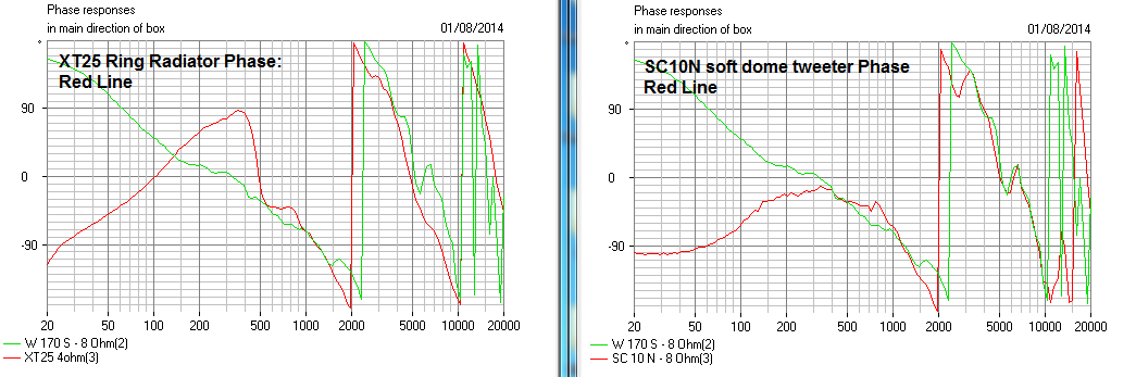

The phase response is also useful. Every kink in it corresponds to energy storage. You can see that the Vifa XT25 ring radiator (here modelled with a 6" paper bass) does a very good job of keeping phase straight at high frequency compared to a typical Visaton SC10N soft dome. It'll sound different. And you can see why when you measure the right thing.
Very unusual and accurate sound, but not easy to get right IMO. Dispersion is an issue at high frequency.
As for measurement, we do rely far too much on simple frequency response and harmonic distortion on axis. You can do a lot more with dispersion and white noise testing. White noise testing is an old radio frequency technique whereby you inject a sine wave and measure the white noise produced right across the band.
Yes, any driver with a diameter larger than the wavelengths reproduced will have "dispersion issues" in the high frequencies, the reason for small tweeters. A single Manger driver does exhibit near flat phase on axis though.I'm sure there is life in the BMR (bending mode radiator) sort of speaker. Which essentially uses a large flat diaphragm. The Manger Zerobox 103 is a typical example:

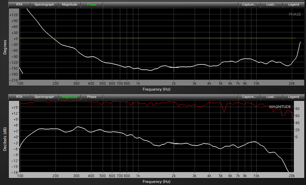

The cheap drivers used in this project have much flatter phase response than the Vifa you showed:

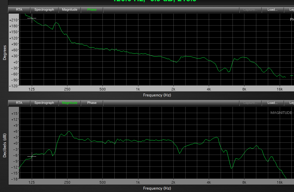

Not convinced about the linear phase response though. I want to see a graph!
Well, there are plenty of graphs already in the Dirty Dozen thread, but here is the frequency and phase response both raw, and with EQ. The phase was flatter in the low end prior to making the cabinet a bass reflex.

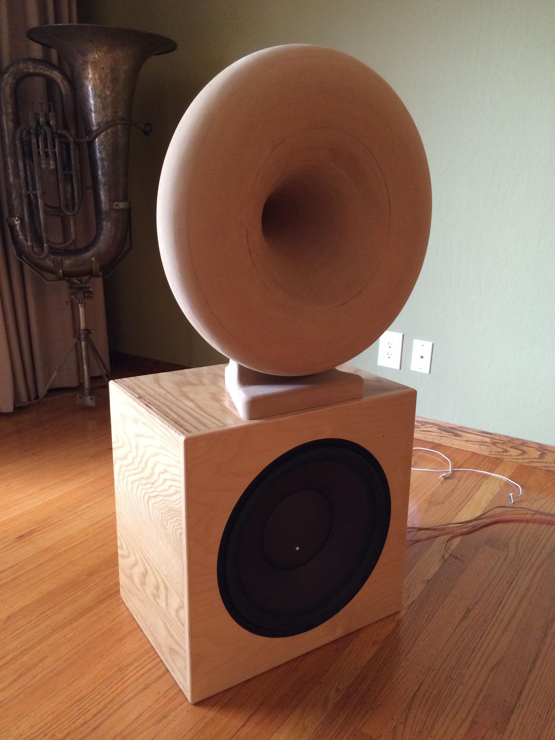

Newbie Speaker Build: Part 1
Probably the biggest advantage I have in attempting my first “from scratch” speaker build is that my brother, who’ll actually be building the enclosures, is a brilliant carpenter. I do have a basic design concept, and if can ask enough of the right questions here I think I may finish with happy results.
Woofer & Enclosure section: I want to choose among the Great Plains 416-8/16B, 515-8/16C and 515-8/16LF. The 416-8B spec sheet speaks of its smooth response. And the curve on p. 2 also seems to show an impressively flat midbass and lower midrange response. http://www.greatplainsaudio.com/downloads/416-8B%20Spec%20Sheet.pdf (though no curves included for http://www.greatplainsaudio.com/downloads/515_C.pdf and http://www.greatplainsaudio.com/downloads/515_LF.pdf )
Presumably, this performance may be due, at least in part, to the Alnico magnet.
But in your experience-using a sealed cabinet-please estimate which of these
woofers would likely have a.) the best bass, midbass and lower midrange response b.) “tightest” most articulate bass c.) “cleanest” low distortion sound d.) able to produce its full bandwidth down to ~35Hz @ 85db at 8 to 10 watts in a ~ 14 x 7 x 13 room.
Now, please repeat your estimated ratings of these three woofers against the same performance goals using a ported cabinet.
Like the GPA 416B and 515C, does anyone know if the 515LF can be ordered with an Alnico magnet?
What, if any, are the advantages of Alnico in one of the above woofers for achieving my performance goals?
In order to produce cabinet and/or port diameter dimensions for given T/S parameters,
please provide the link to a recommended online calculator or some cost-effective software.
Is a triangular or polygonal woofer enclosure the best way to prevent internal standing waves?
Also, please provide the link to a good primer(s) on preventing diffraction problems in speaker design. Thank you.
My current direct radiators (GPA-416 alnico) sound vastly superior. I am just thrilled to have such beautiful sound in my listening room at last, after all these years of effort. To have it be the result of DIY is even better! Gary Dahl

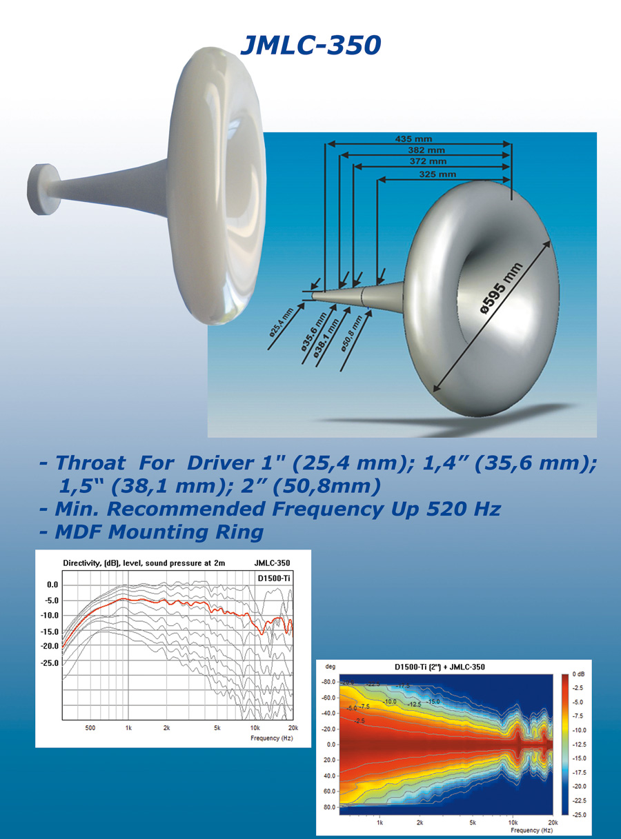

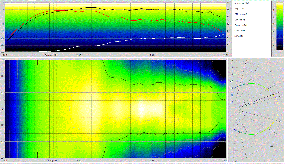

Dr. Geddes's NS15 speaker polar plots are the best I have ever seen. Geddes uses a 1" compression driver on a 18" diameter OS waveguide crossed ~900Hz to a wide bandwdith 15" sealed midbass. I'm a believer, and have collected TD15M midbass + Faital HF10AK compression and plan to find a JMLC350 horn with 1" throat. No Lazy Ribbons generating nasty polars hanging around here.
If your Brother's wood shop includes CNC tools which can manufacture stacked-MDF JMLC 350 horns, he could sell small hobby production lots. Winter is coming. Great stocking stuffer.

A few thoughts:
1. I haven't posted a schematic of my current crossover. If one tried to duplicate the circuit with different autoformers the response wouldn't be the same anyway. I would hesitate to encourage someone to build a system like this if they won't be able to make measurements. I am quite pleased with the way it sounds now, but there is room for improvement.
2. The system is presently a 2-way plus subwoofers (no ribbons). Passive equalization is used to extend the highs of the Radian 745. Imaging is much better this way, and it sounds more natural (less "hi-fi") to me.
3. The GPA 416-8B sounds great in a ~3cf sealed enclosure, and its well-controlled LF rolloff makes it easy to integrate a subwoofer (or two) of one's choice.
4. I used MDF corners with a 4-inch radius. They were designed to mate with panels of 3/4" thickness. You can find them here (part number 4QL-3496-MDF).
5. Based on my experiences thus far, I would have to say that I don't care for the sound of aluminum diaphragms with classical music. No matter how flat the frequency response is made, I hear a layer of metallic haze that interferes with the upper harmonics of orchestral strings and woodwinds. For some reason this doesn't bother me when listening to non-classical genres, but it should be no surprise that I can't live with a speaker system that steers me away from orchestral music.
Gary Dahl

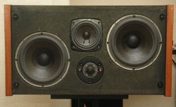

Not mine but I like it lots.
The thing I really like about Gary's two way is it gives one options. Since the F3 rolloff in sealed is below 80hz, one can go with different sub solutions if one doesn't want to go with the TD15. For example, one could use the multi-sub solution ala Toole/Geddes for spatial smoothing of room modes. Also makes the mains a bit more compact for smaller rooms/WAF.
