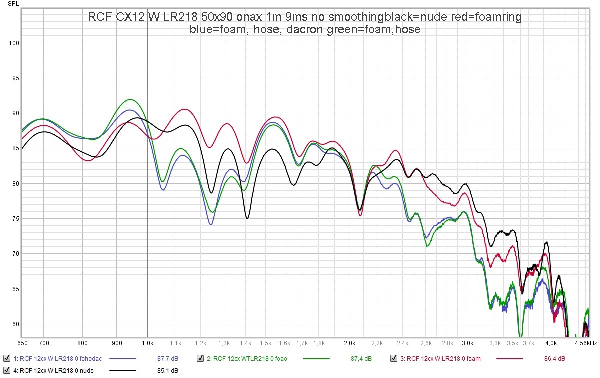

These are great results - congratulations!Woofer problem solved!
Did you already do some measurements off axis to check what's happening and if it influences the tweeter off axis response?

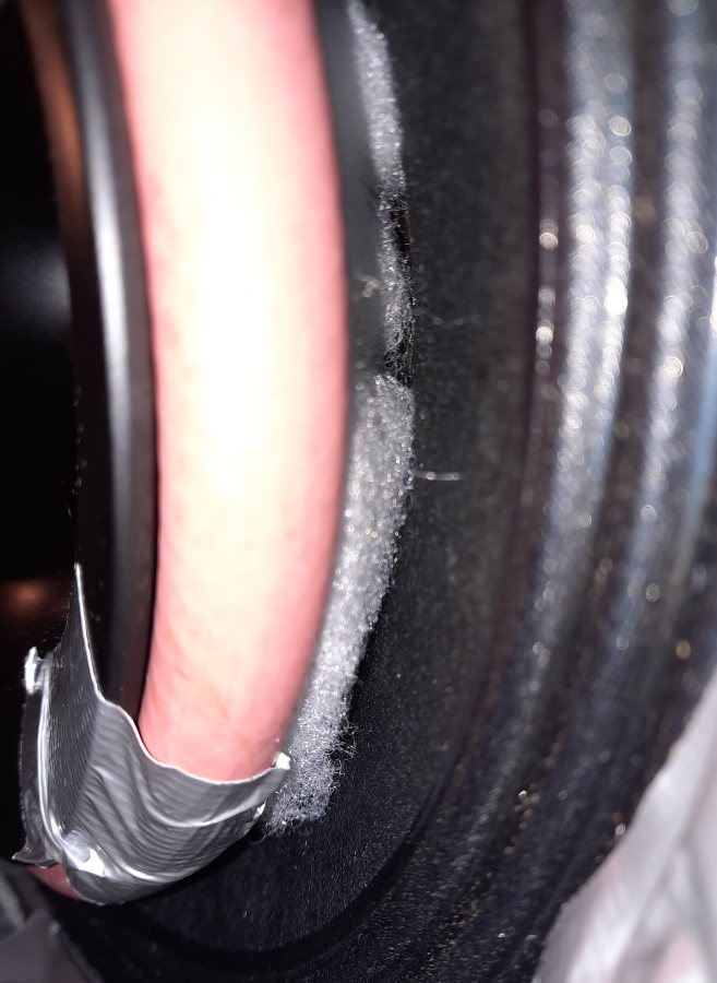

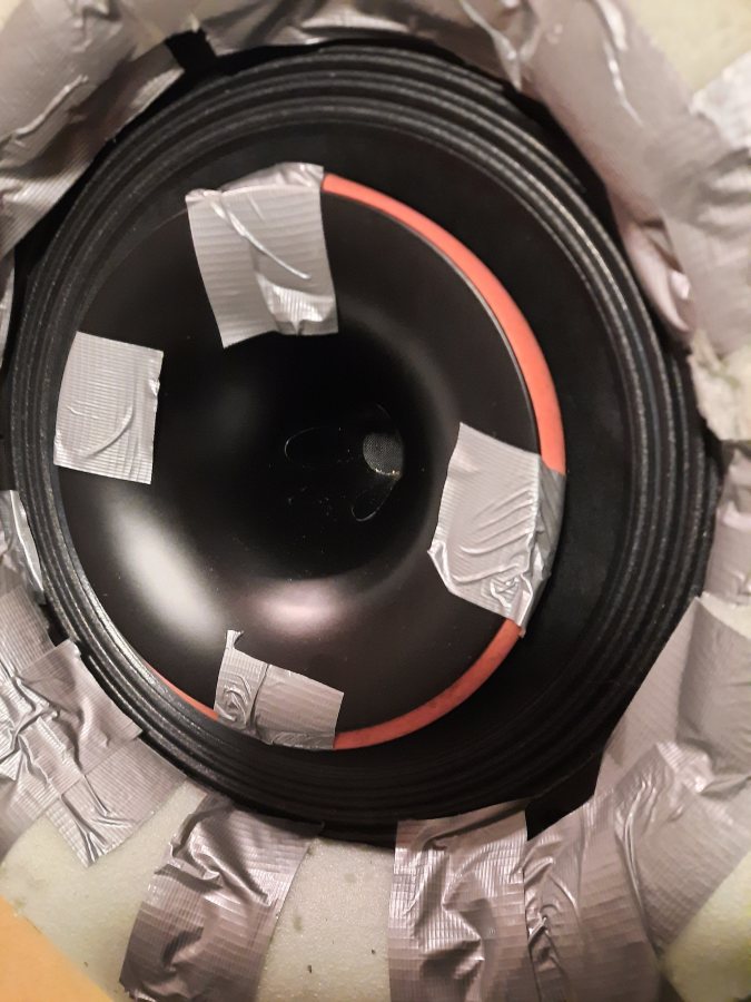

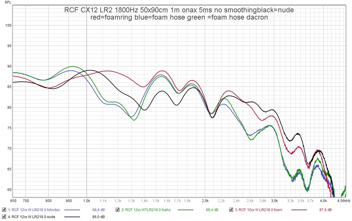

But seriously, when testing these modifications it is wise to overdo the shape, then changes in response will be larger. This time I picked a piece of 1/2" garden hose and taped a ring of it behind the horn's edge. I also tucked dacron wool behind the hose. I tested only the woofer 0-axis, and outcome is very clear.
The hose ring makes the resonance much worse! Foam extension ring rules! Notice, that in measurements Foam ring is on place in all but "nude" take.

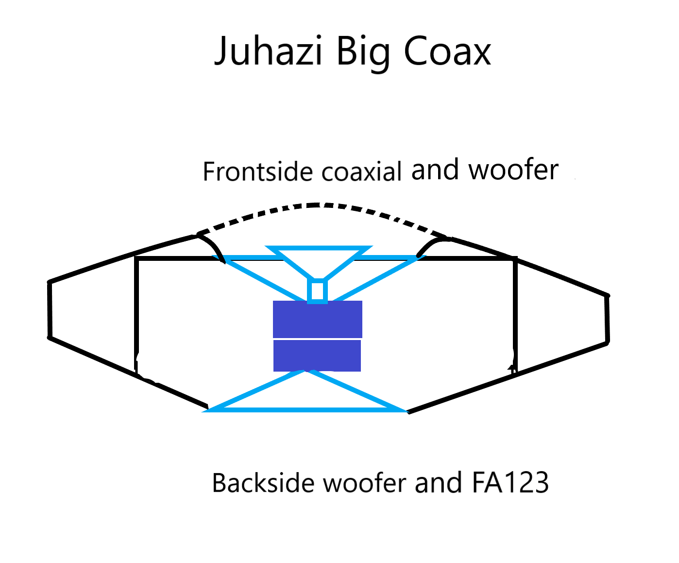

Mounting the 12" coaxial from the in-/backside of the front baffle is not easy in my case. Please see the pic in post #82, which doesn't show all the necessary bracing to make the structure hold. And the coax will be in a small subchamber. It might be possible to make a separate removable back cover for the coax box . If this was an OB, I would definitely mount it on the backside.

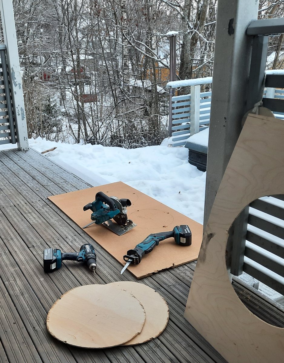

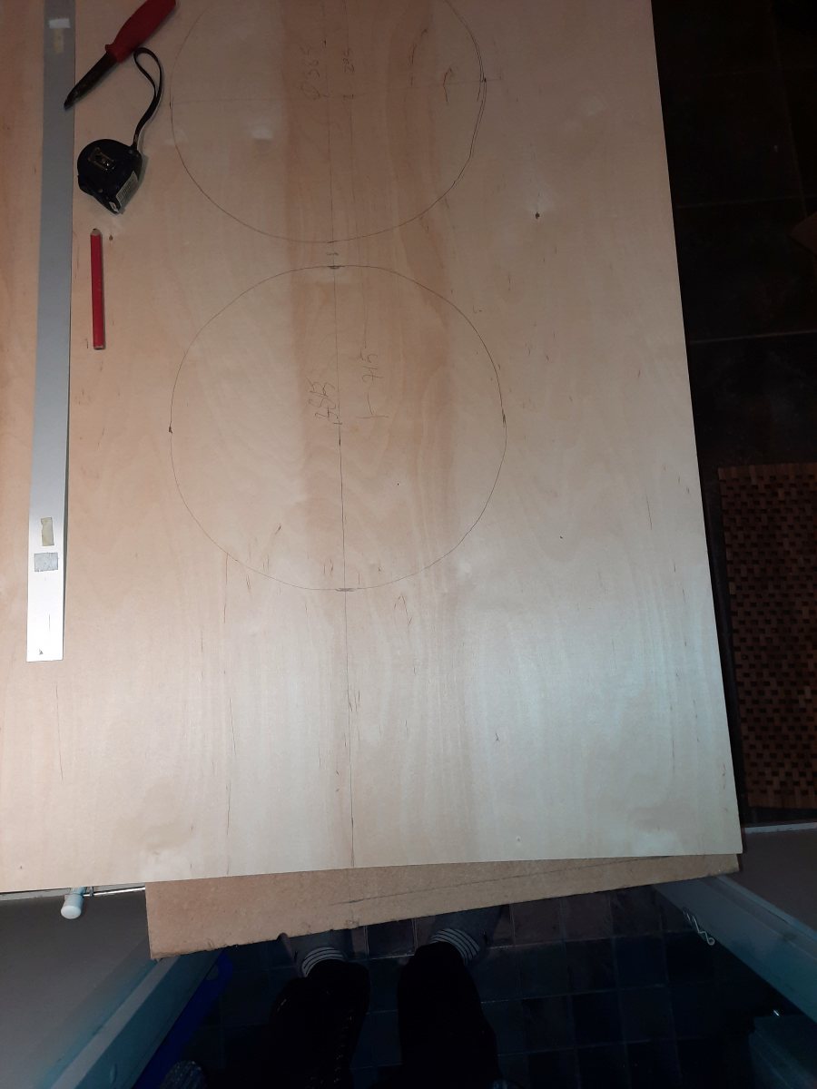

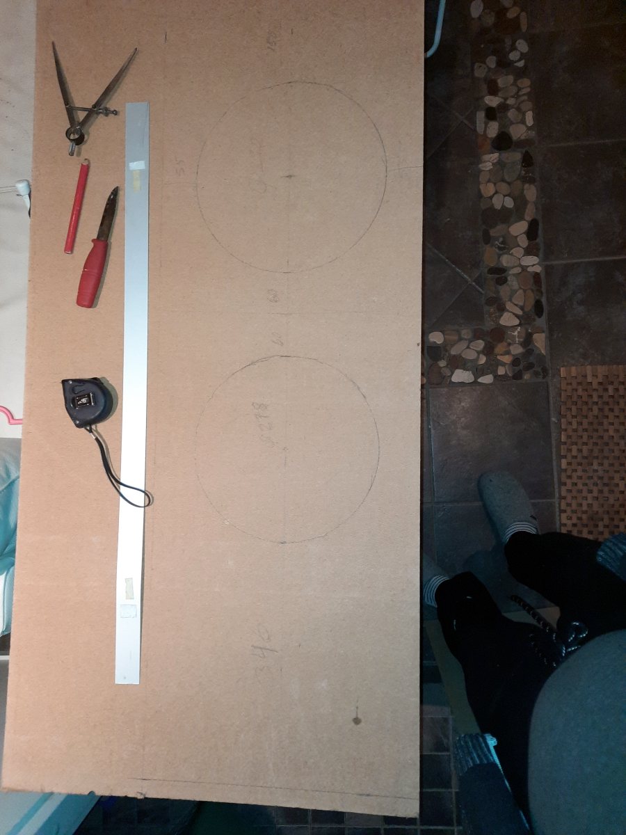

I marked the curved and sub test baffles for cutting. Bows for the curve must be marked too. Actually openings in the curved baffle should be oval, but this is just a proto and I can mod them if needed. Height 1200mm, width 800mm without curvature. Width of the sub baffle is 400mm, height 1200mm. Cutout for RCF is 288mm, for SL-12 278mm.
Tomorrow will be only -10C, next days -15 to -25C and I must work ourdoors on the terrace...
![curv baffle test.jpg curv baffle test.jpg](https://www.diyaudio.com/community/data/attachments/1034/1034204-7486c48b49f64731ea1c78587ee6534e.jpg)
![sub baffle test.jpg sub baffle test.jpg](https://www.diyaudio.com/community/data/attachments/1034/1034203-27ad9faf83832fcd156dc3ebe8e9c6e1.jpg)
