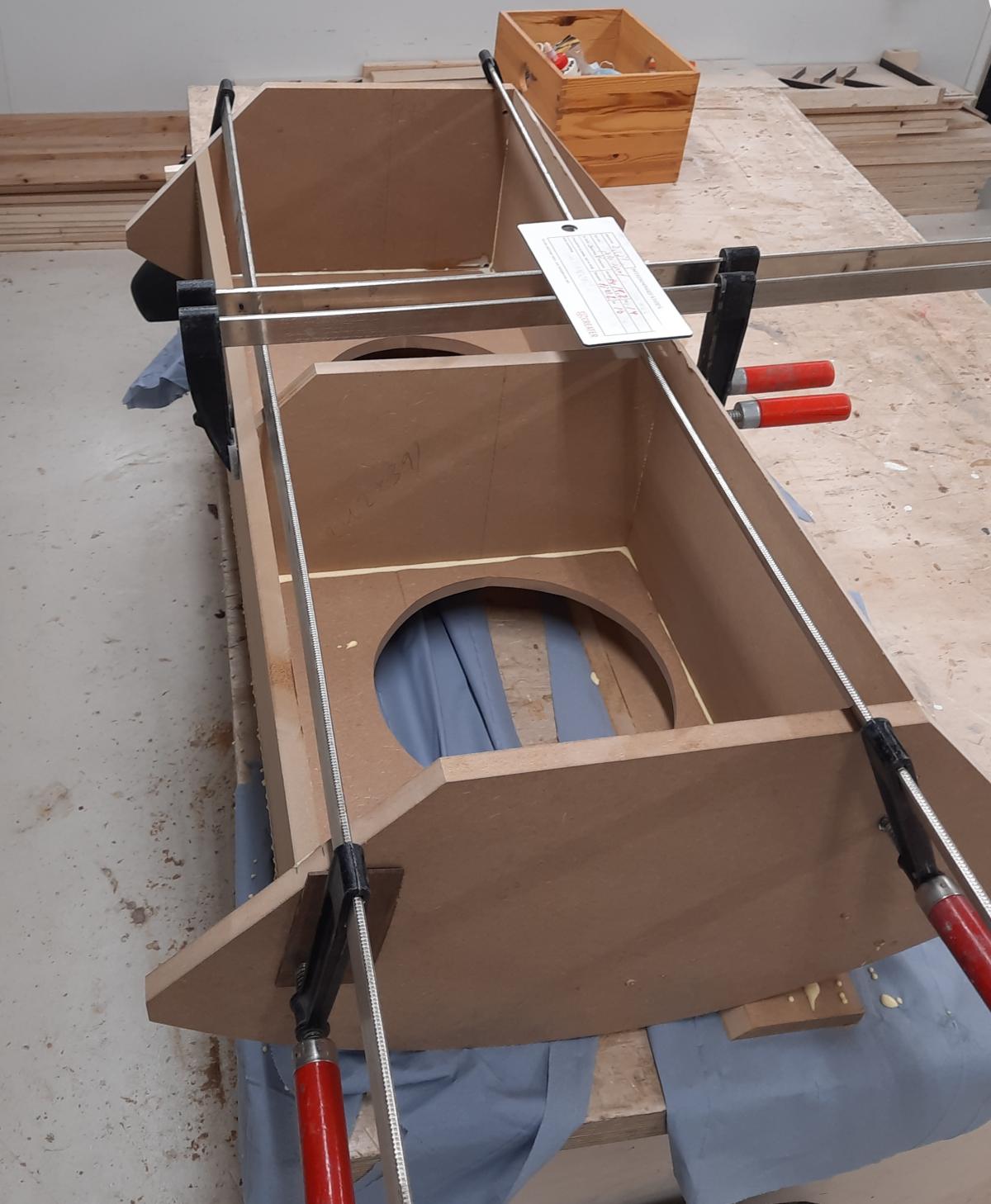

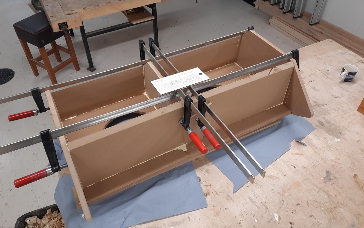

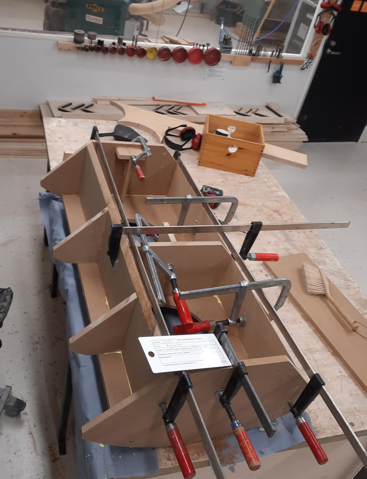

Top and bottom plates and front/back panels are ready now. Not too many straight angles to cut... I snapped my left knee tendons on tuesday evening, the dog trail was icy as hell. I rested and now it seems that it will heal with just support and time. Resting time is always useful for revising building plans and details!
The coaxial driver will be mounted from the inside and it's section of back panel will be attached with screws. Curved plywood panel cavities will be filled with PU foam and beveled recessions will be finished with glassfiber putty.

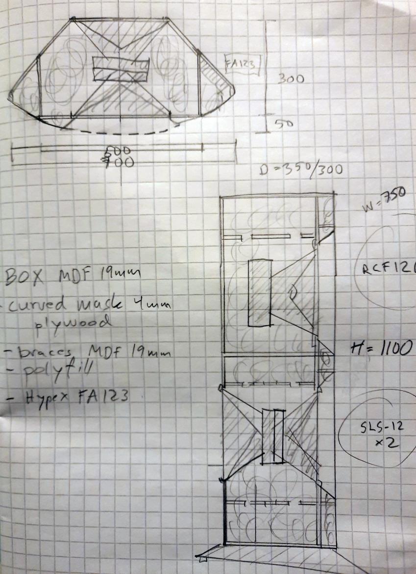

50L sounds a bit small for 2x12", but I guess DSP will correct it. Not sure if you mentioned it earlier, but what is your estimation on XO between the lower woofers and the coax?
The reason I mention the volume is that for some reason I have always found big woofers in small enclosures to sound 'boomy' in the higher bass, maybe from 100Hz and up, sometimes in the 200Hz range. Even when EQ:d flat they sounded 'resonant' in upper bass. This is mainly based on some subwoofer builds etc., and did not matter much for the application. Subjectively I have always preferred bass from big closed boxes. I have no theoretical explanation for it, just based on the limited experience I have. Possibly distortion related, because in some cases it was audible even with low XO at higher SPL.
I think what I'm trying to say is that if I was building those enclosures, I would try to utilize whatever volume is available. Can't hurt, right?

About low bass with 2xSLS-12
I have not modelled it at all in no way. I know that they like big box. I know also that normal size rooms and speaker placement near the wall or even in the corner will help with low bass. I know that my son lives in an apartmet, so he can't listen very loud.
My way to set low freq EQ with dsp is based on in-room measurements in final listening environment. Distrortion tests will give outlines to how much eq can be used. Settings require shelving and peak correction filters with some values of gain and Q. Too much gain can lead to digital signal clipping, amplifier clipping or driver hitting Xmech.
We will see how it goes later on. If I hit limits, drivers and amplifiers can easily be changed.

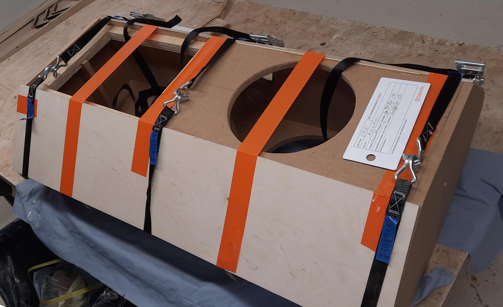

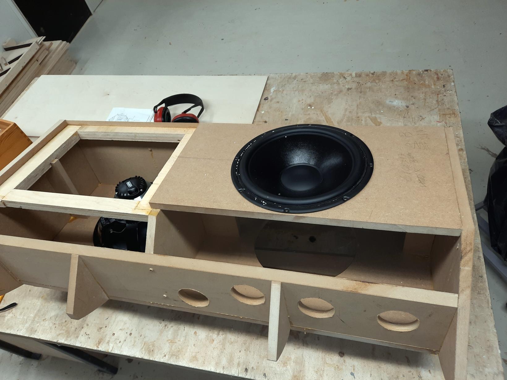

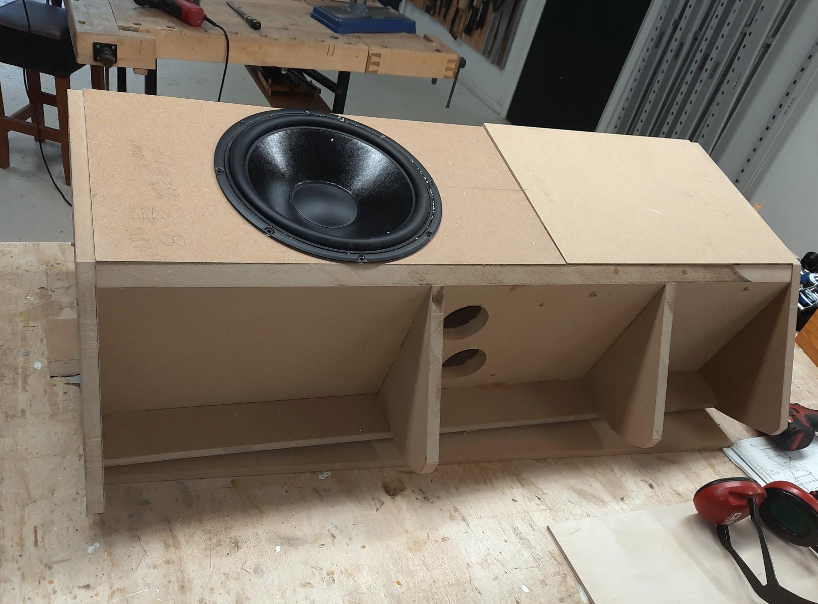

Yesterday and today totals 8 hours at the workshop. Some extra studs glued and openings to side cavities drilled. I tested fitting the drivers in cutouts and then glued on side panels, 6,5mm birch plywood. Top plate will be plywood too, like the curved front panel. Upper part of the back panel will be srewed on. Lower part of right side panel is reserved for the Hypex FA123 amp, no cutout yet.

I think a few more holes could be good to try to push the helmholz resonance up and also give it enough 'breathing', maybe round the edges of the holes too?
