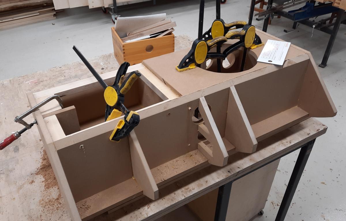

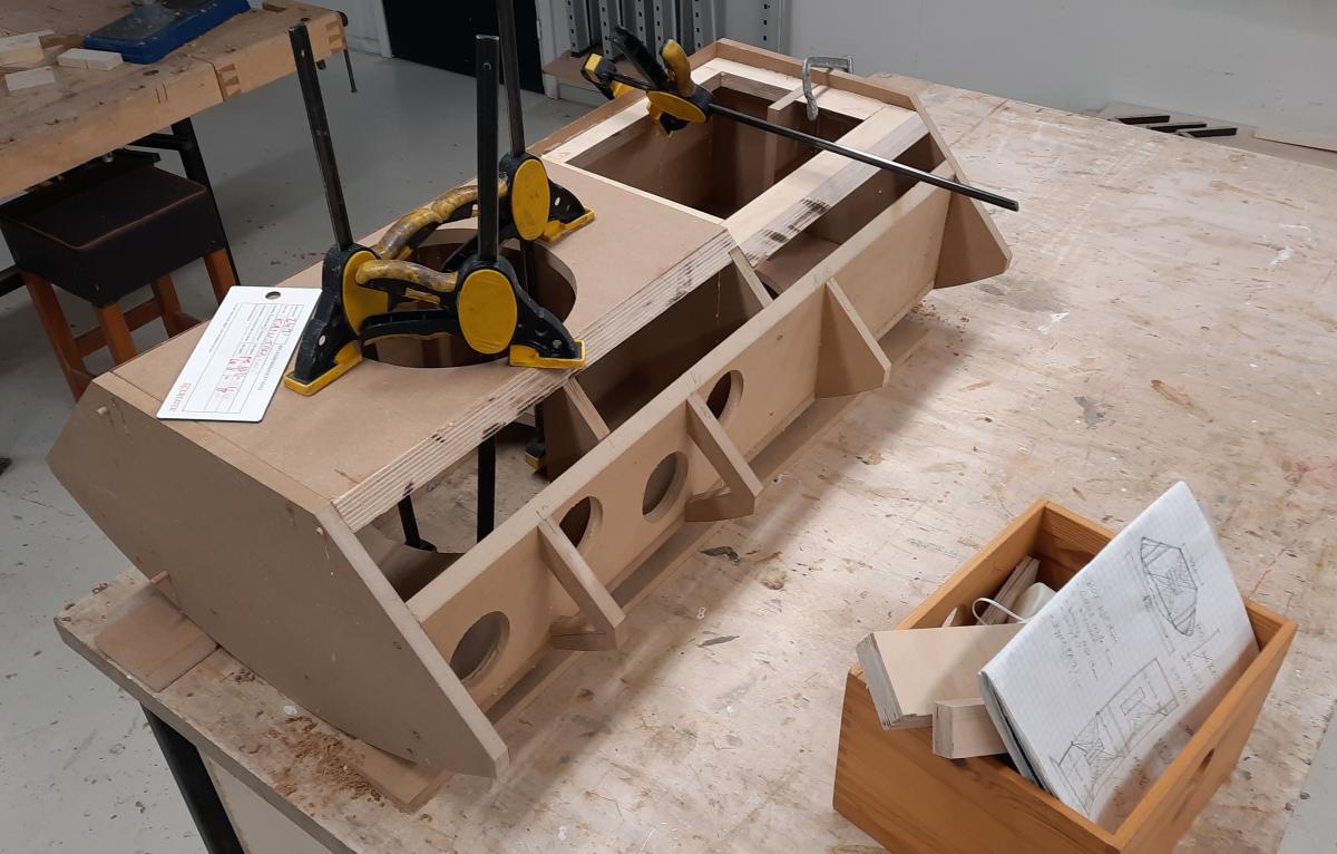

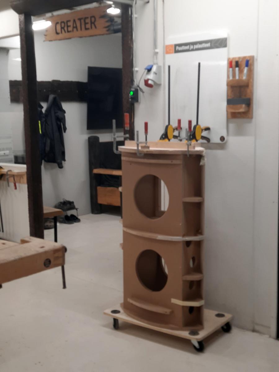

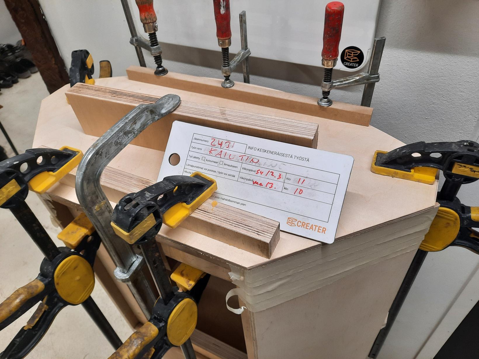

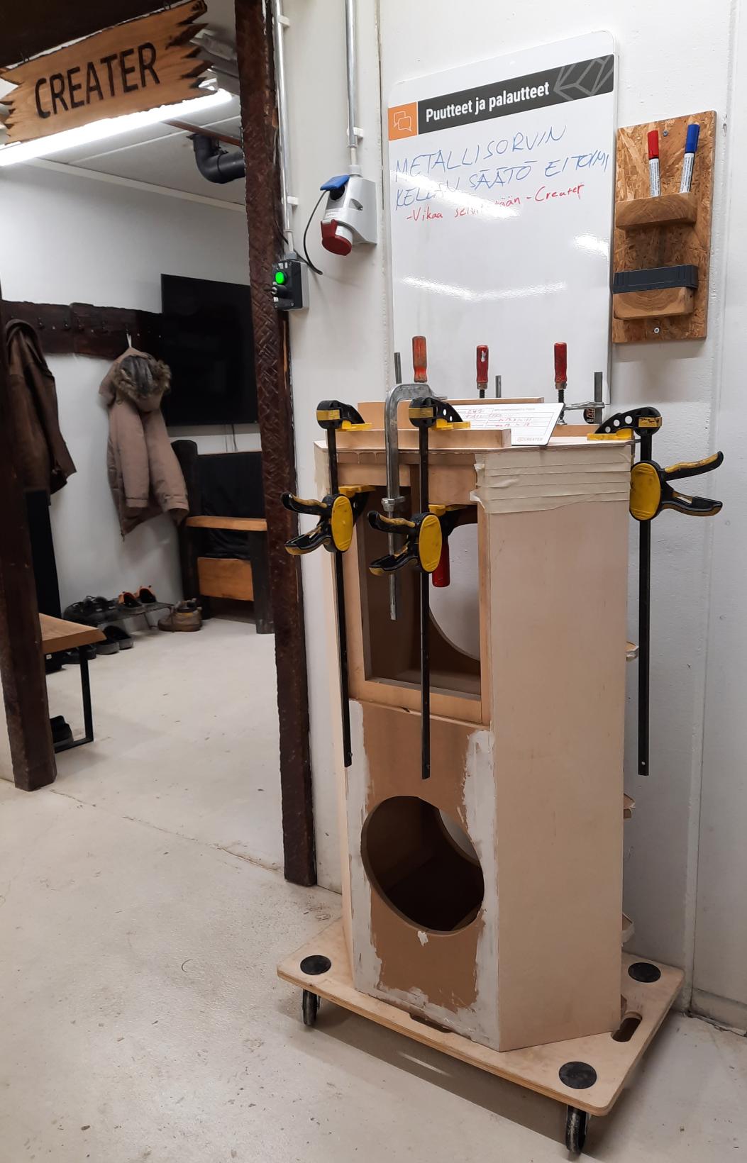

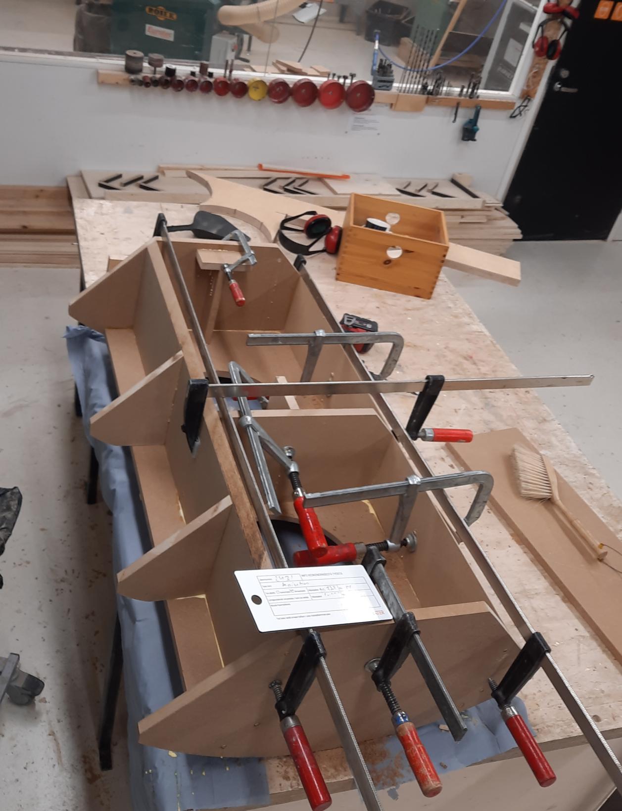

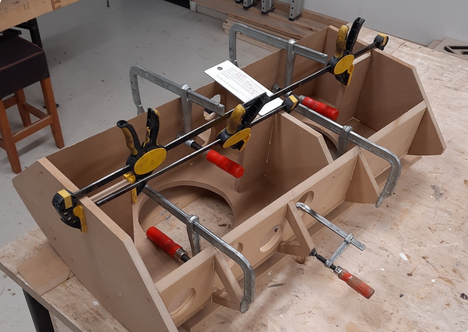

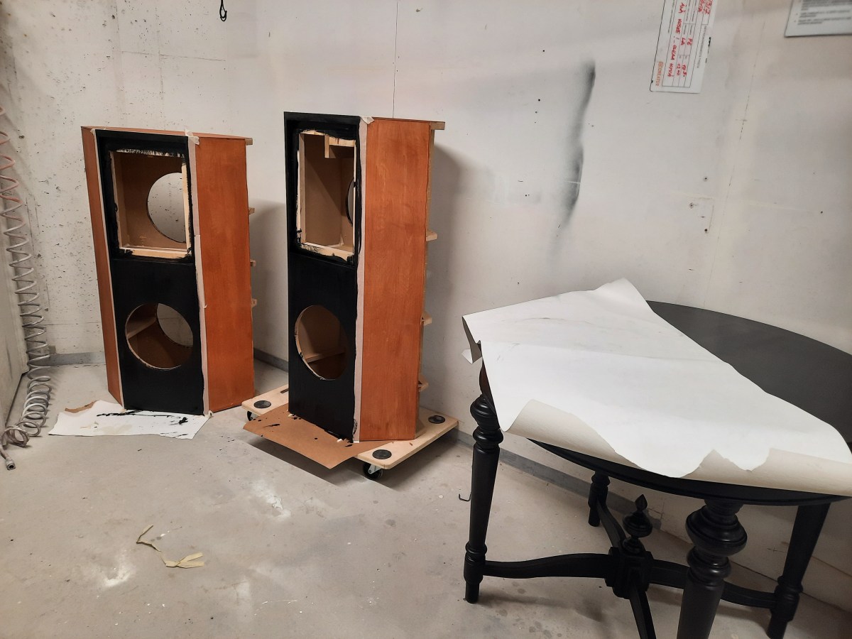

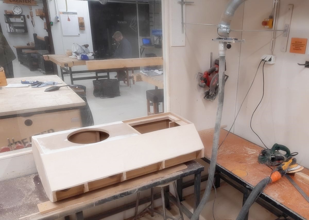

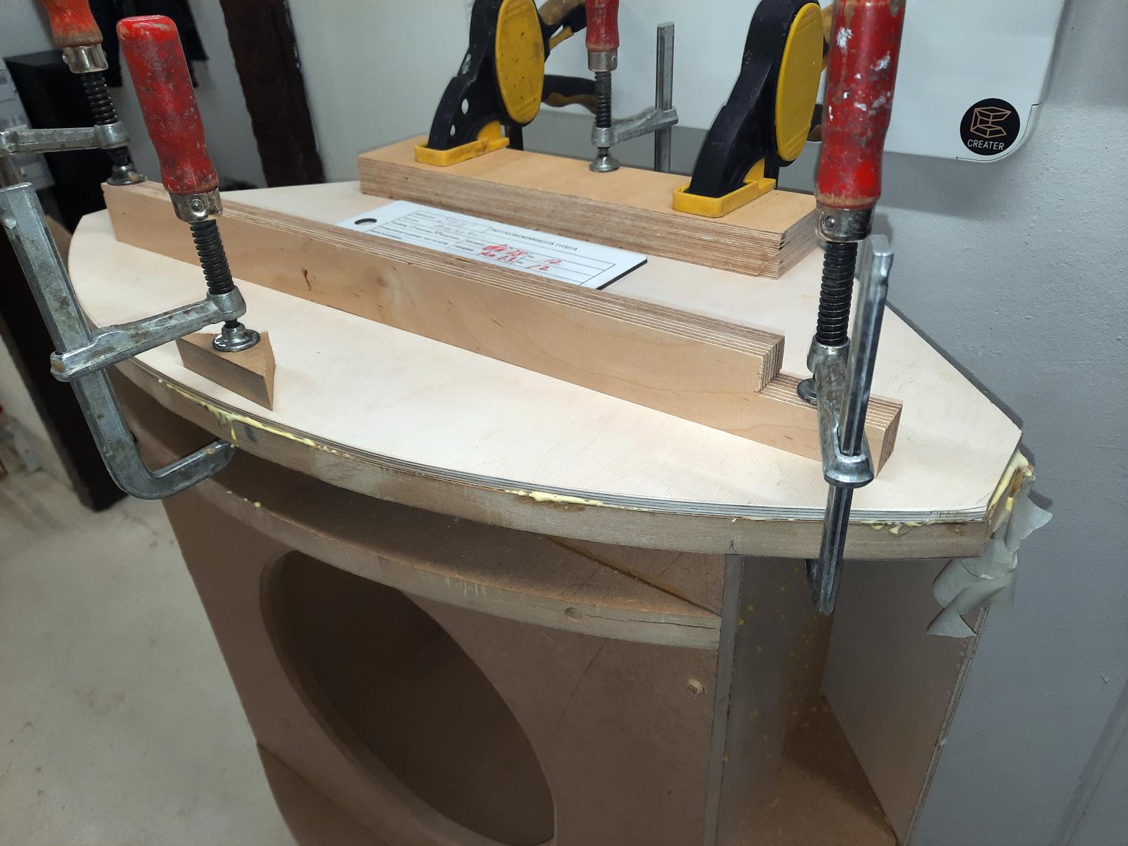

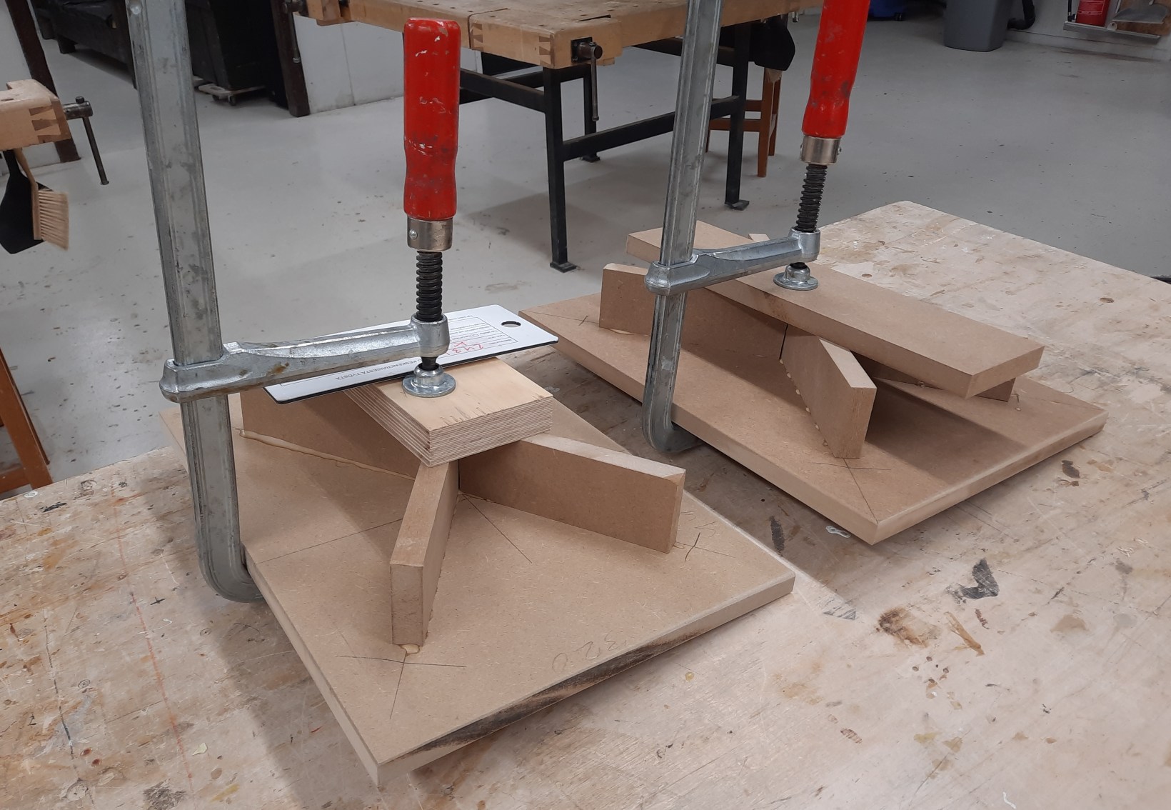

Speaker B's inner box was glued today. I had time to fit some supporting studs too. 4 hours work, all big plates were cut beforehand. Volume of the box for two SLS-12 is roughly 50 liters. I could get 15-20L more by making cutouts to sides.

Openings to side panels should not introduce port noise, because air flow is minimal, all chambers are closed. Helmholz resonance could be an issue, we will see... Here my pic of the statue of prof. Helmholz in Berlin

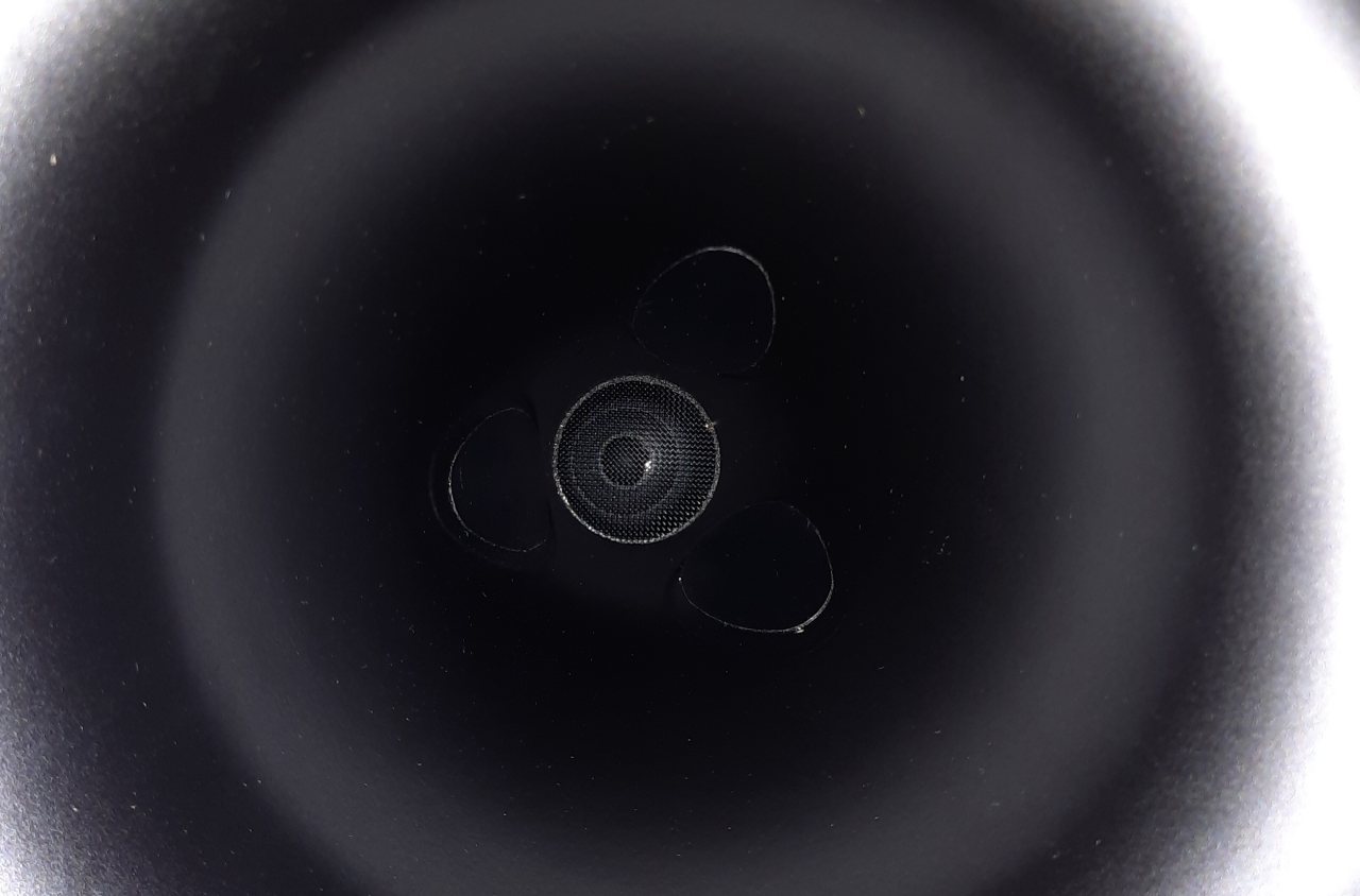

Actually I detached the horn last weekend (and it's aluminium, not plastic like datasheet says) to see how easy it would be to make a minimal throat adapter so that the cone acts as horn. I forgot to take pics, but the coil former is extruding so much that it's impossible to make transition smooth. This 12" cone has 14mm travel and thus would introduce IMD for the tweeter (CD). The benefit of a fixed horn is avoiding IMD and response variations per cone position, and this is the thing that made me to choose this model, this time.
This is a quite common misthinking with large cones. Coaxials have part of horn that is not moving and in home use cone movement is small. It is especially small when there is separate woofer. More like under 1mm than 14mm.
