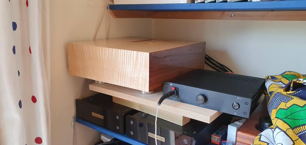

That's great news. Really pleased to see these builds getting completed and most of all, being enjoyed.Finished mine after a 6 week wait for a transformer.
Still need to put it in a box.
Two records in and im going to enjoy this pre-amp.
Isolation by plastic ono band sounded great.
Photos to come when in a chassis.

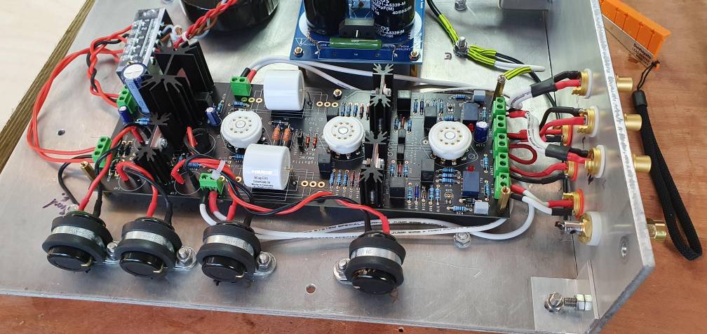

That's a DC blocker....stops DC getting off the mains inlet to the transformer and making it mechanically buzz.What is the extra board doing?
