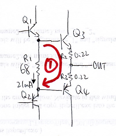

See attached image. I did question about this. Lets consider negative going signal, Q1 is kept on in Class A because Q2 pull Q4 low, in turn pull Q3 low as shown in the path in RED. Q1 really does not have to be responsible to pull the base of Q3 low. So even when I use 68ohm for R1(21mA), Q1 is going to stay class A. Am I correct. This means I can lower the current down to even 10mA and Q1 will stay on all the time.There are "tricks" beyond this .. studied the HK680 , 220R Re - just 7ma.
Scope says it always stays A. Why so low ?

Thanks for replying. This make me think more. Please comment on my rationing here to see whether I am correct or not.
I put such a small heat sink because I mistakenly having too little space between the two drivers, I eventually has to re-layout the board to fit a bigger heat sink.

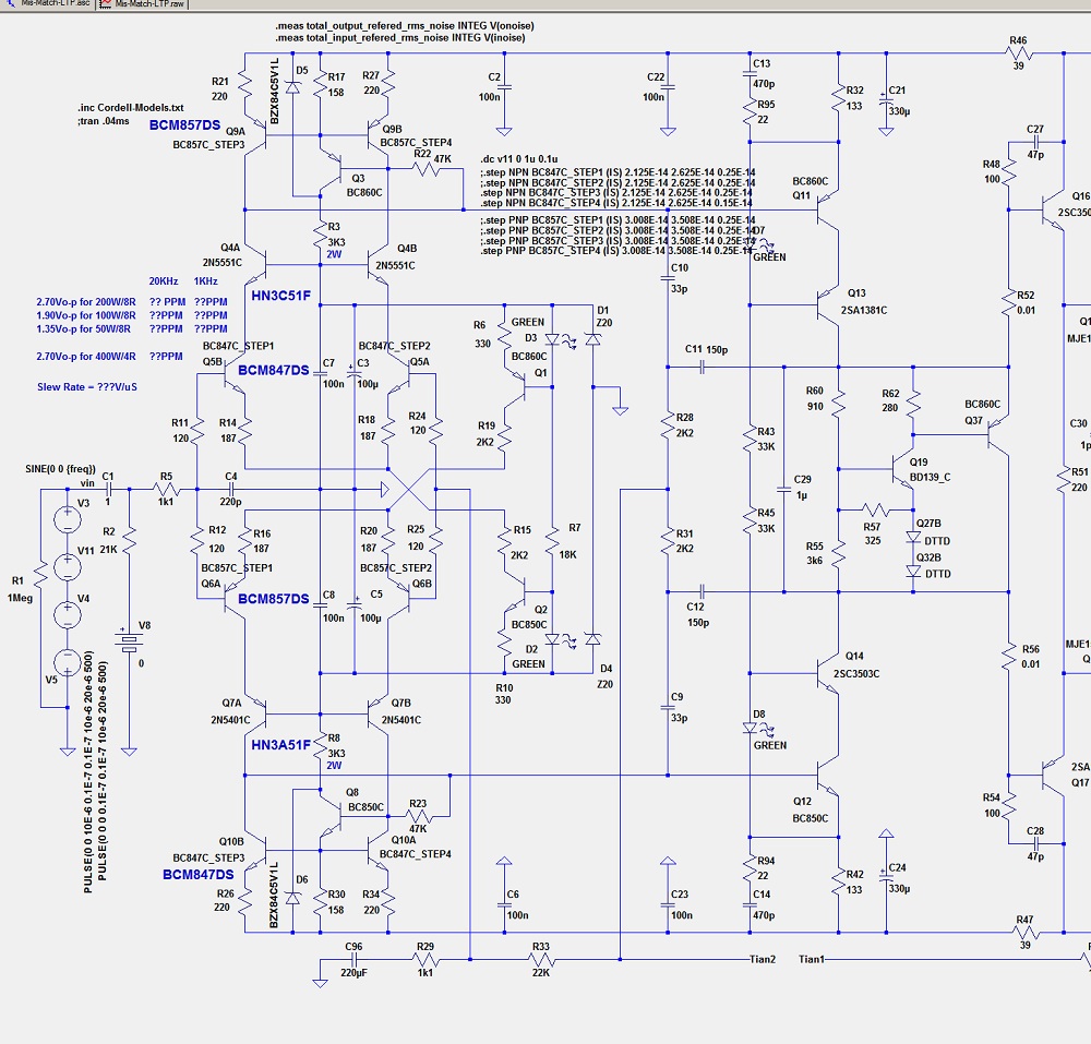

I guess we don`t understand each other very well, I`ll send the simulation pictures and explaining tomorrow
Could you stick an aluminum or copper bar on the board for a heatsink?
Yes, I'm just lazy.
Aluminum is harder, I don't have enough separation between Q7 and Q8 to squeeze a thick aluminum plate as they are like 1/8" thick. Copper plate is more expensive to buy and usually comes in long strips in Home depot.
I did not think of more power dissipation than idle when the signal level is high. Now I might have to think again. If I just have a little more separation between Q7 and Q8, I could have found a scrap heatsink that can fit in between.
My board is layout too tight to save money. I should have relax it a little. The next go around, I definitely increase the width at least 1/4" and make it 1" longer to space out the power transistor a little for better heat dissipation.

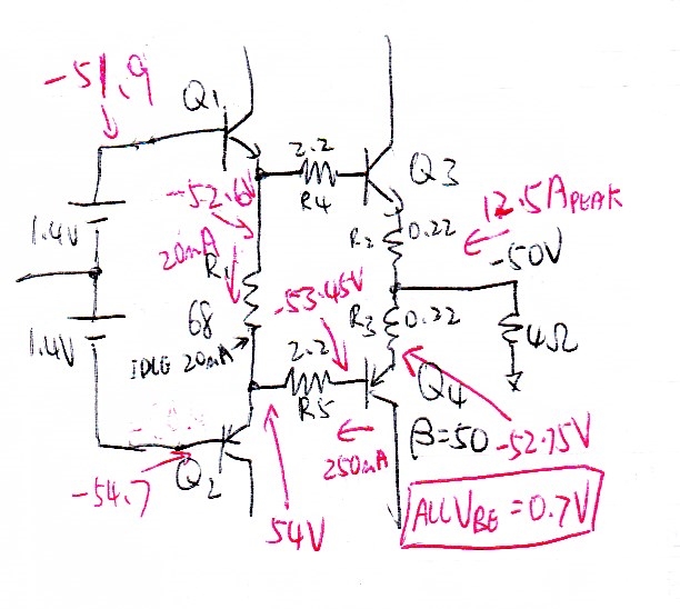

After reading Ostripper's post a few times, I am curious in the dynamic voltage of the drivers and the big output transistors at different points.
Attached is the drawing showing the drivers Q1 and Q2 driving the output transistor Q3 and Q4 respectively, through 2.2ohm base stop resistors R4 and R5. Assume the emitter degen resistor R2 and R3 are 0.22ohm. Assume idle current is small. At idle, current through Q1 and Q2 is set by 1.4V/68=20mA. This is shown in black in the drawing. Assuming all Vbe are 0.7V.
Now let's look at the situation of large signal input where the -ve Vpeak = -50V at the output driving a 4ohm load. The peak current is 12.5A as shown in RED. Let us trace the voltage from the output CLOCKWISE all the way to the emitter of Q1.
1) -50V at output, Q4 sinking 12.5A.
2) R3 has 12.5A, so it drops 12.5A X 0.22ohm = 2.75V. Therefore the emitter of Q4 is -52.75V.
3) Assuming Vbe=0.7V. The base of Q4= -52.75-0.7=-53.45V.
4) Assume beta of Q4=50, Q4 sinking 12.5A implies the base current is 12.5/50=0.25A.
5) voltage drop across the 2.2ohm R5 base stop resistor is 2.2 X 0.25= 0.55V. Therefore the emitter of Q2 is -54V.
6) Assume again Vbe of Q2 is 0.7V, therefore the base of Q2 is at -54.7V.
7) The bias spreader is 2.8V, therefore the base of Q1=--54.7+2.8V=-51.9V.
8) The emitter of Q1 is -51.9-0.7V=-52.6V.
9) The voltage dropped across the resistor R1 between the emitters of Q1 and Q2 is -52.6+54=1.4V. The current through R1 does not change!!!
Of cause the current increase in Q2 and Q4 is going to increase the Vbe of these two transistor. Let's just say the total Vbe increase is 200mV ( this is a lot as it's a logarithmic function). The voltage drop across R1 is 1.4-0.2=1.2V. Current through Q1 and Q2 is 1.2/68=17.6mA. It's nowhere close to turning off.
Please take a look at my work. If this is correct, people NEVER have to worry about the driver transistor being turned off under signal as the current increase for Q1 when Q2 is driving low hard. You can lower the idle current to less than 20mA without even worry about any drivers being turned off. They will ALWAYS stay in Class A.

It does. The circuit is sensitive to PSU ripple and sag. Can be solved replacing R3/R31 with current sources.Are you referring to using R1 and R3 as voltage divider instead of using LED or zener to set up 1.7V at the base of "Q?"?
...I can use either way and it does not matter.... So it really does not matter...
The circuit can do more than just prevent saturation of the CCS transistor. Proper dimensioned it can shape the clipping behaviour of the amplifier back-end. But it has some drawbacks like the capacitance of the reverse biased diodes...About the two diodes, it is important to make sure Q? never saturates. The idea is exactly the same as Schottky TTL idea,...
I since did more thinking. This conclusion is not exactly correct. The current really depends on the values of R3 and R5, the emitter resistor and the base stop resistor. The higher the value they are, the more voltage they drop. Mostly the emitter resistor R3 dominates the effect as during high current like 12.5A, the drop across 0.22ohm is 2.75V.
This observation can draw more conclusion. If you have 0.22ohm, change of current of the drivers are minimal. Using 0.15, less voltage drop across R3, the current actually increase during high current.
The more important is if you use 0.47ohm for R3. It will drop 5.87V, over 3V more than if the resistor is 0.22ohm. If you calculate the loop again, Q1 is going to be turned off.
Please verify, if my rationing is correct, you better not use emitter degeneration resistor over 0.22ohm!!!!
Or am I missing something?
Alan,
you are lost. You just don't understand.
If you have a single pair output stage then you can analyse your current flows and voltage drops using actual component parameters.
When you move to multiple output pairs you MUST change your analysis to reflect the way the currents are shared between the paralleled devices.
An easy way is to calculate the Re value to be inserted into your analysis that equals the paralleled equivalent to 5 off 0r22. i.e. 0r44 and when your chosen 12.5Apk flows the voltage drop becomes 0.55V, not 2.75V
In post5645 you state all Vbe = 0.7Vbe.
That is reasonable for Q2 & Q4 that are passing your peak current.
But Q1 and Q3 are passing near zero current. Vbe for these two will be <<0.7Vbe.
Maybe even lower than 0.5Vbe
Your +-1.4Vbias voltage does not change. It should still be the quiescent value set up to turn the Vre on to their preset value. expect four Vbe of around 570mVbe to 620mVbe plus two Vre of around 20mVre
that totals ~1.22Vbias. That should not change The capacitor across the Vbe multiplier tries to hold this constant.
The Vbe multiplier itself is a shunt voltage regulator that tries to hold this value.
You can't willy nilly turn up Vbias to suit your assumption that all the transistors stay in ClassA !
You need to understand the operation to be able to design.

That is very small because it's being divided by R1/(R1+R3). More importantly the current is driving into the emitter of the pre-driver Q8 which r'e = 2.6ohm. It's not going to make a difference.

Hi Bob and all,
I'm in the middle of building an amp that has a mirror loaded, symmetric complementary IPS and a push-pull VAS, or Figure 7-10-ish circuit in Bob's book (Yeah, I admit I have poor resistance to eye candy symmetry in schematics).
The input LTP, their cascodes, and the current mirrors are dual transistors for good chances of matching and thermal coupling.
The datasheet of BCM847/857 (used in input LTP and CMs) suggests the Vbe mismatch would be max +/-2mV @Ic=2mA (happens to be the LTP transistor standing current in the amp design). I took the circuit to LTspice and stepped IS in transistor models among the 8 transistors, trying to figure out the sensitivity the VAS standing current has to such a Vbe mismatch. The LTspice allows only 3 dimensions of steeping during one simulation, so I tried different combinations of group of three. the result seem to suggest a range of VAS standing current of 4.5mA to 7.8mA being worst of all combinations.
Such a VAS standing current spread seems to be tolerable, as I employed a CCS-sort of control in the Vbe multiplier that keeps the currents that pass the Vbe sensor transistor and the ThermalTrak diodes somewhat constant over a range of VAS current.
My question is, did I do the Vbe stepping the right way? Spice does not model BJT's Vbe, as Vbe seems to be a function of IS (and perhaps other variables). What I did was attempting to step different IS around its default value in the models until I have reached +/-2mV Vbe in the simulation results.
Will appreciate all comments.
Hi Bob and all,
Hi Mr. Cordell
I have been reading p196 to 197 of your book. You gave in detail about the effect of C/pi and Ib with given bias current of the output transistors and give example of base drive requirement with 20KHz 40V peak output.
In my example on DC bias change with large signal driving 4ohm load, you can see the bias current change with different values of emitter degeneration resistor. If this is the case, do you think we should put that into part of the whole equation to find the drive requirement?
Even though my analysis is DC, but I can see a 20KHz that lasted for a split second. If there is enough cycles lapse, the DC bias of the drivers will shift as I predicted and the calculation in you dynamic requirement can be affected.
This is specially important if people use one or two stages in parallel only and try to play it safe using 0.47ohm emitter degeneration. My calculation predict the top NPN driver will be turn off under DC condition.
Can you tell me whether I am totally off?
