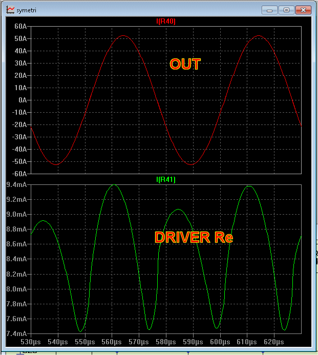

I cannot tell you for sure. I can only tell you I looked at a lot of schematics, I yet to see any drivers stage run as high current as my design of 44mA. Most runs below 30mA. If I have problem, most others will have bigger problem.
None of them would have a "problem". Even a <10ma biased class A driver
stage would always stay class A. Even at 500W into a 1R load , regardless
of "droop". (below)
As the signal approaches 0V , only the current needed for Re needs to pass.
As the excursion approaches the rail , all the drivers current flows through
the base stoppers minus what is needed for the Re (to stay in A).
At least this is the way with a true EF3 ??
In that simulation , the NPN driver emitter plotted 310ma for that exaggerated
50A , 301ma went to the NPN output base stoppers.

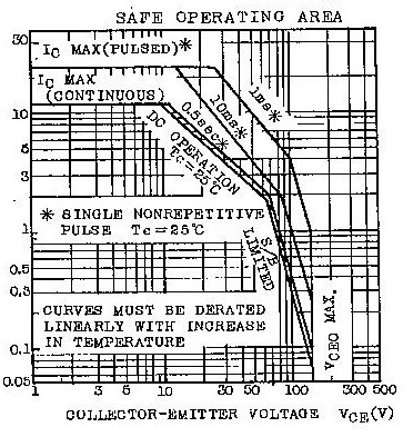

What's the point of using 100W power devices as drivers ?
fT of <15MHz at 44 mA, a TO-220 Toshiba does >40MHz at 10mA.
SOA example of a power device that's been used as a driver in a 200W serial manufacture amp, over 30MHz fT at 44mA.
(deepest excuses for the tongue in cheek part)
The devices I use for driver is 60MHz device with 160pF Cob. I want the size so it can survive even without heatsink. It is more important for me not to have them on the main heatsink so I don't get huge temp swing. At the time of design, I have no idea whether I can find a heatsink for them. So I use a huge transistor that can dissipates 2W without any heatsink. turn out I am right, I make the two drivers too close and I can only use a tiny heatsink. I doubt the arrangement I have now can handle over 3W with the tiny heatsink.
I design with very high slew rate in mind. I want to make sure I have beefy devices capable to do that easily. I have every plan of going to Ostripper's thread and work on the CFA IPS/VAS next. I am going to design a CFA IPS/VAS board next to pair up with this OPS board and expect to get over 1MHz bandwidth. That's why it never cross my mind to go 2EF.

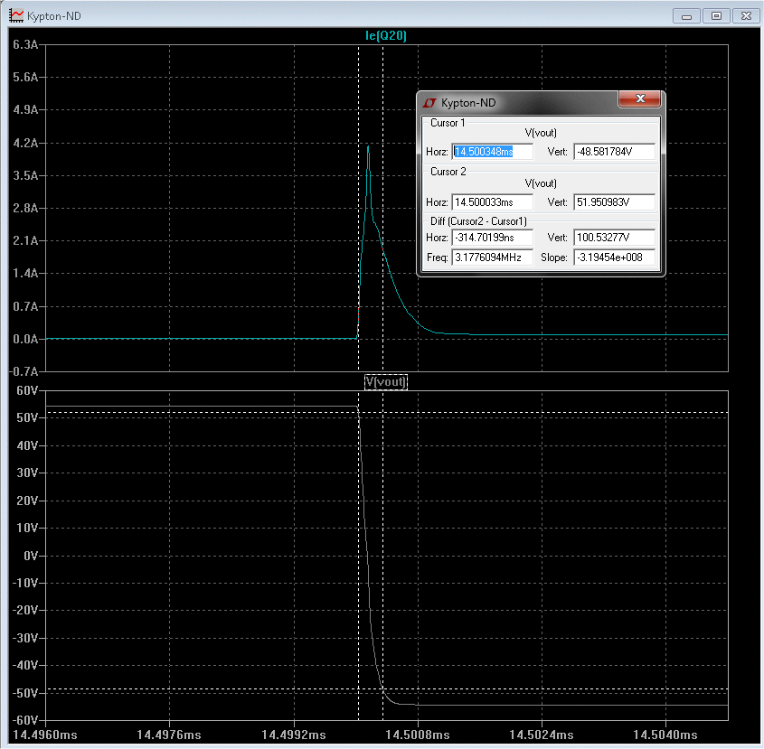

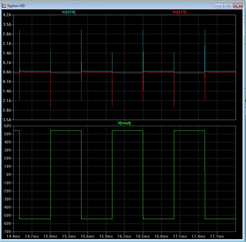

ostripper, one request for you `cos I have my doubts....
Would you apply full swing sqare wave 1KHz at input of your EF3 buffer and print the simulation screen for a driver npn or pnp emitter current on the classic 8 Ohms load and post the picture here please?
Would you apply full swing square wave 1KHz at input of your EF3 buffer and print the simulation screen for a driver npn or pnp emitter current on the classic 8 Ohms load and post the picture here please?
Look at them I spikes with a 250v/us CFA. See why I like the robust
driver pair ?
Builders have approached this level on the bench. They tried it at 20k
and most zobel's can't take it
PS - because of the spikes , hard to see the average P/N current ... It's about 80ma Ie
per device.
OS

That is what I talk about... I don`t know is that the model / simulator error or these spikes are real? Have you tried this on the scope? You could look even at the bases of the EF3 predrivers, the situation is the same. Lower rise time of the square wave generator doesn`t make the difference it is not a high SR related I think...
I run my drivers at 100mA , that is the simulator worst case I found enough ,it`s fool proof and that is with sine input and complex load. I don`t think these spikes are that realistic or every of our amps work in class AB
(below) is the fastest that EF3/big drivers can do.
The OPS is the limiting factor at 300V/us. Those toshiba's can go 50+V/us
faster.
I run my drivers at 100mA , that is the simulator worst case I found enough ,it`s fool proof and that is with sine input and complex load. I don`t think these spikes are that realistic or every of our amps work in class AB![]()
Who would play a 200W square wave through their speakers?
The predrivers see very little of this "spike" , they are not class B
like the outputs , less Cob ... as well.
The outputs are the only semi's that are actually switching.
