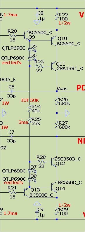

Will appreciate all comments.
Nattawa , try the "exotic" VAS I just mentioned (below).
-self clamping
-beta enhancing
-ultra high Z
-Ivas trimmable (r24)
Superior to a Hawksford in EVERY way. You don't need
to bypass Re on the VAS to get sub PPM (below 2).

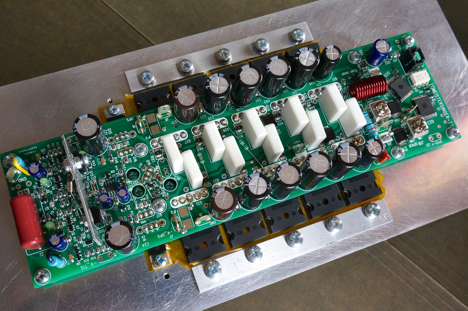

Thanks OS! PCB was ordered a year ago and prototyping is now underway. I'll definitely try your "exotics" at next revision. I've used "too many" transistors in the IPS/VAS already to bother two moreNattawa , try the "exotic" VAS I just mentioned (below).
OS
Nattawa,
I see a bunch of smd on your board but those output devices are all so close together, don't you think you will have problems with heating of the center devices with all five pair populated?
Yes, I think I might. But I decided a smallest possible feedback signal loop was priority when put to layout. I use 0.33-ohm Re at OPS, and will use phase change thermal interface material to bring the Rth C-S down as much as possible. I would also consider soldering same gender OPS transistors on a copper bar heat spreader. And in a worst case scenario that all these do not work out, I just lift 2 of the 5 pairs. It's a +/-65V rail amp after all. The PCB is having IPS-VAS-OPS, and a solid state speaker relay on it and was intended to fit on a 10-inch width X 6-inch length heat sink, I wish I could do better in placing the power transistors.

That looks REALLY sweet.
Even with "Virgin" aluminum , having the OP's close like that might make
for a "hot spot" (the middle pairs).
Chinese aluminum , I had as much as 3mv (higher bias) on the center
pairs.
That version of my OPS , I now use just 3 pair spread out double
spaced. No issue.
I'm curious whether the T-trak's have this errata ?
I spread my new slew OPS out to 5 pair across a 250mm extrusion.
My builder Still4given has his tightly packed 5 pair (and tested it for me).
He only gets about 1mV variation from middle to ends.
The smaller the heatsink the worse this little issue becomes.
OS
You can reduce the close proximity by cutting slits on the heatsink, between the transistors.

My design has 5 pairs, but I have it in a straight line, not that it's better. I have the transistor kind of tight also. But it all boils down to how much power are you trying to get out of. Also, you have not shown how the heat sink looks like, if it has long fins, nothing wrong with that.
I for one is not going for high power, I am more going for higher bias current. Even I am now going for Oliver's condition to get 26mV across the Re, I am still pushing to lower the Re and raise the current. I am planning to use +/-40V rail, BUT I am more interested to lower the rail if I can make it work with higher bias current to get more Class A power.
So the question is how much power you are going to want out of your amp? Remember even though it looks very tight, but you still have 5 pairs!!!! No point of eliminate two pairs and only use 3 pairs, just don't work them so hard. Remember, with 5 pairs, you have advantage of better SOA limitation. I never understand why people push so hard to stay with two or three pairs and worry so much about the SOA and resort to use "the" transistor.
Bottom line, if all else are equal, I'll take your tight 5 pairs over any others with two or three pairs if you want to get the same power output. You just create hot spot on the heat sink if you use less pairs.
-self clamping
-beta enhancing
-ultra high Z
The heat will come from the constant current flow of the high bias current more than playing at high power. On a smaller heat sink the heat will travel horzontally away from the end devices. This can't happen as easily for the center devices. You still need to deal with this same issue.
My point in response to him is eliminating 2 pairs is not going to make it any better if he still use the same board on the same heatsink and want the same power output and total bias. It's likely to be even worst. Of cause if he can have a bigger heatsink and do a new pcb, that's a different story.The heat will come from the constant current flow of the high bias current more than playing at high power. On a smaller heat sink the heat will travel horzontally away from the end devices. This can't happen as easily for the center devices. You still need to deal with this same issue.
If he can live with lower total bias and lower power output, he can do the same thing with 5 pairs, no need to remove any of them.
It's really no point of talking about this as he did not specify the power dissipation requirement. We don't know what he plans to bias at.

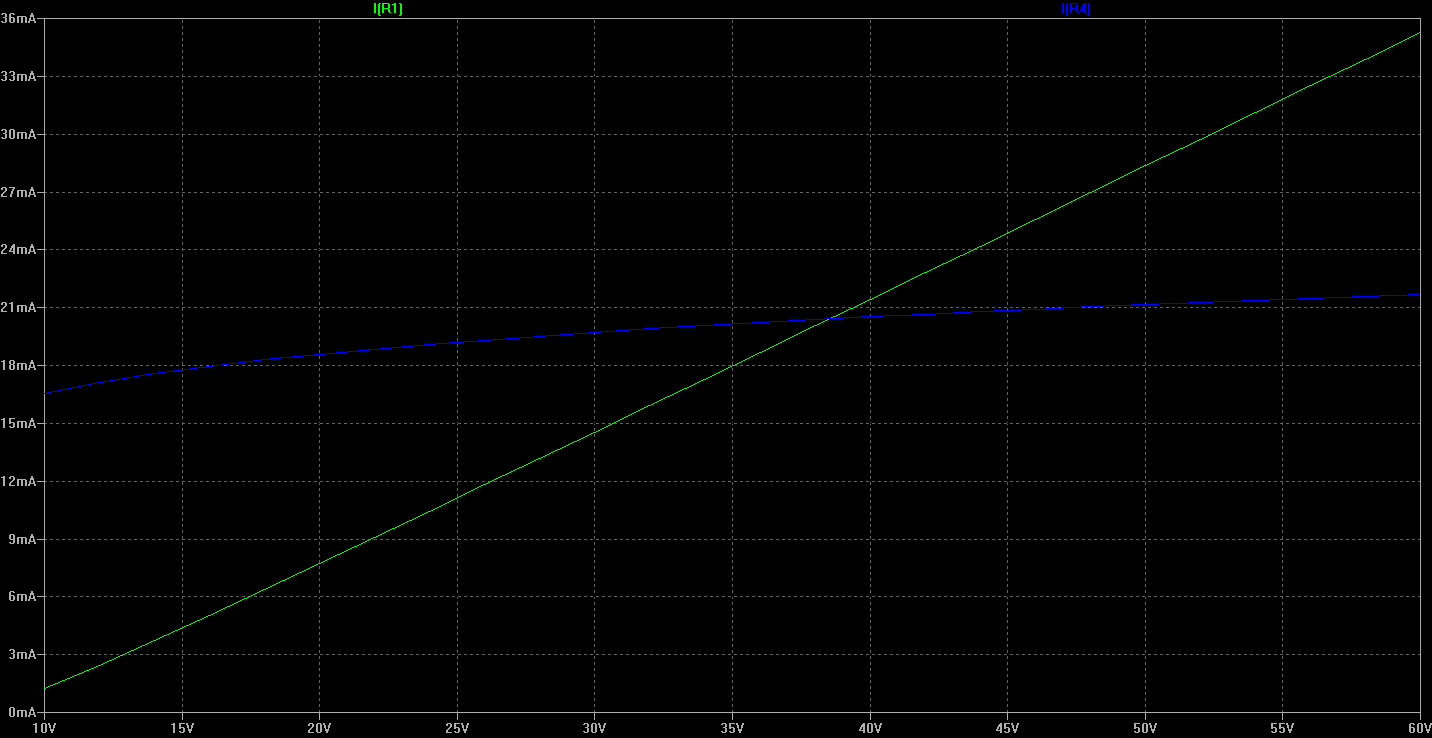

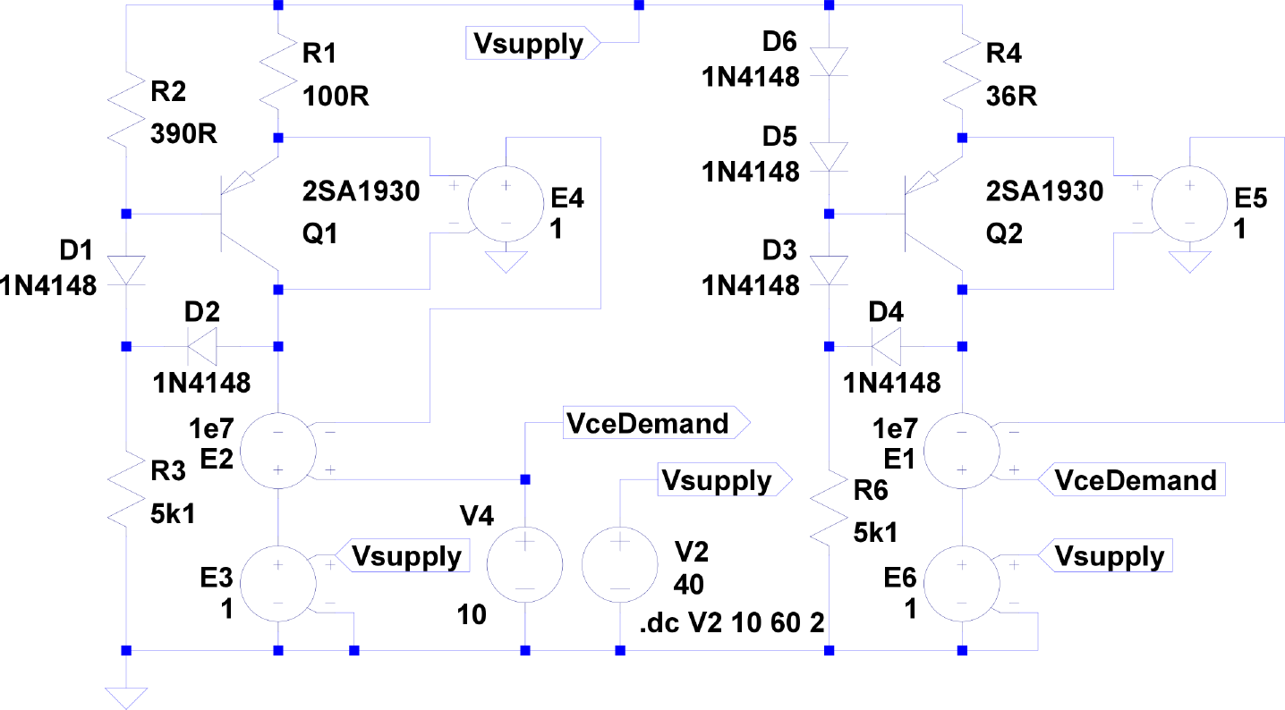

That is very small because it's being divided by R1/(R1+R3). More importantly the current is driving into the emitter of the pre-driver Q8 which r'e = 2.6ohm. It's not going to make a difference.
Please see attached schematic and graph comparing your arrangement to a “more conventional” arrangement. The setup here tests the current source current as the power rail varies from 10 to 60 V. Vce of the BJT is kept constant at 10 V for a fairer comparison. Green line is output current of your current source, blue line is output current of conventional design.
For those that have built diamond buffers - what do you all think? Do the current sources need to be “constant” current sources or is Alan’s arrangement just fine?
