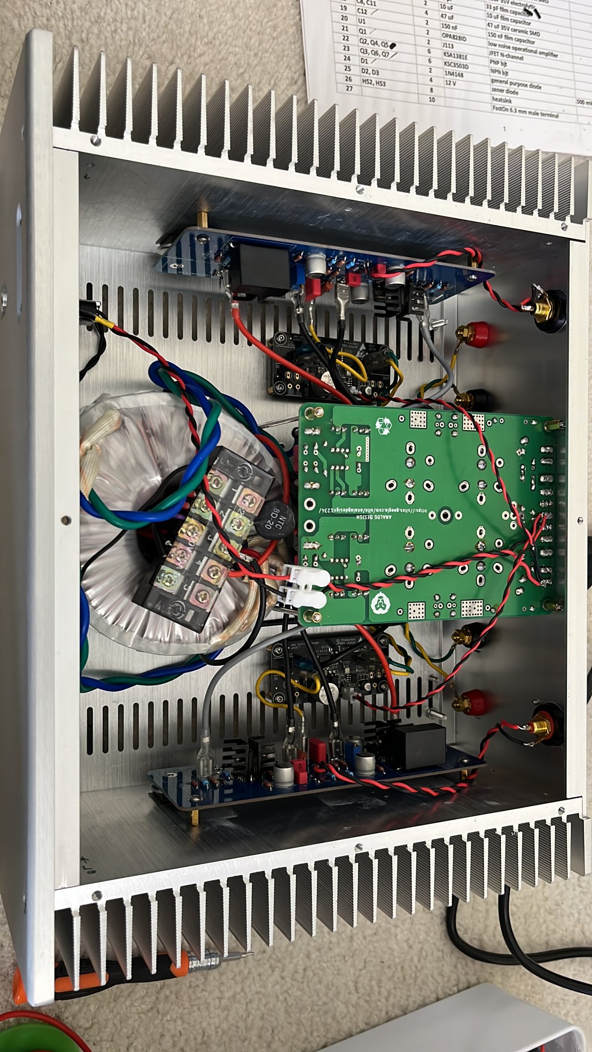

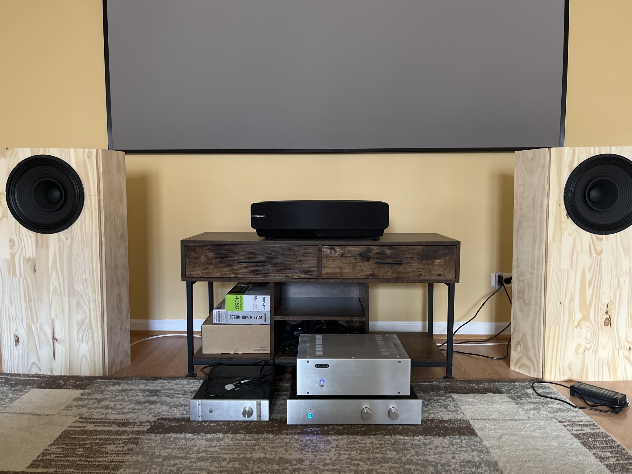

I have total of 22mF each cap total of 4 caps exact same value. Single psu for both the channels. As I type the amp is making beautiful music with my Fane open baffle setup paired with FE22 preamp 👌

With 100 dB/1W, if you have any hum with no signal, replace plain twisted wire at input with shielded cable.
No hum issues at all as followed your grounding wiring on this psu

and works perfect and I hear a very slight hiss when I am very close to the speakers otherwise dead silent 👍
Using XRK’s speaker protection mono modules also powered by the same psu. Used CL60 as soft start and one more CL60 for psu ground isolation all tied to the star point on the chassis bottom plate.
Thanks for that, so to aim at the 17.5 to 18VDC at the amp under load, it looks like the optimum AC secondary voltage is 14 to 15VAC (300VA should be more than big enough). Just as well you are using the prasi active rectifier CRC board, with normal diode bridge your DC volts would be a volt or so lower again. I am going for a 15VAC dual secondary transformer, and will add extra psu capacitance after the CRC board dual mono with 100,000uF per rail per channel - 44,000uF per rail on the CRC and an extra 56,000UF per rail chassis mount cap. Hopefully that will be beefy enough. My chassis will be bigger than yours shown in the photo. Will also run at 1.2 ADC bias current.

I was curious if you would hear a bit of hum at the speaker using a shared psu for both channels, excellent news. (Nice layout Tombo!)
I noticed the speaker woofer would flex with a 'bump' sound during the first second of power up in my testing setup, using the SSR DC protection boards with delayed signal pass-through would eliminate that.
Off topic: what Fane drivers are those?
