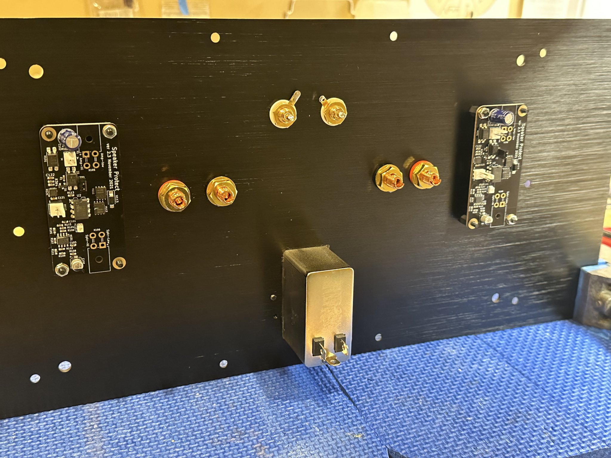

I would say that is the Soft Start pcb feeding mains to the transformer.

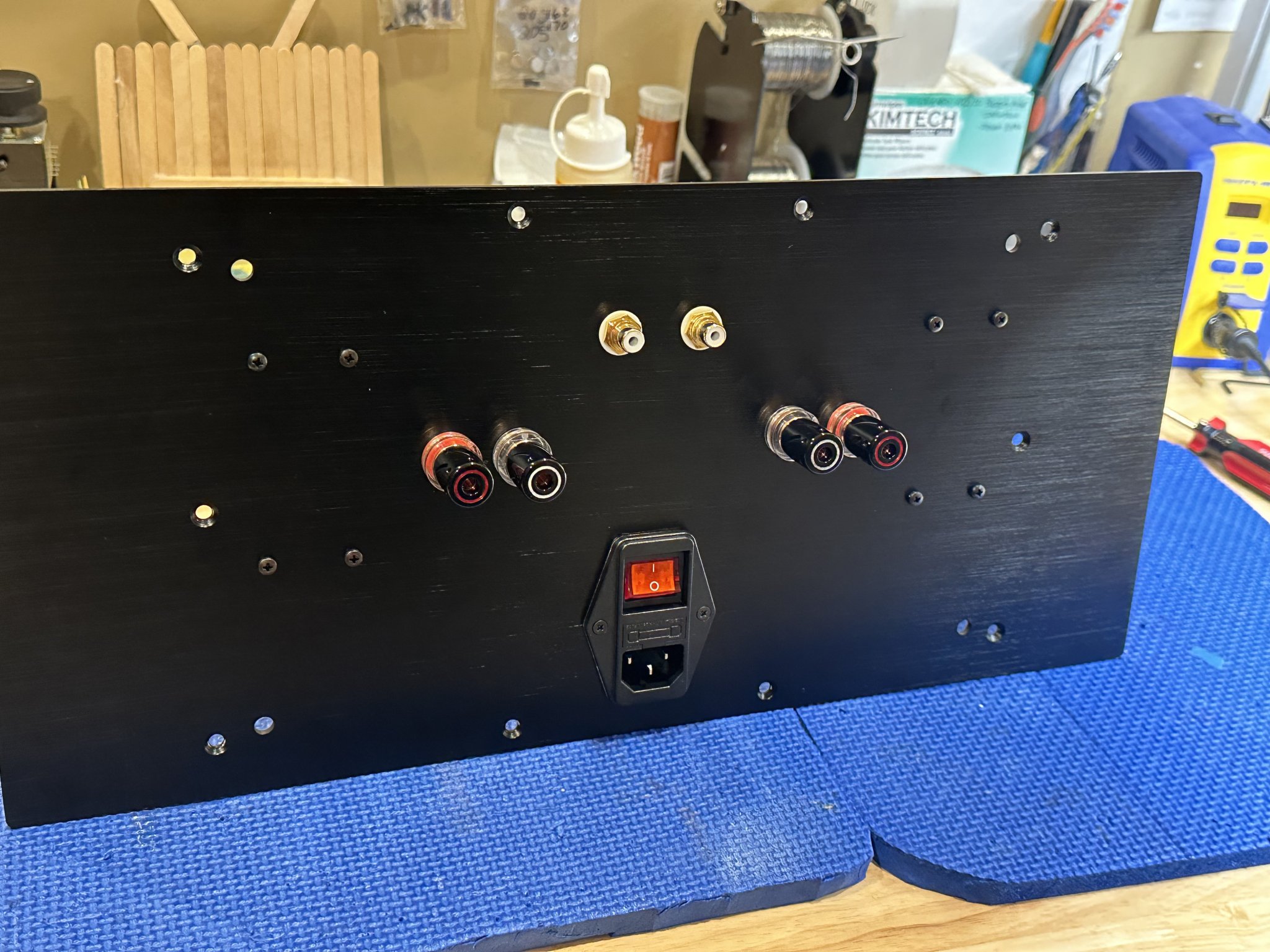

Lovely work as usual Vunce. What is the 'high voltage ' module please? Looks like an MJ design but don't remember seeing that one.

I doubt that observation of bass without punch has anything to do with JFETs. It is rather the whole amplifier design. Bass definition could be affected by frequency response and damping factor. Loudspeaker excursion control in the LF range is more controlled by box design than by DF. There is also a counterintuitive effect that amplifier with a very low DF and certain loudspeaker boxes, could have more bass as LF driver is not well controlled.
Anyway, this amplifier has absolutely ridiculous DF of 1300 in the LF region. I had to arrange a special measurement setup to be able to precisely measure that.
Mind you, above DF of 200, any measurable effects, even with loudspeakers impedance dipping very low, are far beyond audibility.
Now, a short answer to your question.
Bass is very well defined. After moving test amplifier from improvised to final build, it was like subwoofer was added.
