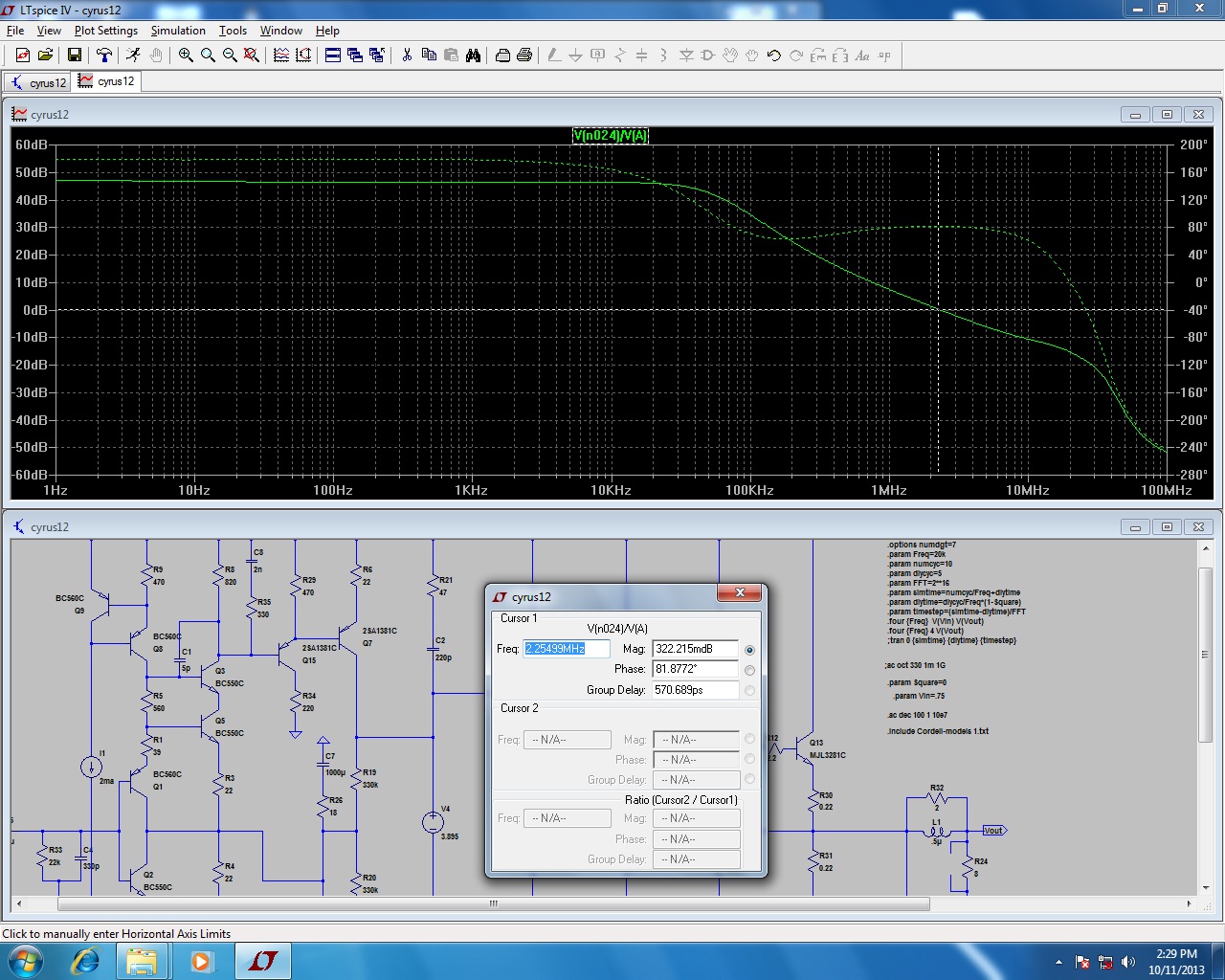

You are still not providing any authoritative reference about those commercial amplifiers with ULGF or 6MHz. Interesting and twisted way to protect the intellectual property: you are saying you provided the schematic, but you are not disclosing the manufacturers. Usually it's the other way around.
The Cyrus amps that use current feedback have ULGF under 1MHz. Check for example the attachment (it's in the public domain) and note the (no less than) 300pF shunt compensation. If you are aware of any Cyrus amp with an ULGF > 3MHz, please post a reference to the schematic.
I didnt provide the schematic I provided simplified schematic only, there are some details missing and the product doesnt use an output inductor either. I used it as not to show how stability is achieved into any speaker load without it. Seems that old cyrus 3 were thinking along the same lines. There is also a discrete servo mechanism used.

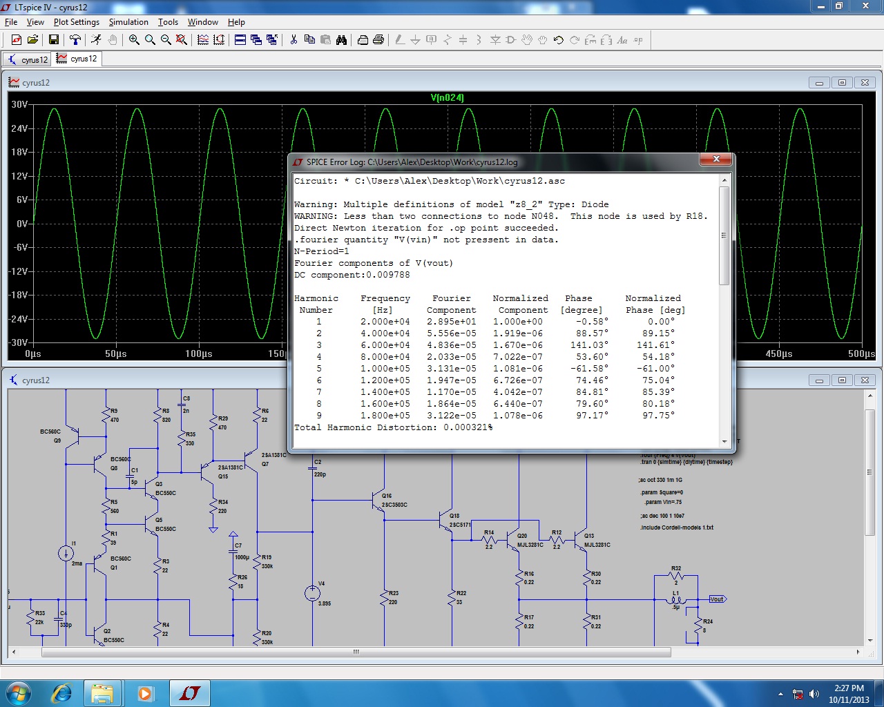

I have actually simmed the cyrus 3, it shows ULGF above 2 MHZ so I dont know where you got your figures from. But try some later models, I will not provide schematics though.
These amps were single input device CFAs and begun to be replaced by differential input stages circa 1970 giving them much better overall performances. Then the push-pull input CFA topology appeared (circa 1990 ?) but did not overcome the market.
As far as I recall, the advantages quoted for CFAs through this thread and some others only concerned those having a push-pull input.
There are not many solid state amps having a single transistor input enjoying high reputation : Quad Current Dumping series, Nytech, but what else ? (the Renardson Mosfet amp can also be listed but it has a Sziklai pair input giving it exceptional performances).
Push pull CFA topology amplifiers were in production by Pioneer in 1978, the MZ1. It was soon followed by Harmon Kardon XX who most probably copied the idea as the design is very much the same. Pioneer filed patents but these were delayed for 5 years from their filing. Harmon Kardon fans claim it is the best amp ever produced by the company and second hand examples go for more money than some expensive so called modern high end amps.

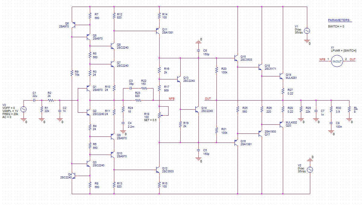

I would be very curious about how manso simulated the cyrus amp, as none of the critical active devices (input stage, VAS/TIS, output stage) seem to have spice models. However, one doesn't need any simulation to estimate the unity (open loop) gain frequency, and then the ULGF.
A peek at the 2SA1038 and 2SC2389 ROHM data sheets will reveal the rather low Early voltage of the 2SA1038 device: anywhere between 100 and 150V.
Ignore for the moment C119/C120 effect (they certainly won't increase the bandwidth) and look at the VAS only. Assuming the 2SA1038 is controlling the impedance at the VAS output (that is, ignoring the 2SC2389 output impedance, the output stage input impedance and the output stage input capacitance, all very rough approximations, but definitely having a bandwidth lowering effect), the C107 and C108 (to a total of 300pF) see an impedance of VA/Ic = 150V/3mA = 50k.
Something which is called in EE the short/open time constant method tells that the bandwidth is defined by the sum of all time constants in the circuit, calculated individually, while the other are short/open. As we ignored anything else except the VAS output impedance and the 300pF capacitance, these are rendering a time constant of 50k*300pF=15uS
Further, we need the open loop gain. Very hard to estimate without having an output stage model, but assume again an extremely conservative model that considers the TIS/VAS load defined by the TIS/VAS output impedance. So we have the input stage gain of R111/R109 multiplied by the TIS/VAS gain of gm*VA/Ic~40*VA=6000 (the effect of the TIS/VAS degeneration was also ignored, it actually lowers the gain). This make for an open loop gain of 240,000 or about 107dB. Subtract the closed loop gain (34dB) and you'll get a LF loop gain of 73dB. Combined with the open loop bandwidth, this renders an ULGF of 2.5MHz.
Now recap the approximations we did:
- Ignored the C319/C320 effect (lowering the bandwidth)
- Ignored the output stage input impedance (lowering the open loop gain)
- Ignored the output stage input capacitance (lowering the bandwidth)
- Ignored the TIS/VAS degeneration (lowering the open loop gain)
- Ignored the output impedance of the other TIS/VAS half (lowering the bandwidth and the open loop gain).
If the devices models would be available and a more exact determination would be possible, then make no mistake - the ULGF will be much lower than the above very rough calculation. Hence my estimation of 1MHz.
Now you know where I got the number. I can't hope you'll appreciate the lecture, though.

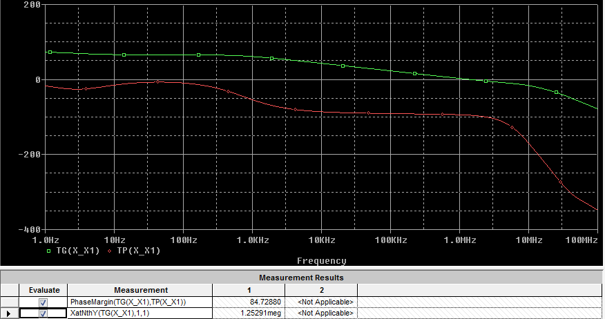

And because I was at it, I did a quick simulation, using the best devices I had models from (2SA970/2SC2240 in the input stage, 2SA1381/2SC3503 (with Early voltages close to 800V) in the VAS, same as pre-drivers, 2SC5171/2SA1930 (with Ft=200 MHz) as drivers, MJL4281/MJL4302 (with Ft=30MHz) as outputs), the results are attached.
As expected, the ULGF is 1.25MHz (compared to 2.5MHz above) and it looks very stable. LF loop gain is 65dB (compared to 73dB estimated above). I have no doubts that the inferior devices used in the original design (to mention only the output devices with Ft=20MHz and the VAS devices with 150V Early voltage) will bring the ULGF at or under 1MHz, and this is even before considering the effect of C119/C120 (of unknown value).
Bottom line, this Cyrus CFA has an ULGF at or under 1MHz (which is typical for commercial designs). I am still waiting (but not holding my breath) for an example of commercial amp with an ULGF of 3MHz, 6MHz or above.

Maybe you dont have models for the transistors used but I do and yes they are available. Im will sell them to you if you interested. They are not cheap at all but I as user and the company that produced them can gaurantee their conformity to the highest level. You just need to supply the batch production number for best model matching.
As I dont trust simulation that much I repeated using a different simulation program, Multisim. ULGF 2.3 Mhz. Not much in it compaired to LT.
I wonder how you can be as far off as 1.25 Mhz ??
