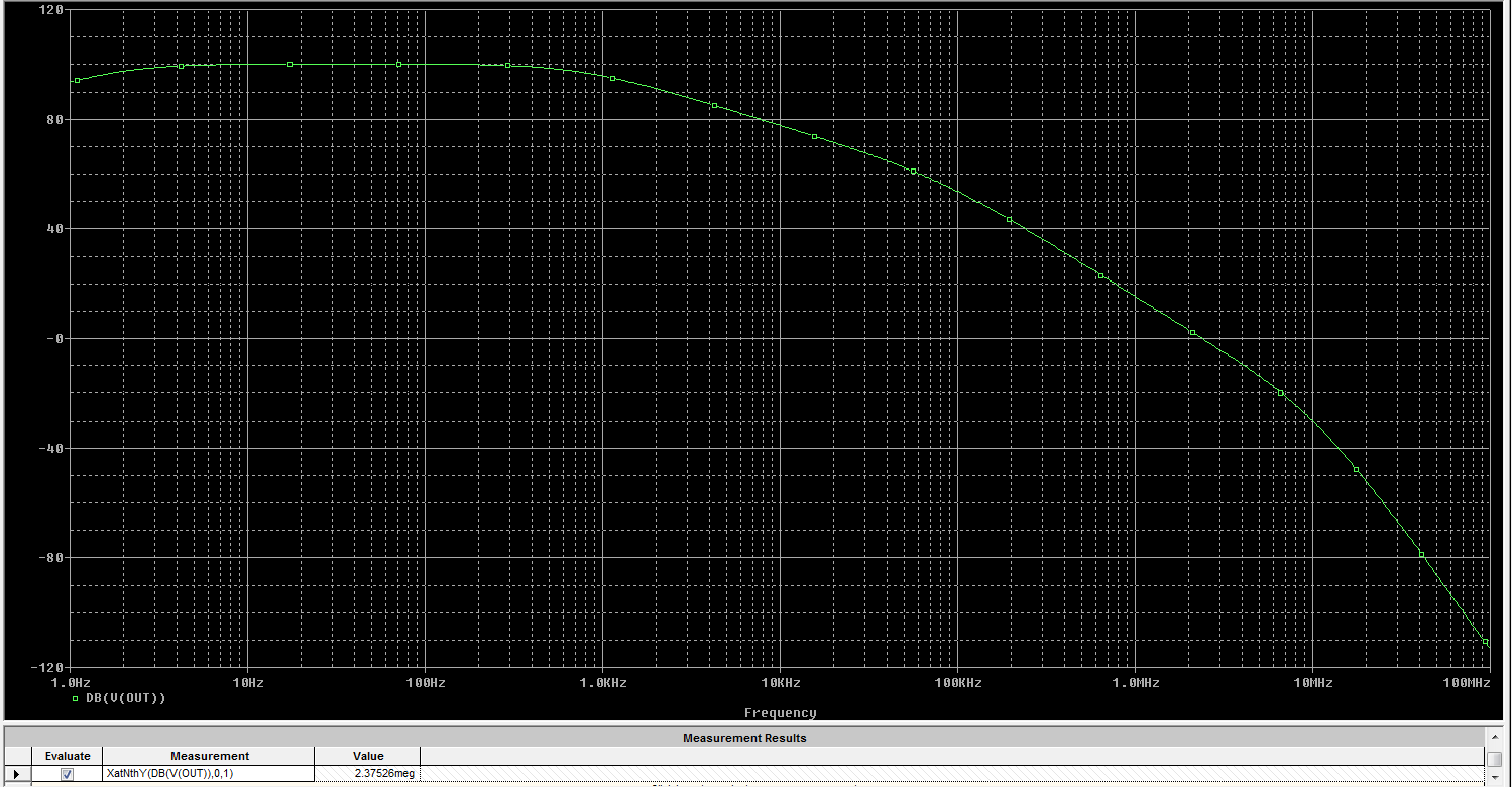

Just to rekindle my memory I simmed the amp as well, as expected the ULGF was 2.4 Mhz, actually very close to 2.5MHZ.
ULGF 2.3 Mhz. Not much in it compaired to LT.
I wonder how you can be as far off as 1.25 Mhz ?? :cannotbe:
Give me a day or two and Ill post my results.

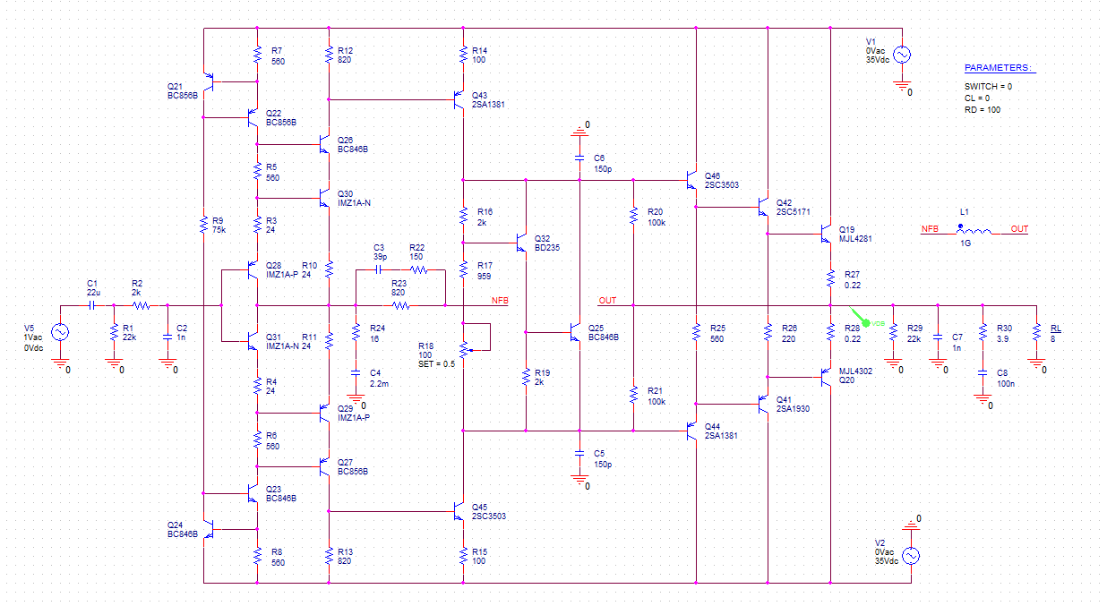

Sorry Wahab, misunderstanding, we want to establish the ULGF of the cyrus as per schematic. So Walys 100ohm is correct. We talking here of a difference of more than 1MHZ.
Wich Cyrus.?.Is there a schematic that was posted.?.
Edit : Actualy Waly s schematic is the one he posted earlier in PDF ,
with said 100R i get 1.5MHz ULGF , i ll recheck with the models
used in the actual schematic but i dont think it will make
a big difference unless i missed something.

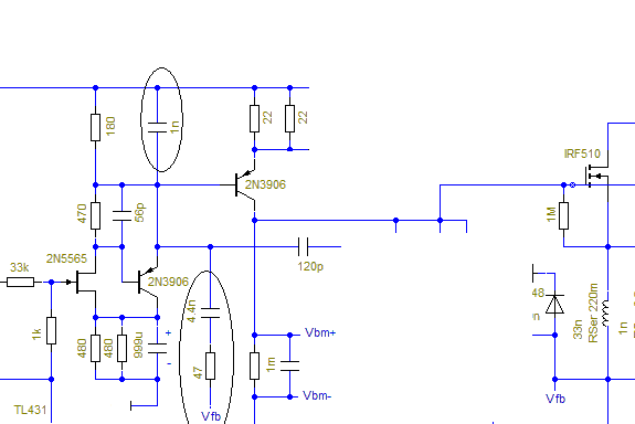

I've proposed the 'simple CFA' like VSSA and my #500 and pointed out that in most cases, this will usually give up to 3dB better Loop Gain and hence THD .. as well as being simpler. The disadvantage is evil electrolytics.
What are our other choices, in regard with DC offset ?
Servo ?
I think It brings complexity and its own evils as well. At least, In VSSA, the lytic is not directly in the signal path and has a limited action on the overall gain as it reduce only the DC input gain.
Well, we could try higher values to minimize the group delay error...
Any idea about the way can sound supercaps here ?
1- It is in the feedback path(and that is signal path) 2-and if can do without it's much better.
1- It is in // with the CCS, so reduced influence, means only on the little gain range of the input stage, right ?
If this cap has infinite impedance, or is removed, the input stage will still have a 1 gain, right ?
Not as bad as the cap in the ground return of my amp feedback network.
2- Yes, of course.

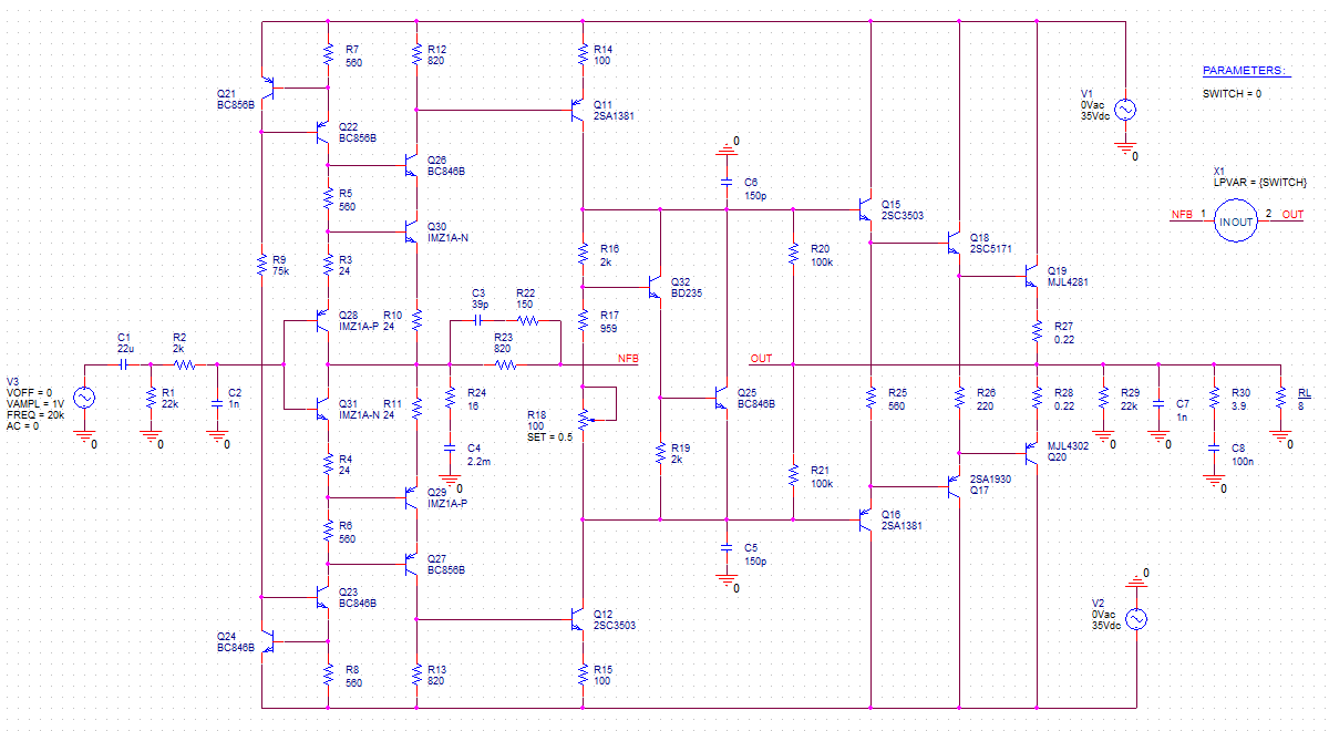

Yes, I captured the schematic in the original Cyrus PDF I posted here. 1.5MHz ULGF sounds more credible. If you can get the models for the devices in the original schematic (other than the IMZ1A PNP/NPN dual, which is available on the Rohm web site), let me know. I would expect them to have a significant impact in lowering the ULGF (for the reasons I already mentioned).
I re-did the simulation using the IMZ1A models and the BC/BD per the original schematic. Unfortunately the models for the VAS, pre-drivers, drivers and output devices are not available for free. I cannot afford to pay manso for the models (thank you for the offer, though), so I used the same devices as before (again, according to the data sheets, all much better in performance compared to the originals).
This time I got 1.3MHz ULGF, that is about the same as in the previous simulation (1.25MHz). Not unexpected, as the input devices do not have a huge impact on the ULGF - the VAS device and the drivers/outputs do. This time I included the log scale grid in the GP plot, for manso's reading convenience.
EDIT: BTW, Bonsai is correct. Without an output inductor, the (local) stability of the output triple in capacitive loads is dangerously low: only 4 degrees phase margin for a 100nF load (see attachment).
I would though expect this phase margin to be larger for the original devices, as they are significantly slower than the ones I used in this simulation exercise.

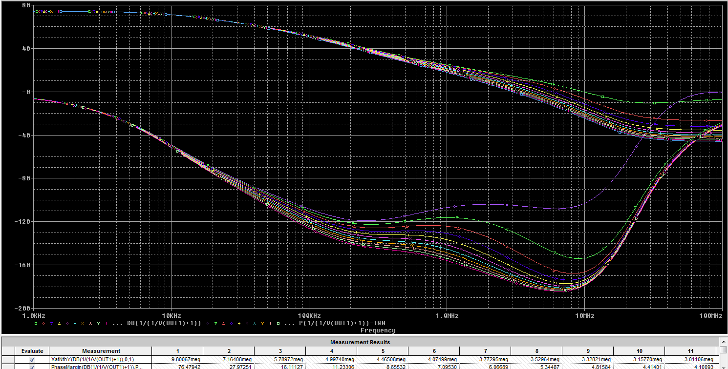

I think I know what's happening here... Manso (and he's not alone in this confusion) is looking in simulation at the open loop gain, which indeed has a crossover frequency of about 2.4MHz (with the best devices/models).
However, this has little to do with what really matters (for distortions, stability, etc...) which are the loop gain and the Unity Loop Gain Frequency (which is 1.3MHz). Only at low frequencies the difference is loop gain = open loop gain - closed loop gain. (which is also obvious if you visually compare the graph attached to this post to the previous, 66dB (LF loop gain) =100dB (LF open loop gain) - 34dB (LF closed loop gain).
See the attachment for the open loop gain results.
