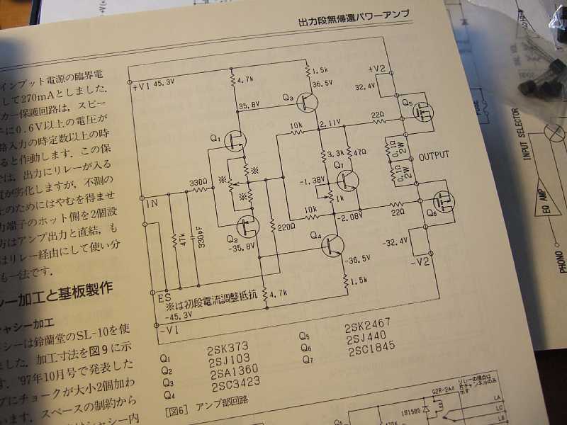

BTW , check this schematic too , it is about symmetric & GNFB free Amp with very interesting solution of VAS stage compensation .
Regards !

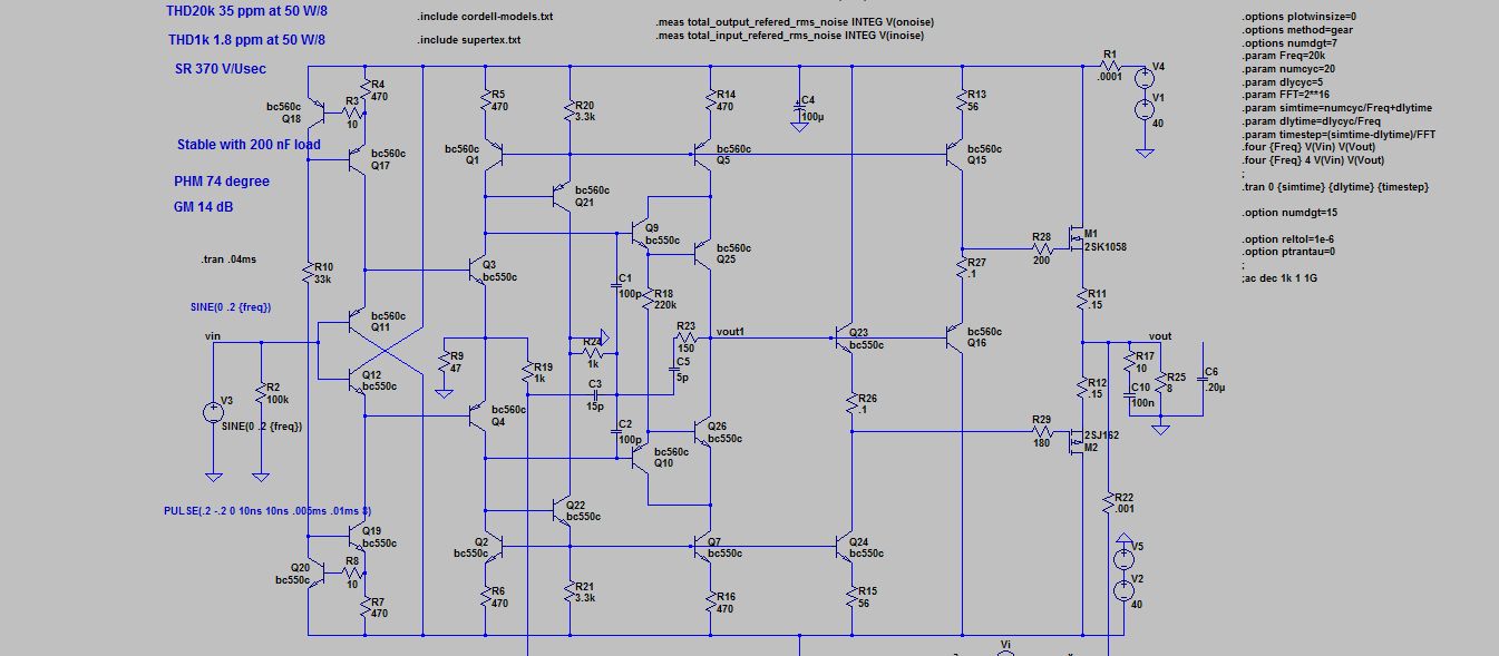

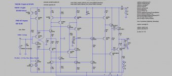

Lateral MOSFET OPS.
This one is with a strange compensation and it's very stable even up to 200 nF without output inductor. With all my lateral mosfer OPS distortion is much higher if OPS is not included in compensation circle, even if it is distortion at 20 kHz is not something to write home about.
I am not sure if those distortion result are any close to real life amp.
I those last two CFA amp I am back to the current conveyor used in my GainWire pre amp, just in this case it's diamond but not with Baxandall pairs. No big difference in both cases.
BR Damir
