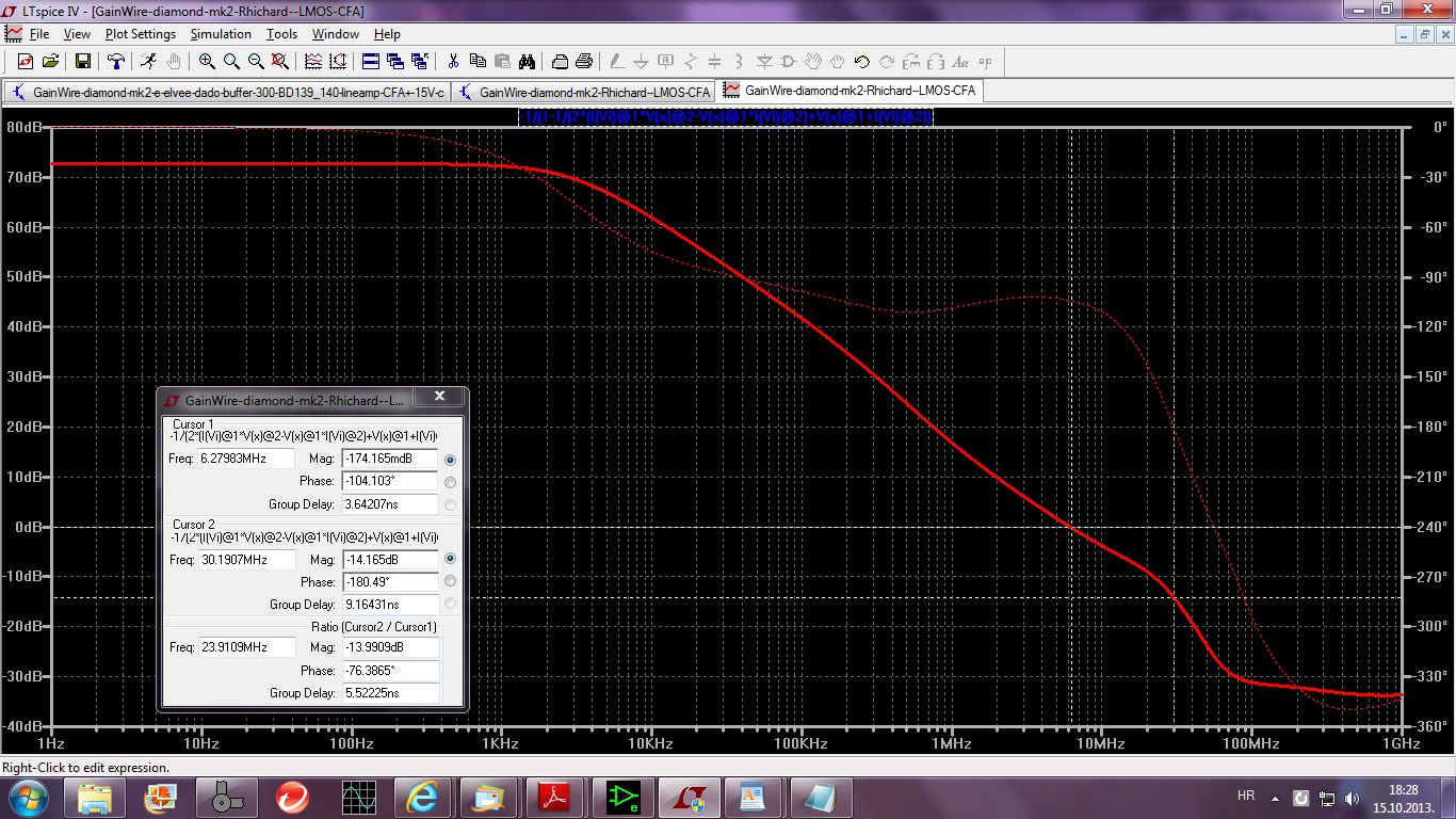

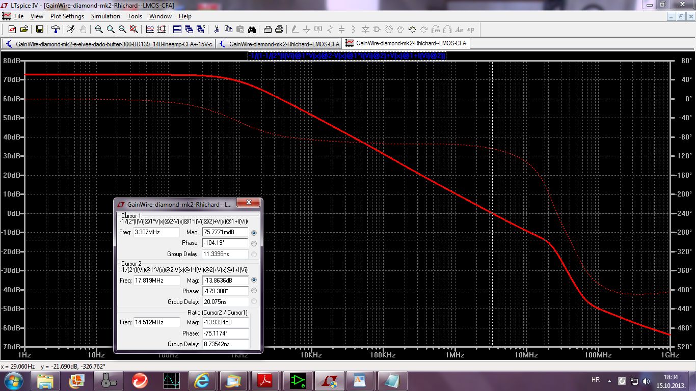

Exactly proportional to the 1kHz, means the open loop gain is yet decreasing of 6dB/oct at 1kHz ?
Or just an effect of those strange local comps ?
Can-you publish FFTs, please ?
Not exactly 6dB/oct, a bit steeper and moved to the higher frequences.
Yes, of course. But most of the excess phase will be from the slow outputs and drivers so I would be surprised if the omission of just the comparatively fast IPS means you can safely quadruple the ULGF.

However, I would still like a good way to look at the 'main loop' for CFAs so please don't stop working on this.
Doing more work, my initial thought that your 'Tian probe between OPS and the feedback take-offs' is looking at the VAS+OPS+Cherry 'inner loop' seems to be not quite true though it is a useful alternative view.
So I'm back to square one, lacking both Tian tools which I used to get the evil ULGF & margins in my #499 example on this thread. :mad:

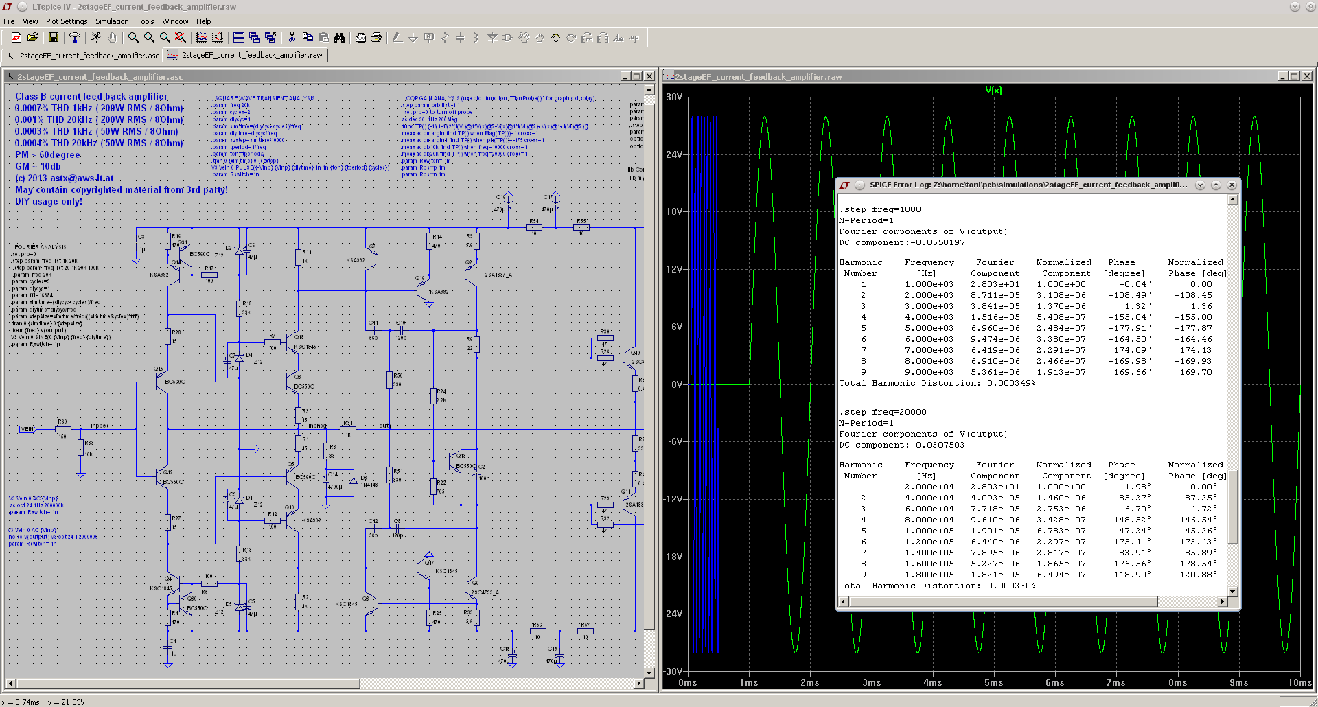

my 0.02: 2stageEF as current feedback amplifier variant 200W8R
Attached my CFA variant using 2stageEF OPS.
Gain > 30x
GM ~ 60 degree
PM ~ 10 db
THD20k@200W@8R
0.001%
THD20k@50W@8R
0.0003%
BR, Toni

Awsome!
A beginer's question: The input transistors, Q15 and Q12, seem to be operating in quasi-saturation zone --- they have only slightly over 0.6V across C-E. Can they be somehow made work in a higher Vce? Will that make any improvement to THD and other performance? Thanks.

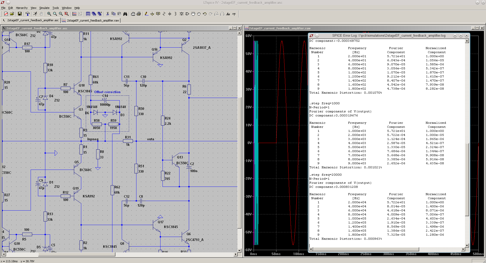

Update:
  • LF distortions are terrible high with C14/4700µF. Setting C14 to 100000µF helps a lot.
  • Offset is about 30 - 40mV - for me too high. Without C14 offset would be about 200mV - inacceptable.
Attached an offset compensation variant. Question to our CFA gurus: is this a good idea to correct offset this way? LF Distortions maybe acceptable (10ppm) at full power.
Br, Toni

Update:
1- Nothing new, the only difference with VFA is the high impedance of the feedback LTP's inputs. This makes the amp a lot sensible to the quality of the lytic, sonic side. The only alternative is a servo to keep offset stable with temp changes. A good choice with CFA, on my point of view with its low impedances. A little more complicated, but less expensive than a good big lytic, anyway.
btw: offset have to be <5mv in all circumstances. No way to adjust-it by the currents in your CCS ?
