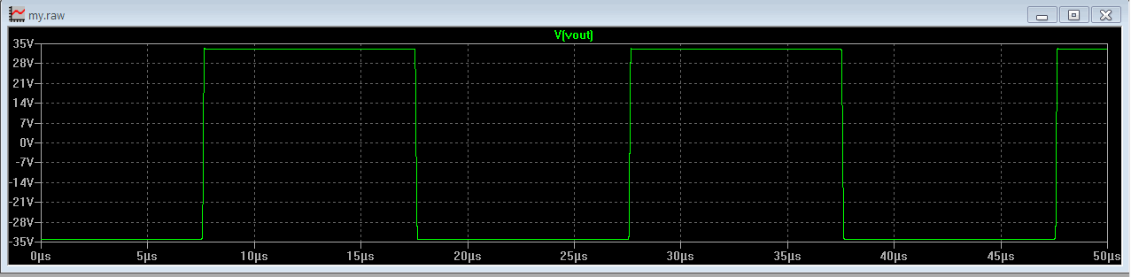

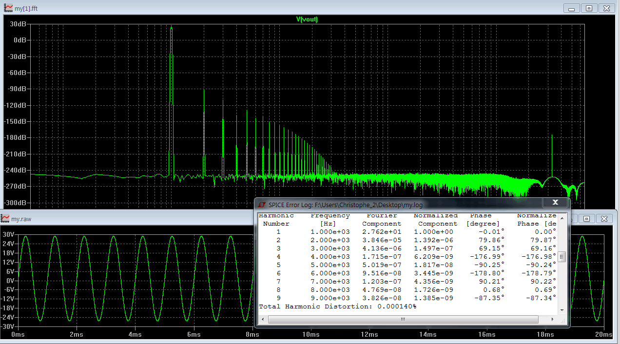

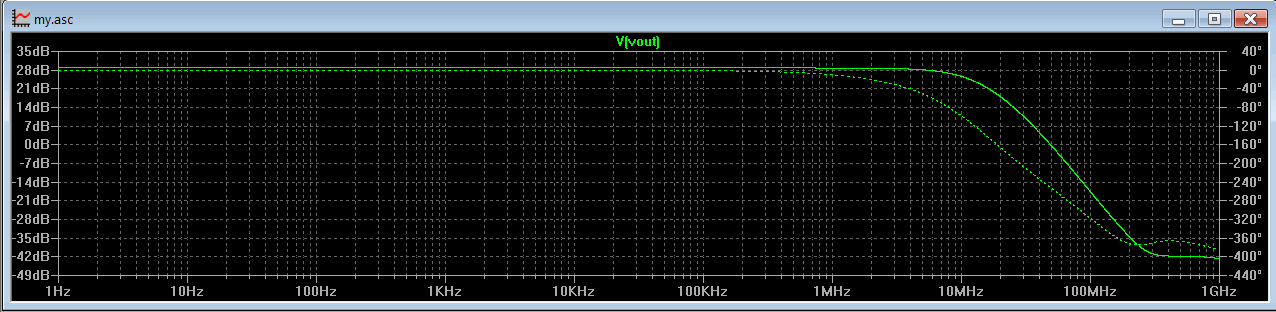

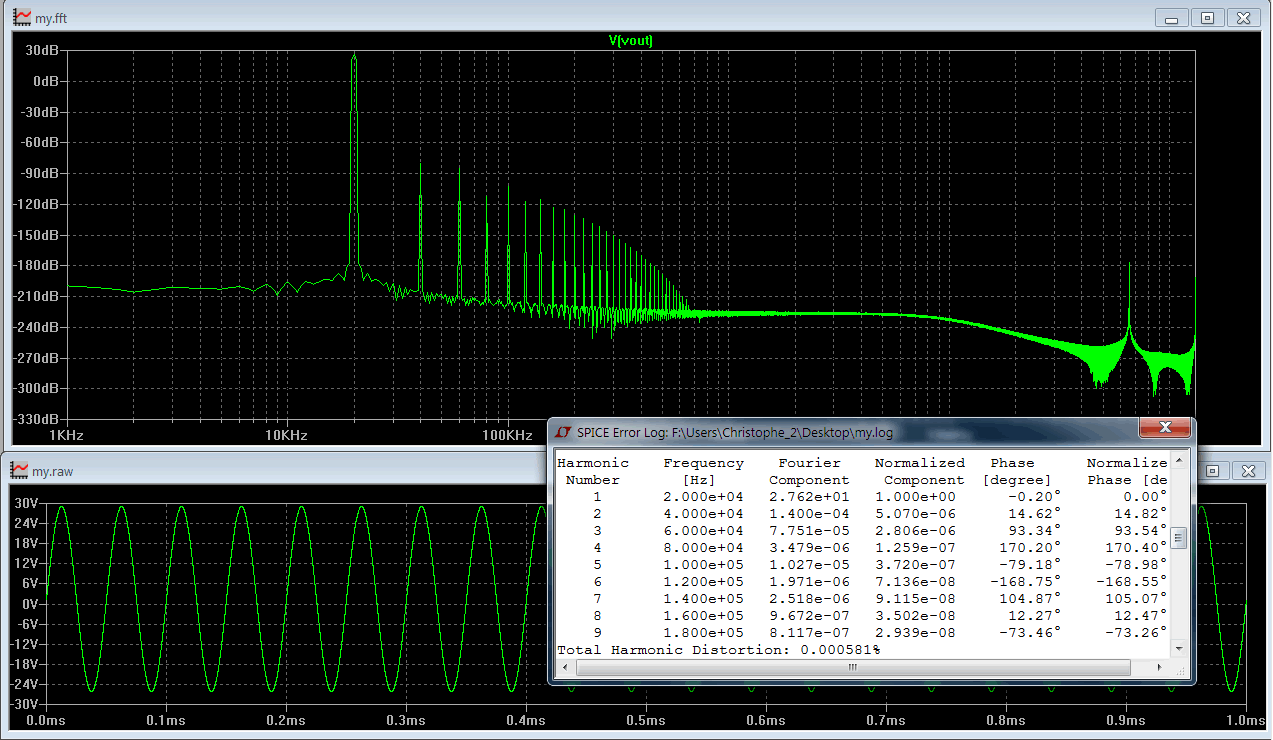

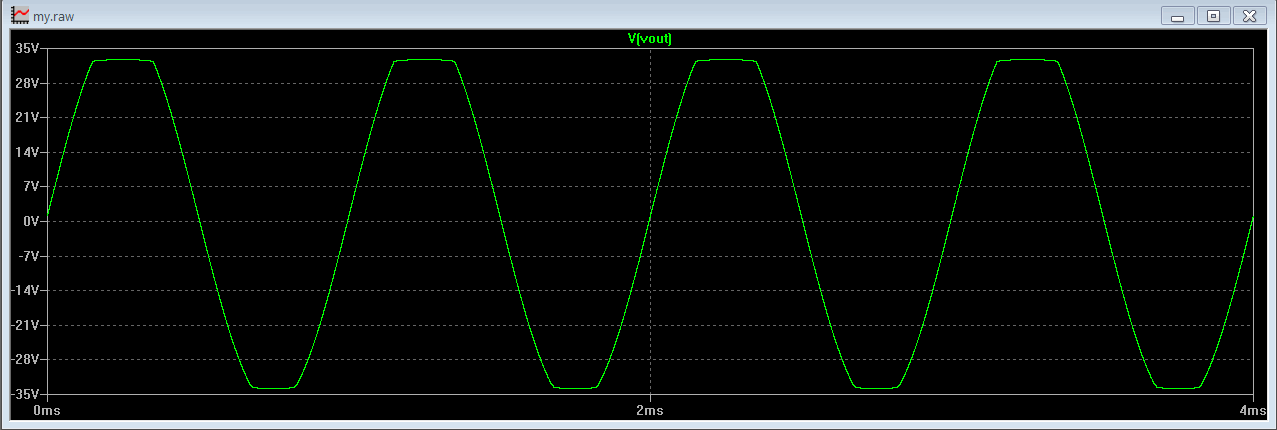

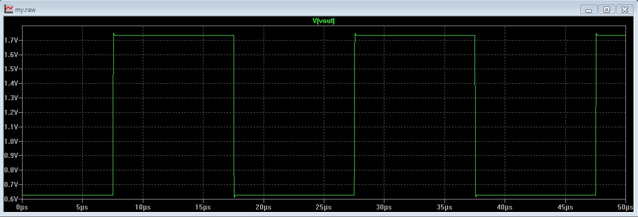

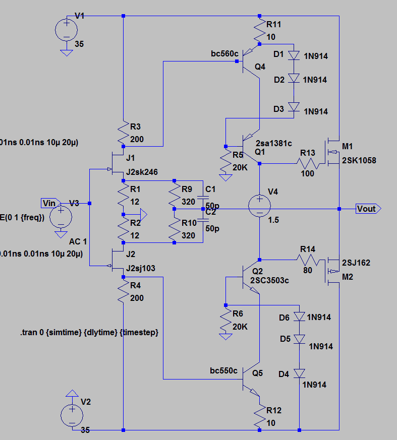

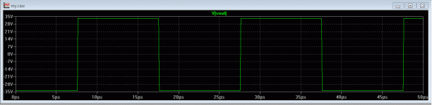

From the the idea of Belaji, what do you think of this, with only 8 tranies, a simple symetrical Jfet input and no miller or such:
Can you easily scale it up in power and keep performance? ...say 200-250W/8 level?
What results do you get when you replace R9 and R10 with one resistor and connect that one resistor to the junction of R1 and R2 -- with the ground at that junction removed and replaced by resistor to ground? can you SIM and compare?
-RNM
Hi, Richard,
More voltage, I believe yes, those series of Jfets are high voltage (up to 200V). The ones used are 50V.
Same perf ? We will see 🙂
You can imagine it was my first schematic ;-) No good.
(i am not such a VSSA sectarian, i would prefer one path than 2 ;-)

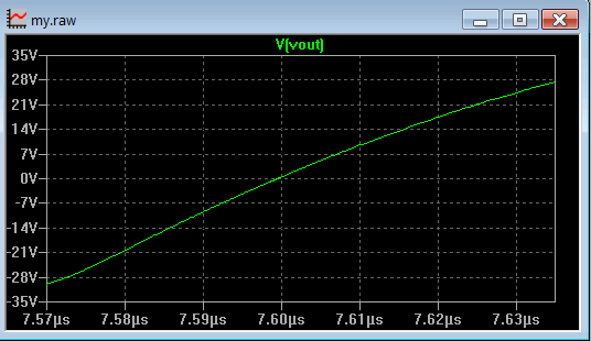

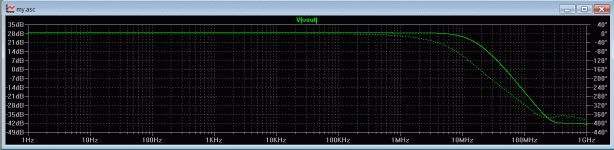

It looks quite promising, hey ? Fast and Healthy in sim. Amazed by the HF behavior, so clean.

Well, at least, one thing is interesting in my ridiculous mistake -i'm still laughing- it is the good phase behavior of Jfets inputs compared to BJT (noticed several times) with one added pole to the 3 basic stages.
Probably something to dig if some of you can deal with distortion. ( I'm not as experienced with Jfets than SIR John Curl. ;-)

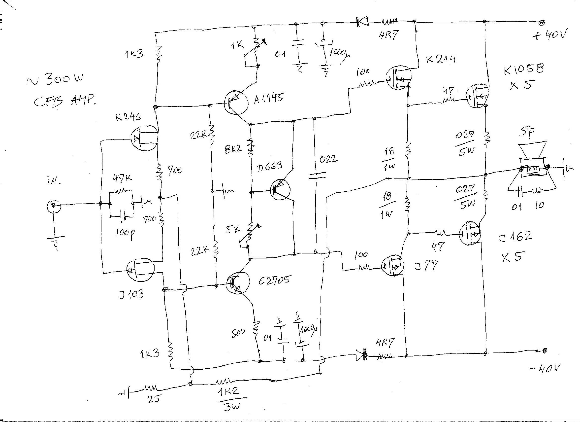

What do you think about performance of this CFB Amp ?
Will try to sim-it. But, as you have seen, i'm not the best at this ;-)
Got any performance results?
Preferably 'real life' but SPICE will do to compare with our old fogey 'dreams'. Complete circuit please so we can have a play too.

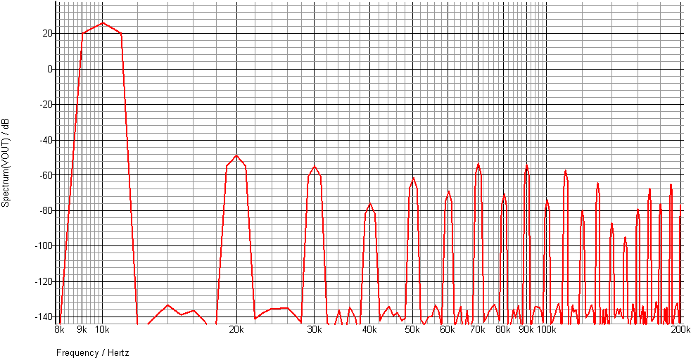

I posted the sim result of N2 here: http://www.diyaudio.com/forums/soli...ts-your-opinions-post3393033.html#post3393033

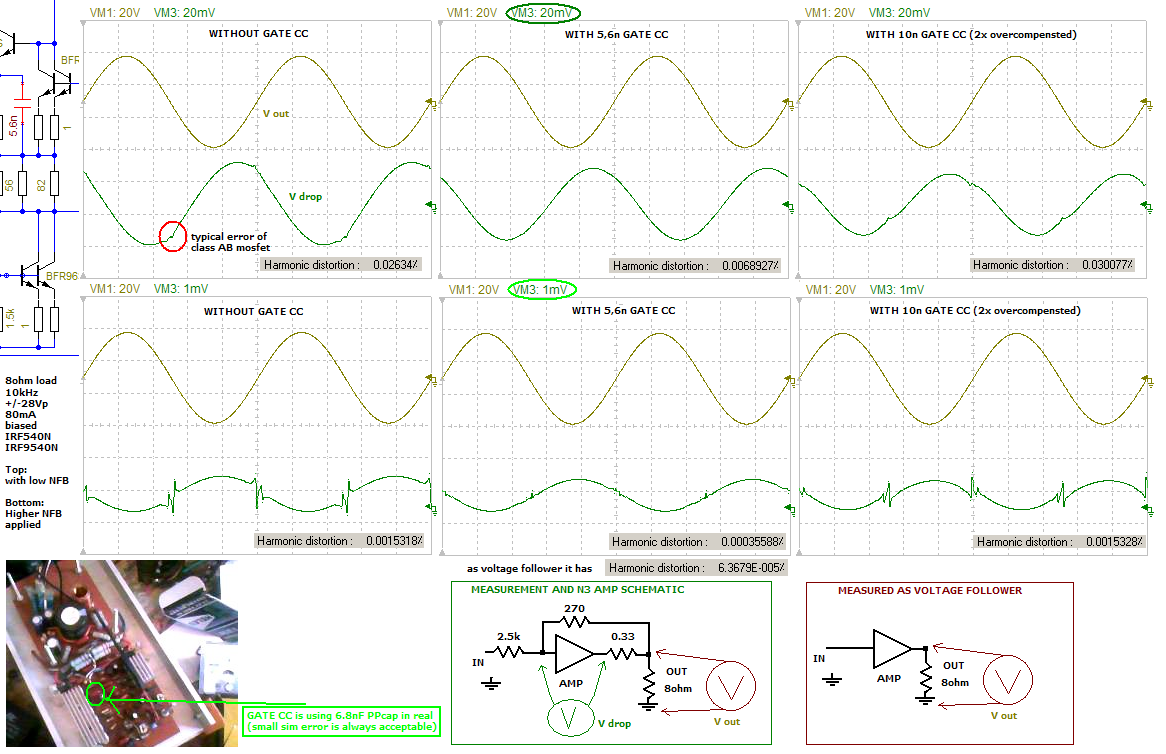

with this picture: http://www.diyaudio.com/forums/atta...-douglas-self-wants-your-opinions-gate-cc.png

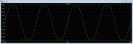

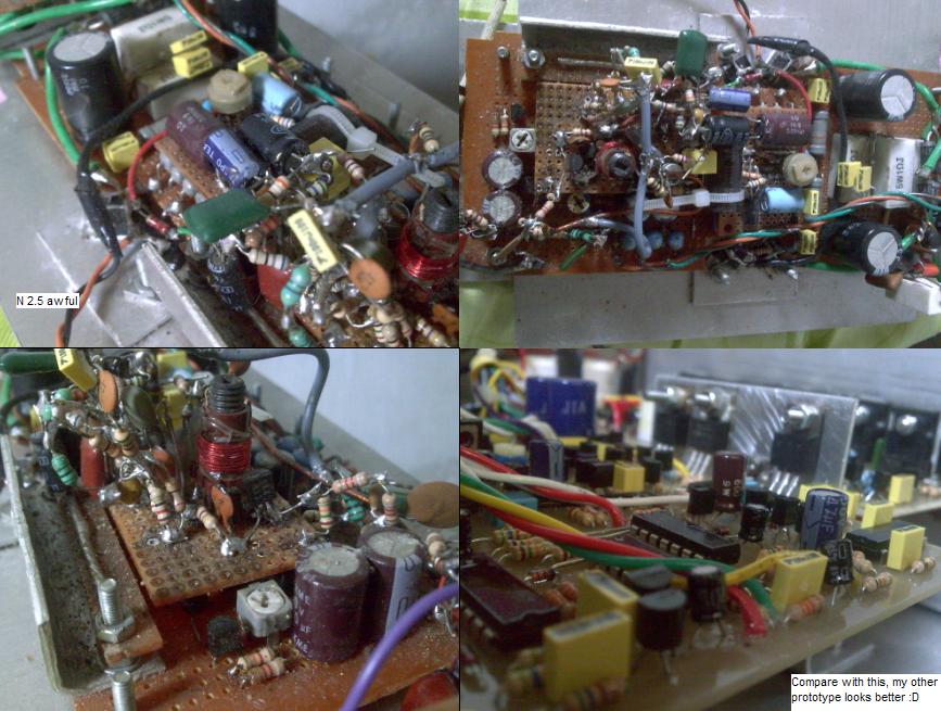

Like I just said before to not too much dream, nothing is perfect in this earth. Here is latest N2 shot, it looks awful I don't think anyone interested after seeing 🙄, the sound is good but not perfect (I am happy with this and not dreaming any perfect one😀).
My apologies.. also for full schematic isn't public, but I may share what is public and usable.
