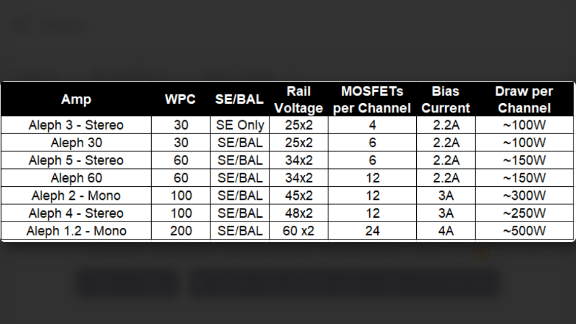

Here you go, 2.2A continuous

I've used them at a little over 10A per rail without issues so far 🙂 3u & 22lb rack mounted units, each drawing 1000w from the mains at full tilt. I have had them both on a single 15A house circuit without blowing the breaker, but I don't think I'm pushing them much. They seem efficient and pretty quiet.

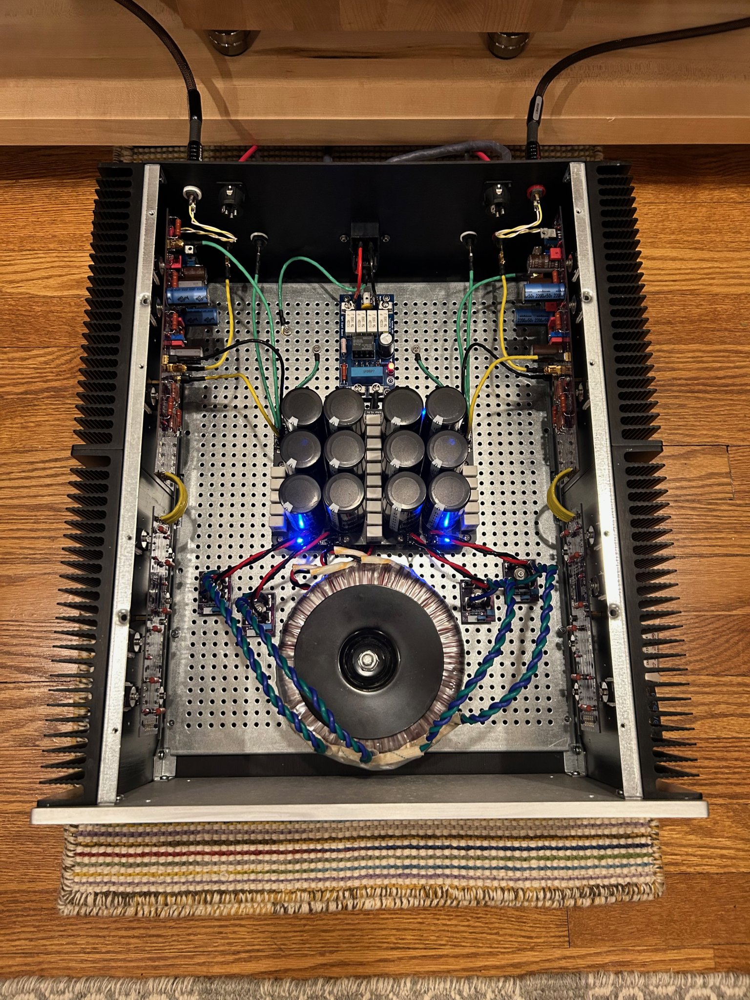

Finished the Aleph 60 build after a couple set backs due to my own carelessness. A big thank you to Randy for supplying me with a replacement set of MOSFETs for one channel after I toasted a few. 🙄 I still have some wire organizing to do but was eager to listen to it tonight. The amp sounds really nice. Excellent drive and bottom end authority with my speakers. The Aleph 30 drove the speakers quite well but the 60 takes it even further. Really happy I decided to do this build. A huge "thank you" to Randy for creating these excellent boards and build guide.

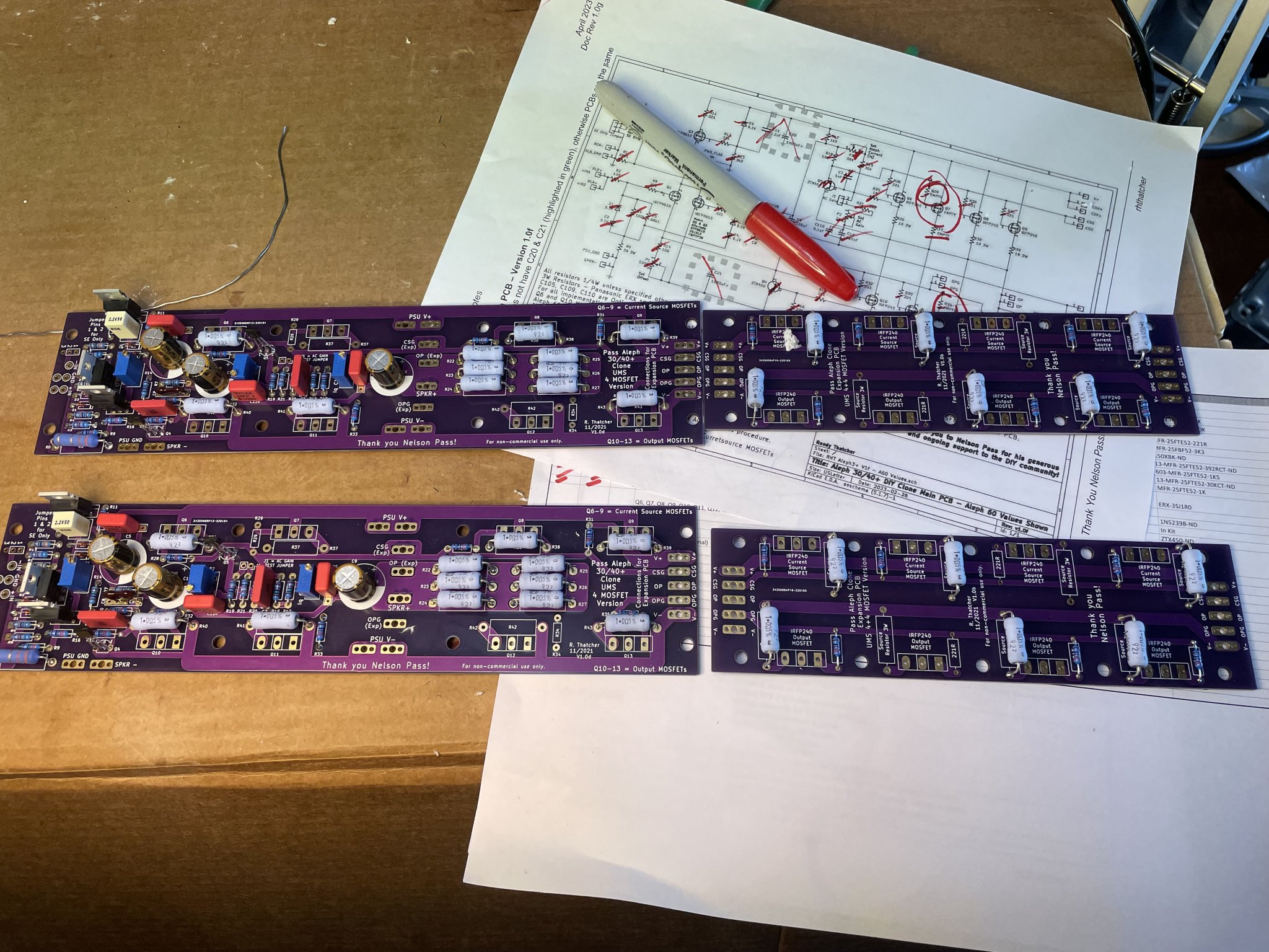

I finally took a bit of time to stuff some boards for the Aleph 60.
Once I get the external PSU all sorted out... I'll make some music. At the moment... subject to change at any moment... the PSU is planned to be...
Two of the V8 boards in a separate chassis with one set of resistors subbed out for the 'standard' Hammond 159ZJ. So, it will be a CLCRC... or a CRCLC. I'll have 33kuF electrolytics and motor-run caps in the amp chassis. Still trying to understand local decoupling etc.
I'm also determining what to use for a soft start. I'll likely just use thermistors for the time being, but I've got boards and a stack of parts for Mark's H9KPXG. I need to do some reading to see how to implement it with dual mono, dual rail. If anyone has already done so... or just knows how to do it, and could point me in the right direction, I'd be grateful. I plan on re-reading the thread again, but any help is appreciated.
Then, I'm trying to decide on speaker protection... I haven't done it yet for any builds, but...
Most importantly - Fantastic boards and guide, @rhthatcher!
:cheers:
