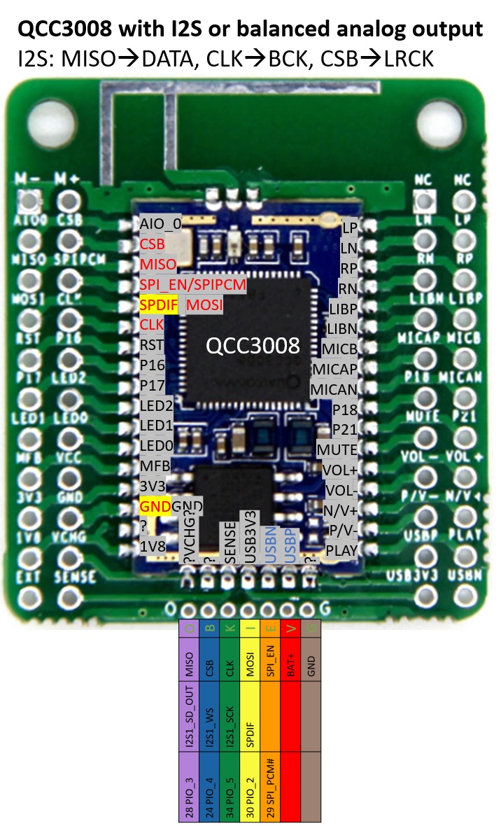

Thank you very much, i will try to find that !You would need to find the SPI interface on the board in your headphones so you can connect the programmer. Then just follow the instructions in OP.
QCC3008 -->I2S -->DAC
Hello Chrome3rus,
have a look at the picture and the links:
Tutorial: LowBudget 4Kanal SureDSP mit DIY-Anteil fürs Autoradio, Projekte der Nutzer - HIFI-FORUM
Connecting a PCM5102a breakout board to a Raspberry Pi – Bjorn's Techblog
Raspberry Pi $4 High Quality Audio – PCM5102A
please tell me how to connect such a PCM5102 to QCC3008

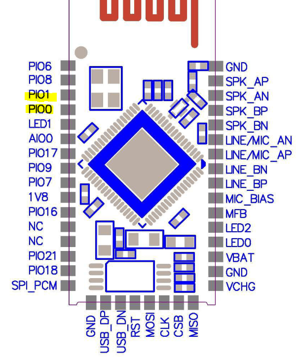

- CSR8675 (e.g. BTM-875-B module)
- Your BT module is correctly wired up, has a sufficient power supply, the PWR pin is connected to a button that can switch it to VDD_PADS. This is required to power-up and power-down the BT module.
- Your BT module has a button connected between VDD_PADS and one of the PIO pins (e.g. PIO2) to trigger the TWS pairing once programmed
- You are using a CSR SPI USB adapter or have successfully configured the FTDI variant, I will not explain how to do this here
- You have connected the CSR SPI adapter correct to your BT module

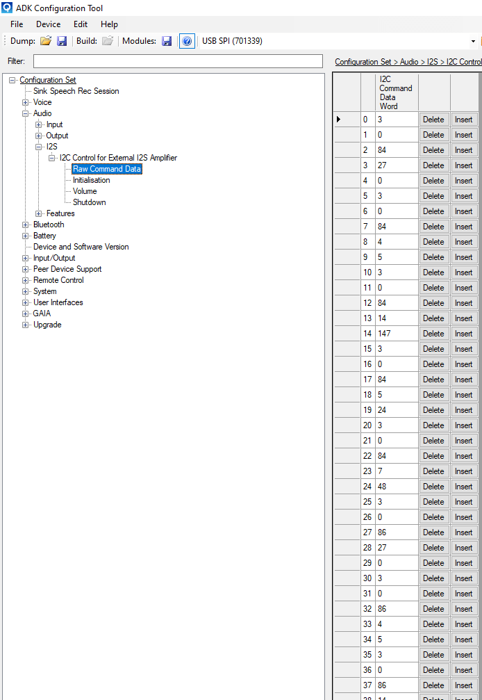

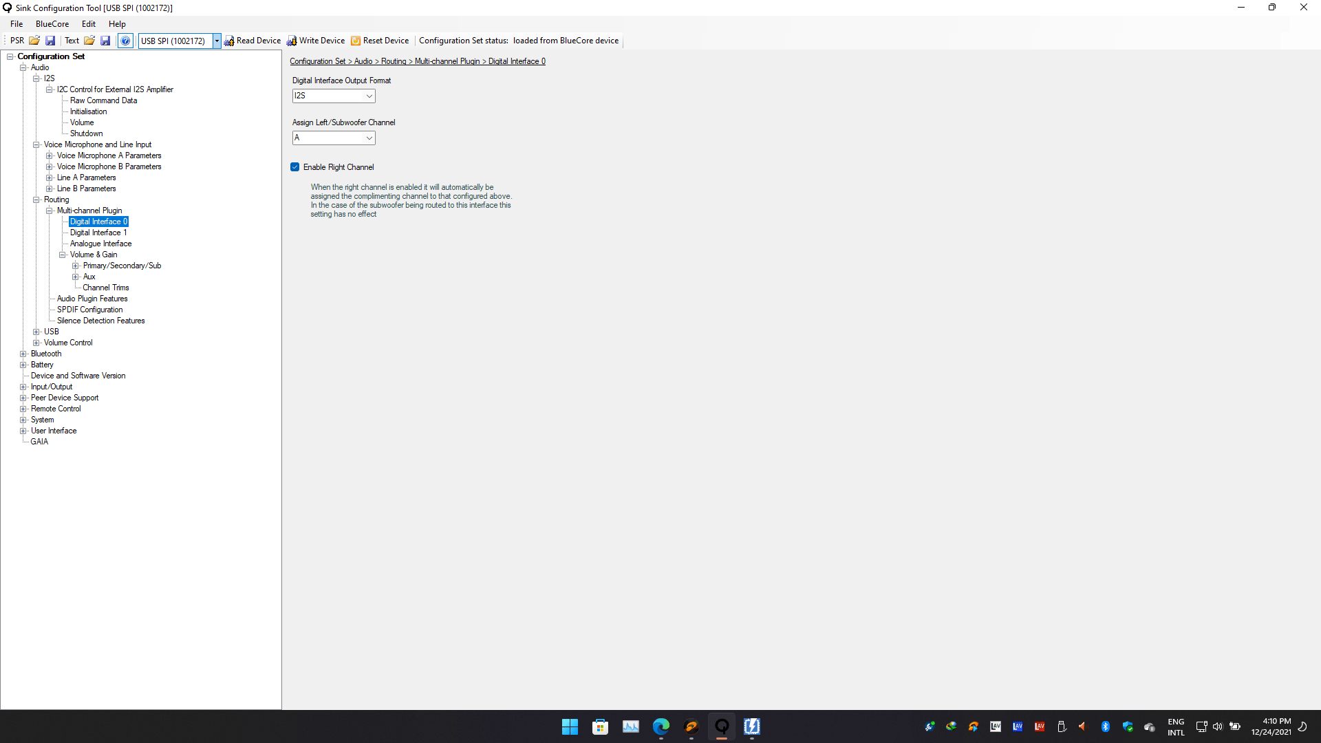

Configuring BT module for TWS using ADK Configuration Tool
Launch the ADK Configuration Tool, select your SPI Adaptor from the upper drop down menu. Make sure your BT module is powered up!
If the connection was successful, your can click on Go configurable and the Read Device button should become available after some time.
Click on Read Device - the left hand side tree navigation should now become usable.
Navigate to Configuration Set > Bluetooth > BR/EDR Profiles > A2DP and configure the settings as seen in the screenshot.
Navigate to Configuration Set > Bluetooth > Connection Management > Discovery and configure the settings as seen in the screenshot.

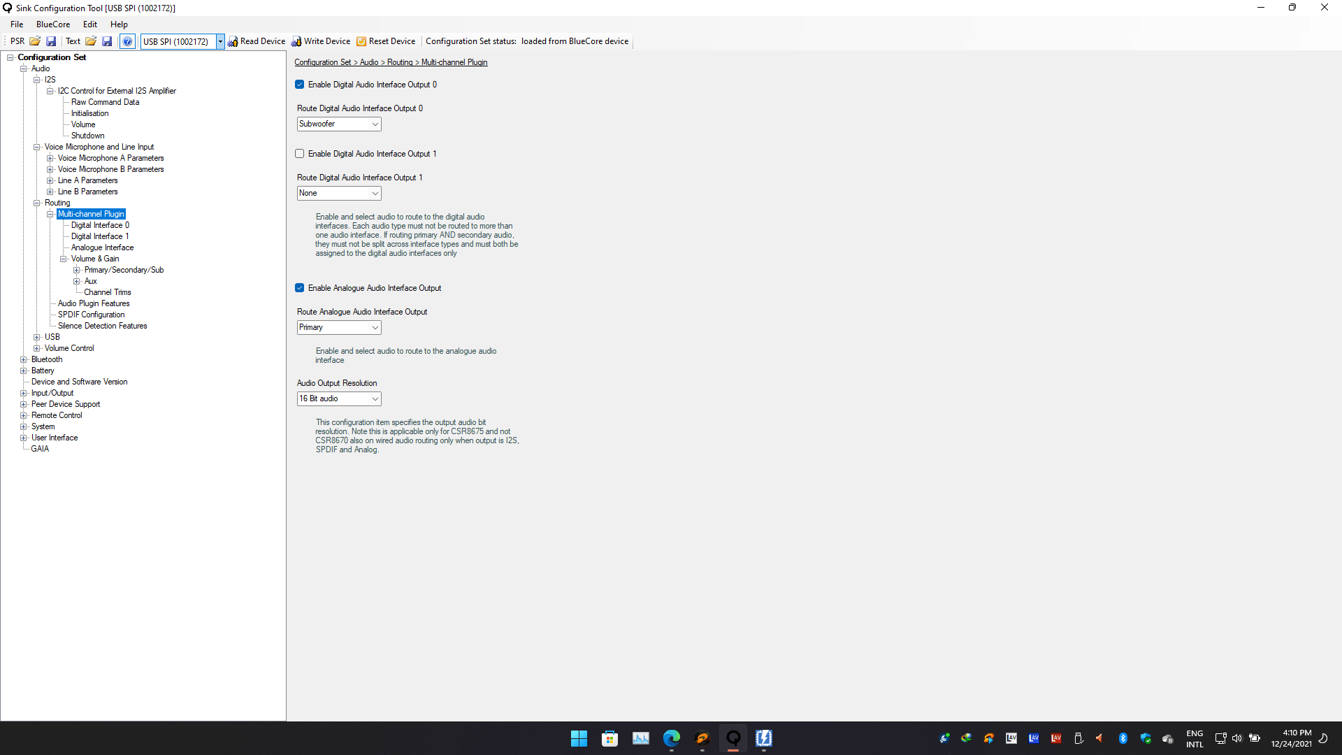

Navigate to Configuration Set > Peer Device Support > True Wireless Stereo and configure the settings as seen in the screenshot.
Navigate to Configuration Set > Peer Device Support > True Wireless Stereo > Audio Routing and configure the settings as seen in the screenshot.
Navigate to Configuration Set > User Interfaces > User Events and configure the settings to your liking. My configuration for Peer Session Single Button Pair uses Logical Input 2, Very Long and all conditions except lat last two in the State Mask. VREG and CHG Disabled.
Navigate to Configuration Set > User Interfaces > Buttons > Translation Table and adjust the Logical Inputs to your liking. My configuration sets Logical Input 2 to PIO12.
Click on Write Device and Go Normal. You can now power your BT Module back up using the PWR button.

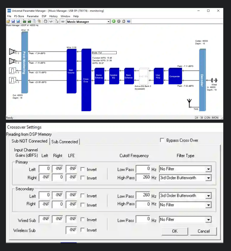

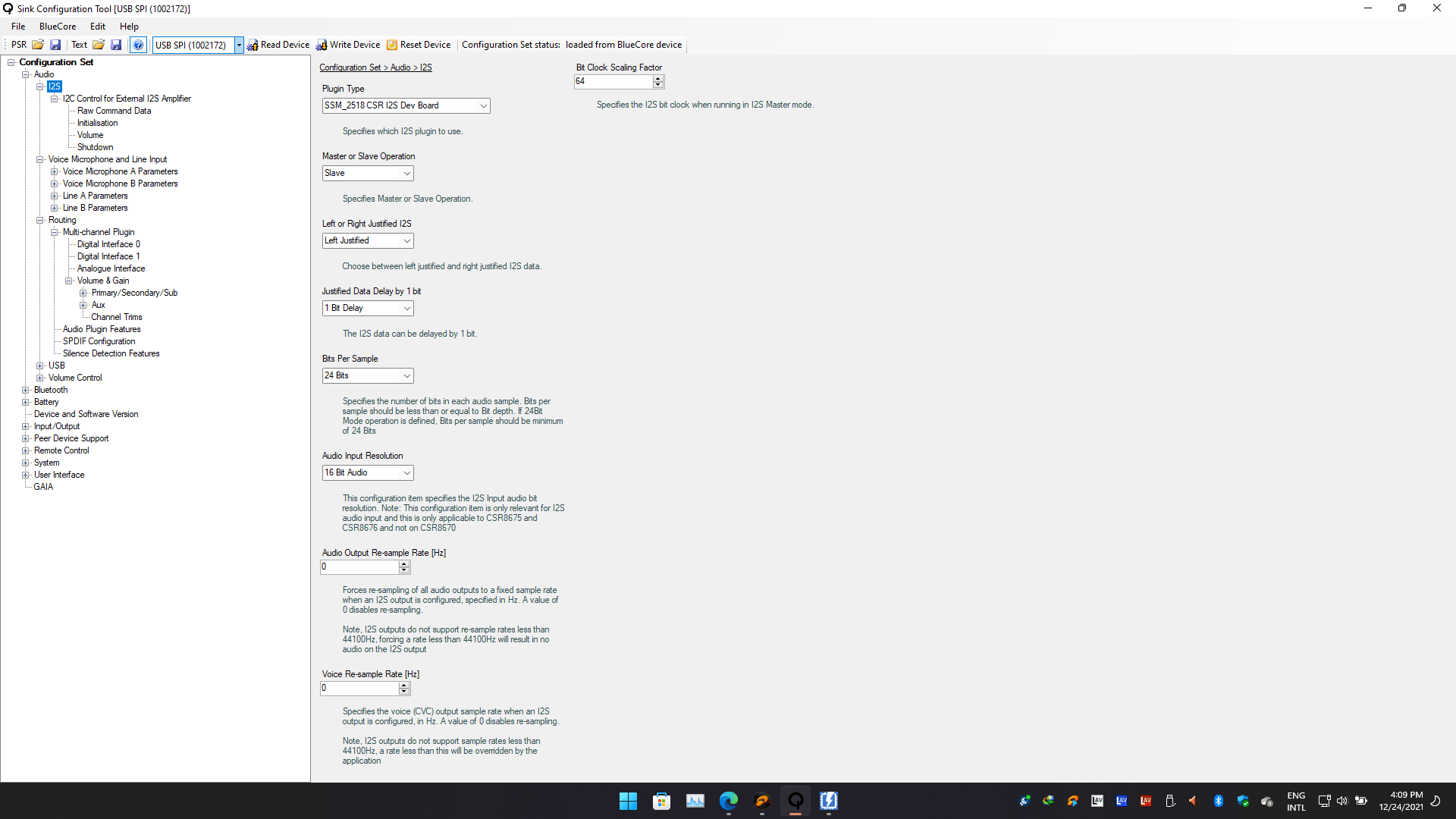

Again progress: I was now able to get TWS + I²S running. Background for that requirement is, that I have more than two speakers and would really love to use the internal DSP and crossover of the CSR8675 for both high/mid speakers and one low speaker.
Since the CSR8675 has two differential outputs, I either needed to do crossover work after the fact (either analogue or with a real DSP like ADAU1701) OR I use I²S to get an additional pair of outputs.
I decided for the latter, since it would really save me footprint and effort. An I²S DAC is cheap to have and the implementation and testing is far more straight forward than designing an analogue crossover (which then would have a fixed dropoff frequency) or implementing a custom ADAU1701 solution.
For the testing I now used a PCM5102A on a generic breakout board. Those can be had for pretty cheap. I scored 5pcs for 25€ on amazon.
The PCM5102A is pretty simple. It does not use I²C for configuration, but rather has some Pins that can influence its mode of operation. Rest is determined by the incoming data from I²S.
I went with the following configuration:
FLT -> low
DEMP -> low
XSMT -> high
FMT -> high
This will automatically have the PCM5102A unmuted and waiting for left-aligned data.

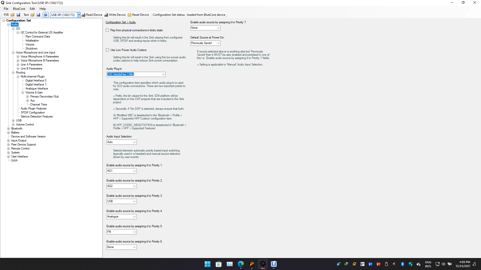

First of all, we need to enable routing of audio to the I²S output channel:
Next is the specific I²S configuration:

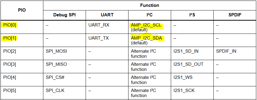

Since the PCM5102A does not have I²C we need to disable all I²C communication, otherwise the CSR8675 gets stuck.
This is done by setting the Number of I²C commands to 0. Also we can configure a ENABLE GPIO which can later be used to automatically soft-mute the DAC via the CSR8675, not using that currently.
Setting that up, the PCM5102A is now appearing in the universal frontend (make sure to have an audio stream running).

I got some QCC3008 board´s over at Tiny sine(TS3008).
If i establish a Bluetooth connection the connection only lasts 20-70 sec, undependent whether i start to stream over IIS or not. In order to connect to the module again, I need to restart or power up the module. Is this behaviour revered to as “crashing”. If not what could cause be the Problem.
Any input appreciated.

I´m trying to get the QCC3008 to do some IIS i´m using an FDA903 (Amplifier) which requires the IIS clock to be present in order to execute IIC commands. Apparently one can configure some IIC commands in the ADK software. I took a look at the real datasheet and there is a IIC separate interface but I don’t really know how to use that, or to be more specific. where to program that?
As i understand now IIC is separately transmitted. (not along with the IIS data)
In the ADK software you go Configuration set => Audio => I2S => Raw Command Data:
then there is displayed a list of “random” Numbers. I don’t now what these Numers do or what they mean, or if it is enough to add some specific numbers and my Amplifier starts working.
If anyone knows how the QCC IIC communication works, or could link me to some relevant resources, or has some answers to my question. Is encouraged you to help me out.
Please help me out.
So my next idea would be pretending like my Amplifier wouldn't need IIC to function and input the IIC commands over a separate MCU. Has someone already done that?
Tanks a lot any Input is appreciated, have a nice one
Please help me out.
OK, just discovered the documentation i needed in case any one else needs it: ADK Support Documentation => Additional Support Documentation => QCC300X I2S User Guide. I apologise fore writing/asking before looking through the entire Dementation. I guess I wanted to go the easy rout again again i´m sorry🙁 Not sure if this brings answers to all my Questions, but in theory it shuld.
