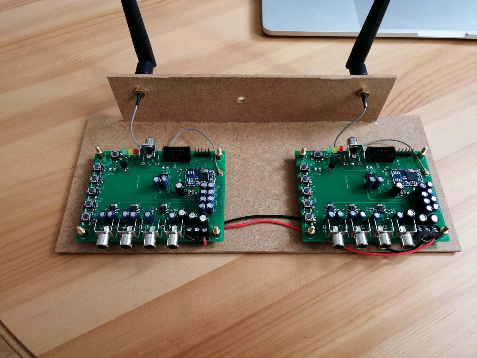

CSR8675 in TWS mode - Success!
Cheers everybody!
First of all, thanks for that great thread. The Data inside both Dropbox and Gdrive are really golddust. I pulled everything out of that and put it into my archive, god knows how long stuff stays online (outside of 52bluetooth.com).
My goal was to have a pair of bluetooth speakers that would consist of one stereo speaker with full-range plus one subwoofer. The main speaker should be able to either use BT or AUX analogue inputs for playback. The subwoofer should reuse whatever signal gets forwarded .
For streamlined build ups I wanted to design the hardware universal, to reuse as many PCBs etc as possible. While the AMP and Power Supply part are trivial to me, the whole BT stack was always kind of a black-box to me.
Since I knew the CSR8675 would be able to do Apt-x LL, I thought of using a Source in the main speaker and a sink in the Subwoofer.
Got as far as having two CSR8675 modules talking directly and streaming musik using classic aptX - as soon as I enabled aptX low latency, the sink code panicked. Although I included all necessary into the application projects.
Since aptX has a high latency, I did not further investigate, since this would not be sufficient for my use-case.
I then had a look into the the True Wireless Stereo use-case. Since I only care about two speakers playing a source synchronously, that sounded like the perfect solution for my problem.
I was now able to get two modules running in the sink application and using TWS to perform synchronous playback. It even forwards the analogue source, just the way I wanted it to be!
All my application development I've done using ADK 4.3.1.5 based on the sample applications. Used PSTool, ADK Configuration Tool, FlashTool and xIDE.
If anybody is interested, I can upload at least a dump of the xIDE project, Chip Image and ADK Configuration dump.
Those eval-boards I've build are also an own creation.
