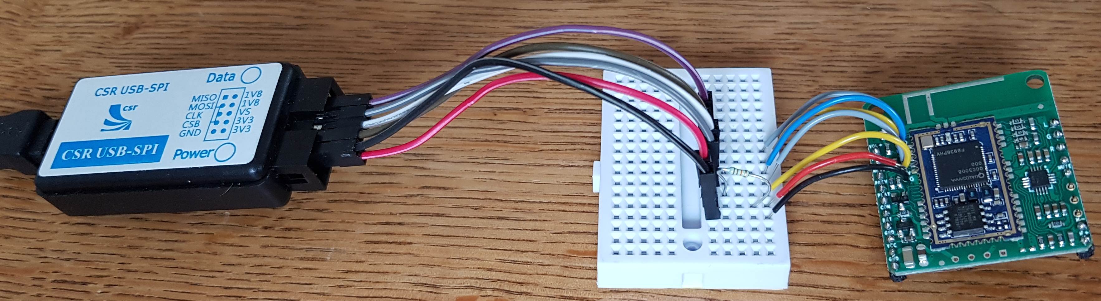

Good day everybody, hi SGr33n,
I have finally received my CRS ISP programmer replacement and was directory going to try the QC3008 board, that you got.
So my connection is the following:
QC3008 Board => CSR SPI
CSB => CSB
CLK => CLK
MISO => MISO
MOSI => MOSI
GND => GND
3V3 => 3V3
SPIPCM => 1V8
You can see some of the connections on the following images.
Please note: It may be necessary to connect VS to 1V8 on the CSR SPI, not 3V3!

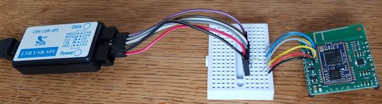

CSB => CSB
CLK => CLK
MISO => MISO
MOSI => MOSI
GND => GND
3V3 => 3V3
SPIPCM => 1V8
![](https://abload.de/img/img_20210531_210355egk4q.jpg)
![](https://abload.de/img/img_20210531_210409d3kf1.jpg)
![](https://abload.de/img/img_20210531_210418q8kne.jpg)
I tried the following applications from ADK 4.3.15 (I guess using a more modern ADK would be better, as you see later).
PSTool: works
![](https://abload.de/img/pstoollvkr0.png)
ADK Config: works
![](https://abload.de/img/adk_configd4k2j.png)
Blueflash: Does not work (no flash detected)
![](https://abload.de/img/blueflashjhkrq.png)
UniversalFrontend: Does not work (probably newer version required)
![](https://abload.de/img/universalfrontendu5k9x.png)
Update:
With the ADK for QC300X from here:
Dropbox - ADK_QCC300x.WIN.1.0.167.exe - Simplify your life
It is working now in UFE:
![](https://abload.de/img/ufe_workingdaka0.png)

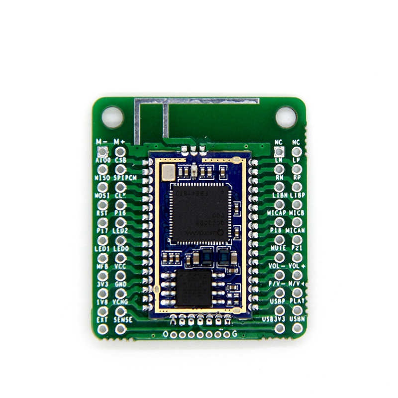

The adapter board itself is a HY5300 (see jpg), pretty similar to the one, TeHSiggi is using
![](https://abload.de/thumb/qcc3008boardw3jhe.jpg)
Now my questions to you all:
- how can I reset the board to factory defaults? I loked myself out from ADK conf. tool and can not switch back to the previous config.
- If I need to flash the board with factory default firmware, where do I get this? I made a dump with ADK conf. tool before changing config, but I guess, that doesn´t help too much. Sorry no PStool dump made.
- For the long run: any idea what went wrong?
- When put in I2S slave mode, is it a must to have the master be present to even connect to the board via bluetooth?
Best, Josef

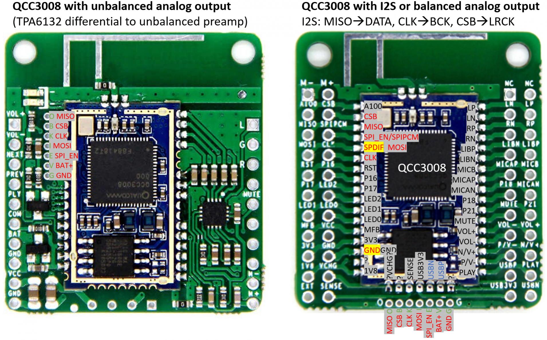

Hi, let me share with you my experience.
1. About reset this board to factory defaults, first you need to create a factory dump before any changes and this is only one way to back as I know. If you add changes for example with power and as a result, the module doesn't turn on anymore, the module becomes a dead body. Unfortunately, I have a lot of dead modules during my experiments with settings. And one more thing, this module has a reset button, but this button just reset all settings like device connection, history, etc. this is not a factory reset button.

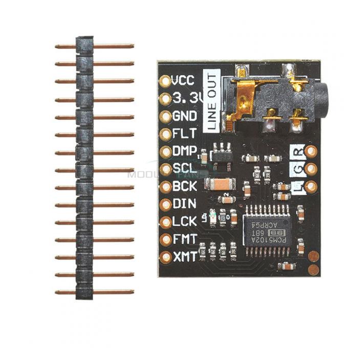

2. I have a QCC3008 module and DAC PCM5102A. I wrote chinese sellers about how to connect this Bluetooth with that DAC, they told me that by default this module works with analog output and with digital (I2S) at the same time. I connected BT and DAC and I didn't get any results.
Maybe someone has this experience QCC3008 and PCM5102A? Could you share that with me?
Thanks.

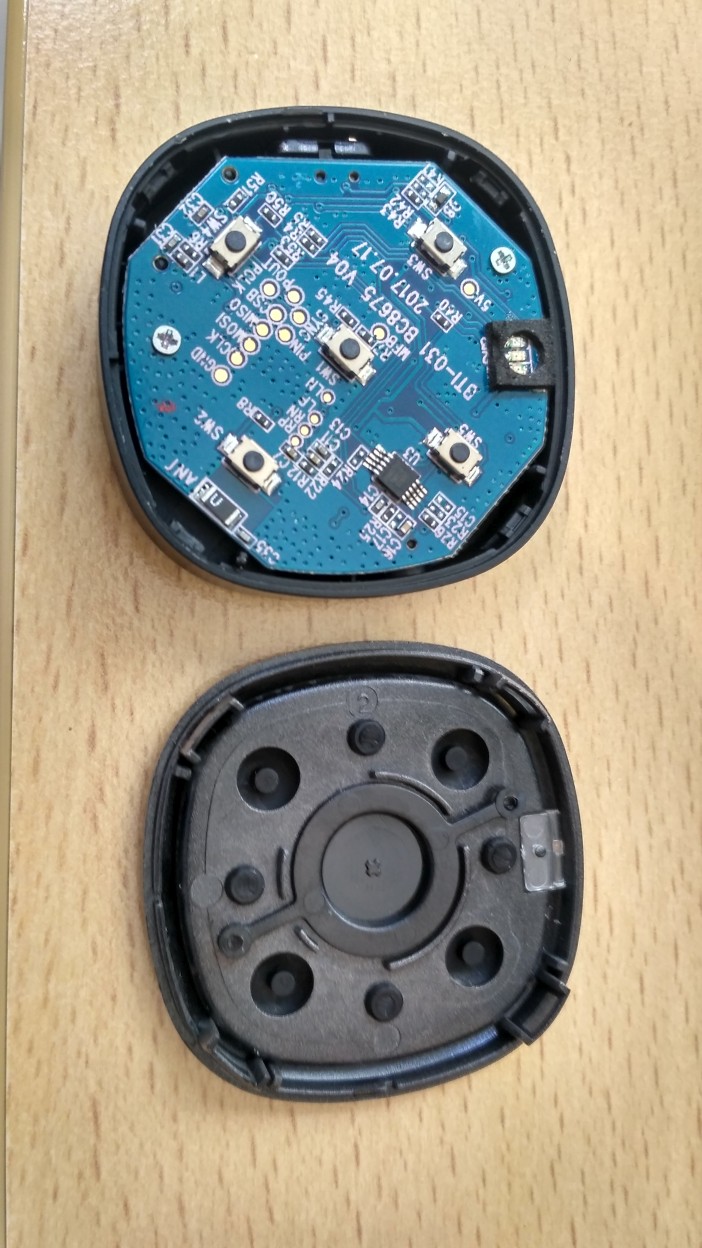

Hello
CSR8675 on BTM875-B board. I am using ADK4.4.0.21.
xIDE has successfully compiled the "VM_Speaker" code.
The ADK Configuration Tool can read the settings, but refuses to write the changes with an error: "Fatal Error: Unable to write configuration block 33 to the device.
The error code from the AHI was AHI_ERROR_INVALID_MESSAGE "
What could be the reason? can you share the Project Properties VM settings?

I have a result, and maybe for someone, this information will be useful.
I have two modules Bluetooth - QCC3008 and DAC - PCM5102:
On the QCC3008 module I didn't change any settings, by default this module has two output signals Digital and Analog.
The important thing is connection:
PCM5102 ----- QCC3008 connection:
VCC ----- x
3V3 ----- 3V3
GND ----- GND
FLT ----- x
DMP ----- x
SCL ----- x
BCK ----- CLK
DIN ----- MISO
LCK ----- CSB
FMT ----- GND
XMT ----- 3V3
SPIPCM (on QCC3008) ----- GND
After this connection, everything started working in my case.
I hope this information will be useful.
Thanks.

got a bunch of RRD-305 boards with QCC3005 on them.
https://abload.de/image.php?img=3005rt7j2j.jpg
https://abload.de/image.php?img=3005fsejmz.jpg
Tried to get them running in a minimal test environment:
The boards (test three of them) do simply nothing:
- 3.3V on VBUS
- 3.3V on POWER_EN
- SPI_PCM low
- LEDs (via resistors) at the LED pins
Any hint, what could be missing?
- no LED at all
- 1.8V output remains at 0.1xxV (means, the internal voltage regulator doesn´t get enabled? And therefor the whole chip is power down?)
- no pairing
As with almost all those China boards: extrem little documentation available.
THX, Josef
