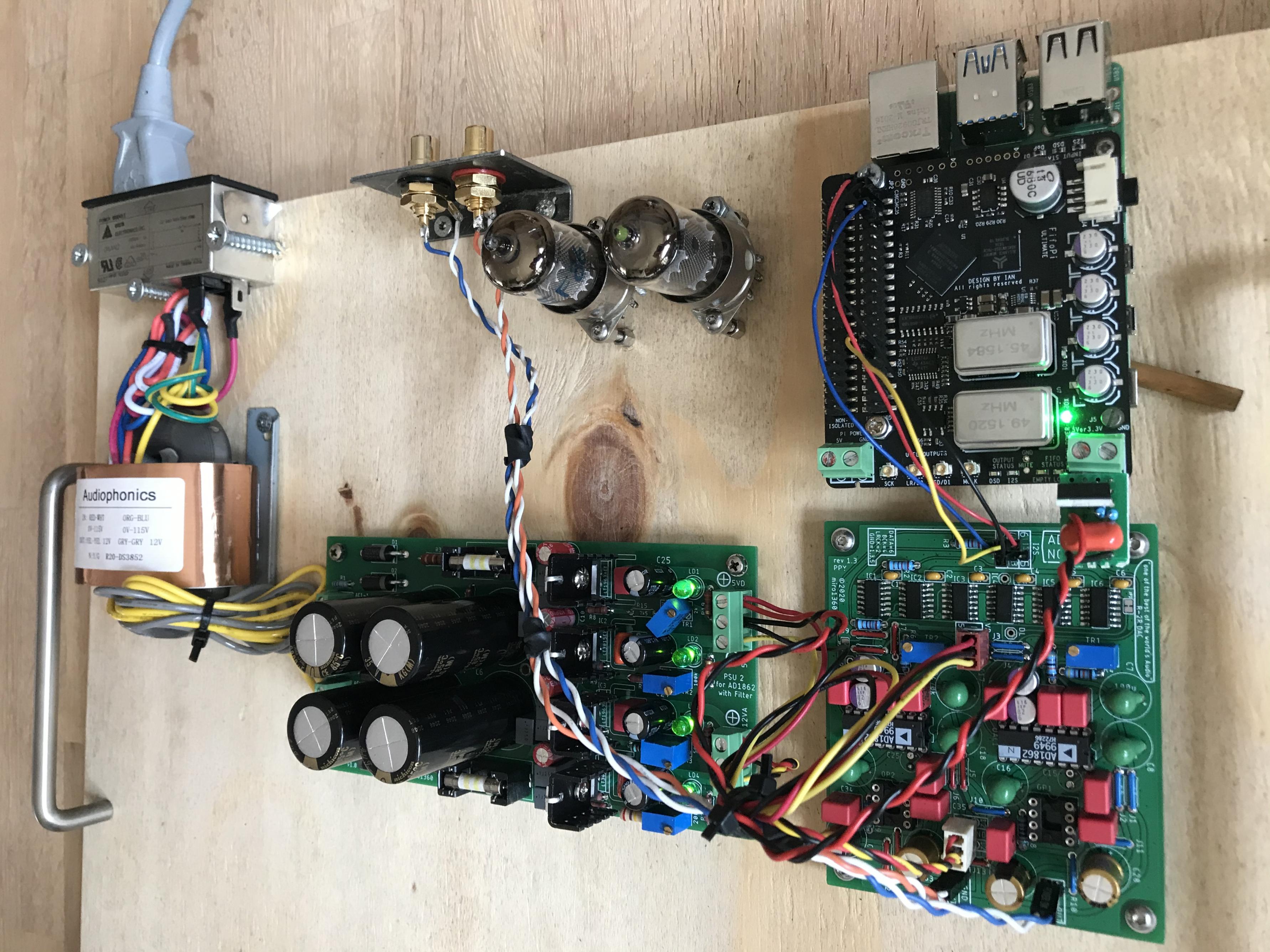

Hey remark regarding opamp THS4031, better omit this opamp, they go to heaven fairly soon: got an huge plop on speakers when I put streamer on. Measured voltages and 2 opamps had curious -12 voltages on not used pins..
This from only 6times or so on/off cycles.

You have installed the components on Miro’s board to adjust the MSB trim, did you use a test signal and oscilloscope to adjust for lowest distortion? If not, I wonder if this could be a reason for getting your subpar listening impressions? Remove the trimpots and associated resistors and have another listen.
>Tubee, why not take the I2S from the reclocker and not from the pass trough GPIO header (I2S of the Rpi not reclocked by the hat) ? Even you wires are not the same length.
I would try from the uf-l socket and sacrifice 3 uf-l cable at one side for the purpose. while the gnd conexion should ask tricky diy, hence the uf-L good needs. The I2S of the Pi is FGPA abstracted from a single crystal on the Rpi so it could be a problem in relation to that or the I2S choice in the playback streamer software.

Solved problem with the ths opamps, fitted the opamp feedback c0g caps on underside of pcb, Pushed some vw beetle ne5534 opamps in and to my surprise it’s sounding more decent now.
I think those ths opamps where oscillating as hell..
The I2S wires are same lengths, these are until the ufl wires will arrive with a trimpot and opa627 opamps
A low impedance PS is an idea indeed. But I know this one is fine already
Also want better accusilicon cristals in time, and a tube or tranny I/v schematic
Those tubes are not connected
Msb adjustment is not done indeed i will do this procedure
AFAIK there is no output cap @ opamp.
Are those 1 to 10 value caps coupling caps? (C15-c25 and c26-c26) then I will swap a tantalium on underside for Panasonic aluminum
