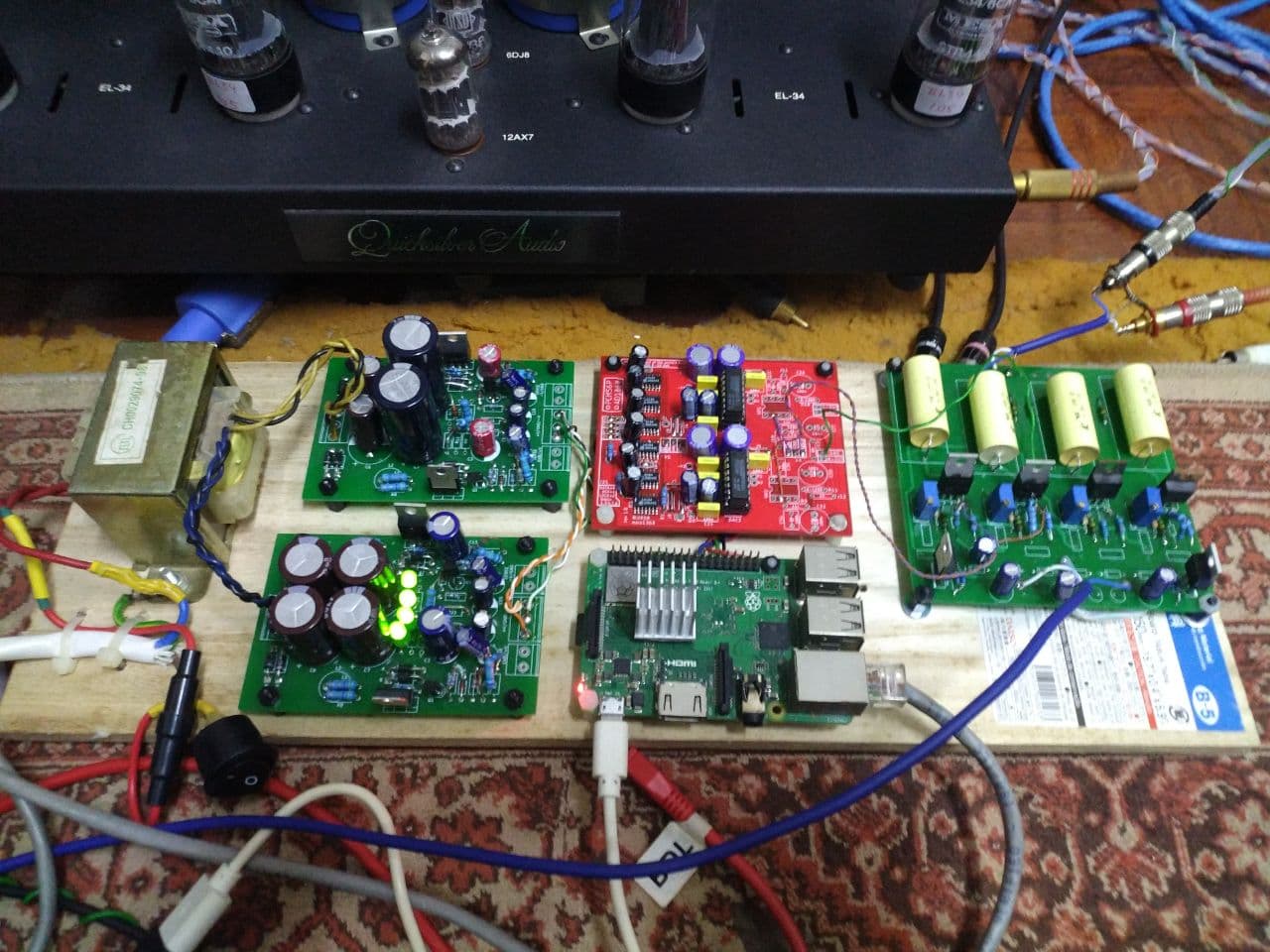

As with the AD1862 board, the PCM56 dacs are powered from Trileru’s implementation of the Denoiser circuit for both LM317 and LM337. The PCM56 pcb is running on +/-5V rails and +/- 11.25 V rails. This is because, I used 2 10V Zener diodes from the adjust pin of the LM317 and LM337 to ground, relying on the constant current generated at the adjust pins of both regulators respectively. As for the +/- 5V rails I used 2 green leds in series as a voltage reference, again from the respective adjust pins to ground.
I have not used the op amp option for the output stage, but have used a variation of Nelson Pass’s D1 i/v stage, leaving out the source follower part and taking the output directly from the drain and coupled with a 6.8uF film capacitor. I made no changes to resistor values for the Nelson Pass’s D1 i/v stage. The same values were used. However, my implementation of the pcb for the Nelson Pass’s D1 i/v , enables me to try out both the IRF630 and IRF610 mosfets without having to rewire everything.
Thus far the dac is running on the IRF630 mosfets.
Because the Nelson Pass’s D1 i/v was designed for the PCM63 dac which has a 2 ma current output, I piggybacked 2 PCM56 dacs per channel to output 2 ma. The PCM56 dacs do run hot though.
I must say that the sound appears to be weightier than the AD1862, but the details in the highs appear subdued and less prominent.
I am not sure if this is because of the use of IRF 630 instead of IRF610, I am presently listening to whereas I used IRF610 mosfets in the D1 i/v stage for the AD1862.
The soundstage is equally wide, deep and open. All in, the dac sounds great, and I am well pleased with the effort. The old R2R dacs really make the current PCM1794, AD1955 and ES9018 dacs sound thin, puny and lifeless compared to the AD1862 and the PCM56P. Will try out the AD1851 and AD1860 dacs next, after I procure them. I also intend sometime in the future to power them from shunt regulators.
Many Thanks for the effort taken to layout the pcb's and providing the Gerber files. Great stuff.
