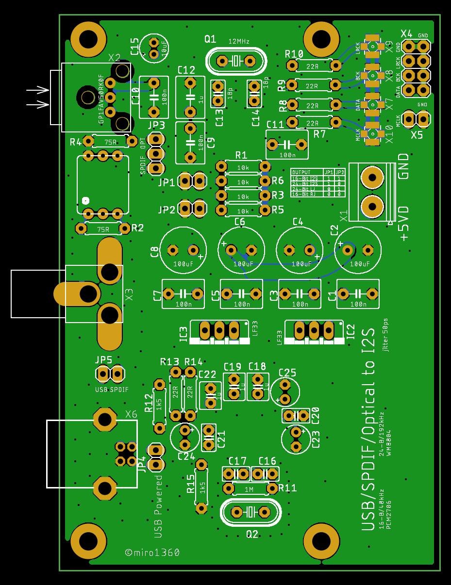

Miro, provide both, headers and ufls.
It would be nice if someone compare W8804 / DIR9001 / PCM2706 with modest clocks against newer, more expensive XMOS / CM6601 implementations.
DS DACs need this more complex digital front end, do R2R are effected by this and if so how much?
A module approach could help with these kind of tests.

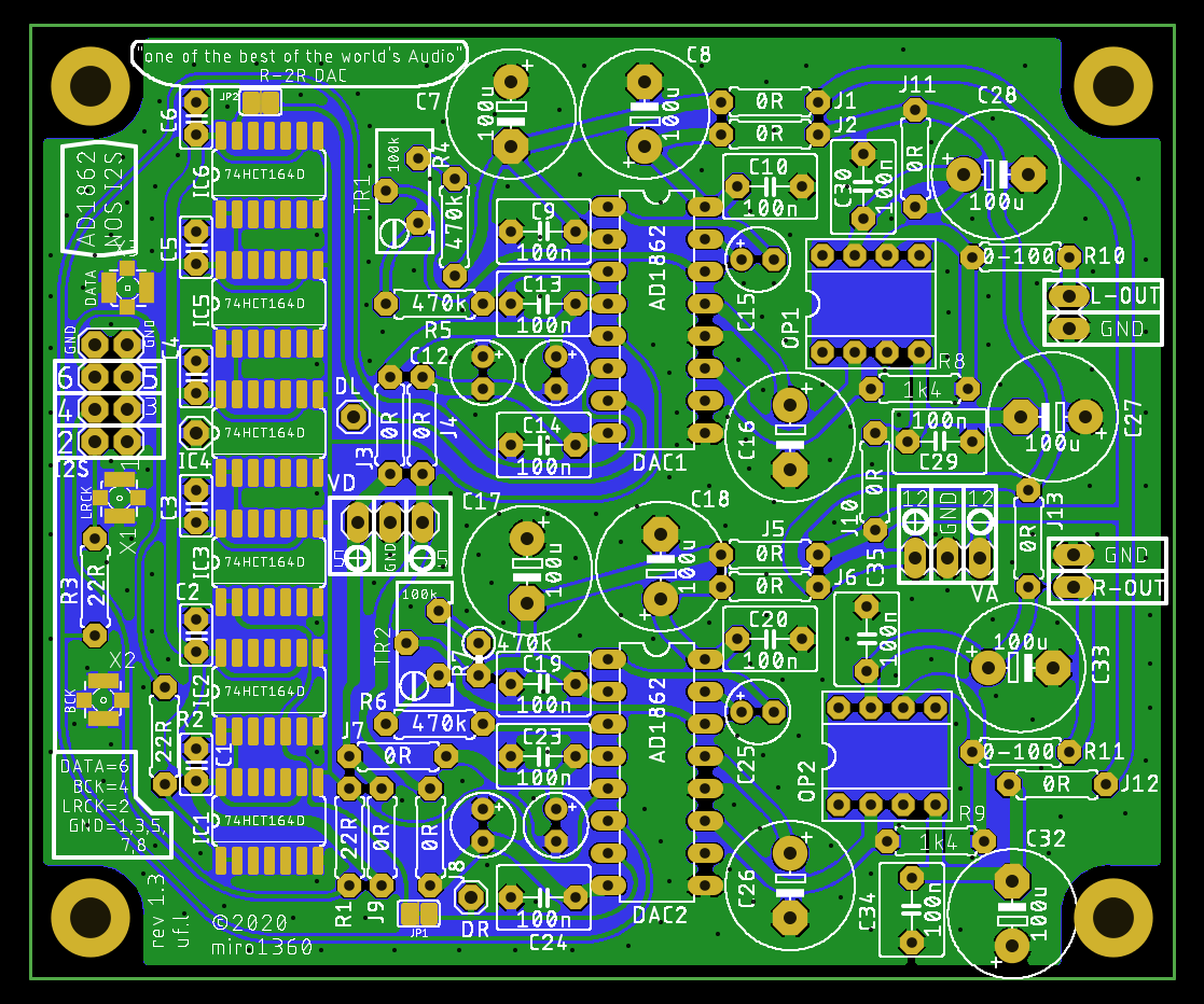

Diyiggy what is the correct value for the r10 output resistor???Congrats Miro for this next episode season 2 of the GoT DAC
The little DC traffo spliter sucks a lot of information. I know it's in all on the datasheet, but if one has a RCA with a dc blocking cap, it worths to try to remove it : the sounding difference is huge according the experience I made on an old AD1865 DAC. Also true AESBU with a simple coax TV cable all at the right impedance sounds much better than a RCA, but it means the streaming device to have one with the according circuitry (lesson learned from Jean-Paul and his fellow cool little ESS 9023 DAC which is sounding very correct for a Sigma Delta)
For R7 to R10, resistor choice is critical and not always mandatory, here again if no bouncing, a transparency sucker. I would avoid all not goo enough resistor here as the too much often seen in this thread Dale RN50 (the little brown one) : prefer through hole Yageo 1% precison : much better noise floor ; if SMD that are easy enough to solder : thin film from SUSSUMU has passed subjective listening test here as measurements : it's also easier to remove for zeo ohms than a THT with vias than are not easy here for tweaking (though boards are cheap at the famous JPLCB, and take not golded traces : it 's sound better
I m asking because here is 150r but i have seen 47k after opamp stages in other dacs..
can you put a copy here or a link towards the shematic, I haven't under my eyes ! If you talk of the last buffer stage and its last serie resistor before the rca or dc caps : anytrhing between 120 to 150 ohms is correct, try 1/8 Allen Bradley trough hole or Suusumu if smd. I think if you saw a 47 K it was a shunt towards the Gnd.

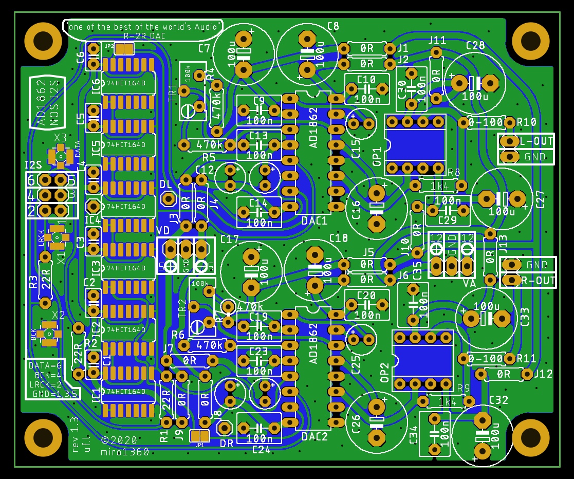

Ok guys, here are the uf.l connectors together with the pin header
Again untested = prepare yourself to be disappointed from a bug
Hip Hip Hurra.... I can't beleive it, I 'me just coming back from the church where I ligthed a dozen of candles for this miracle
Jim will use the output of his FIFO PI with good 2" uf l wires to keep the impedance and grounding correct ! The ones whom don't care leave the uf l traces unpopulated, cool !
I don t know were it is but r10 is the last resistor that is in series with the output of the last opa861 buffer. I had a dac in the past that had 47k in series with rca after the buffer opamp... never understand why and the reason of this resistors on signal path...can you put a copy here or a link towards the shematic, I haven't under my eyes !
I m listening with 150r sussumo.anytrhing between 120 to 150 ohms is correct, try 1/8 Allen Bradley trough hole or Sussumu thin film if smd. I think if you saw a 47 K it was a shunt towards the Gnd with a dc blocking cap before as a RC filter as well
The dac was an ak4495 and 47k in series not shunt to ground... on the last opamp before rcas..

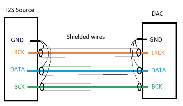

Use either a shorter 3x2 ribbon flat cable (IDC), or a twisted pair (signal+gnd for each signal: LRCK+GND, BCK+GND, DATA+GND) ... Don't leave those signal cables on the single GND
If you have only 4pin header with single GND, use shielded wires
...If possible, another request please....
Squeeze in a GND pad inline with the I2S header so a single row, 4 pos Molex connector can carry all I2S signal with GND.

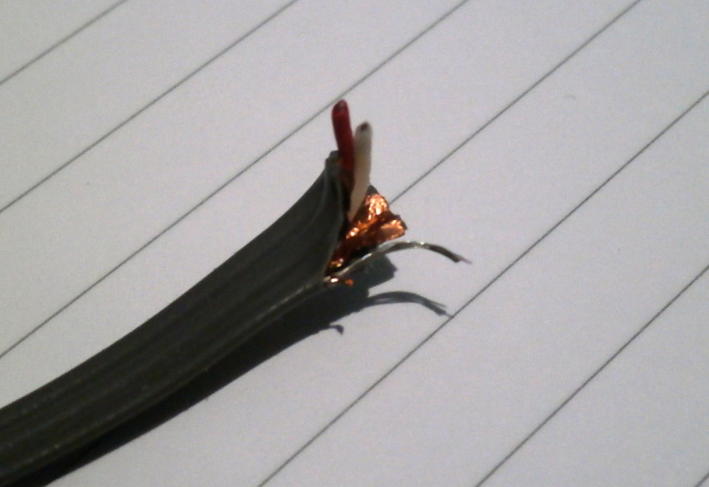

shielded ribbon cable is perfect
