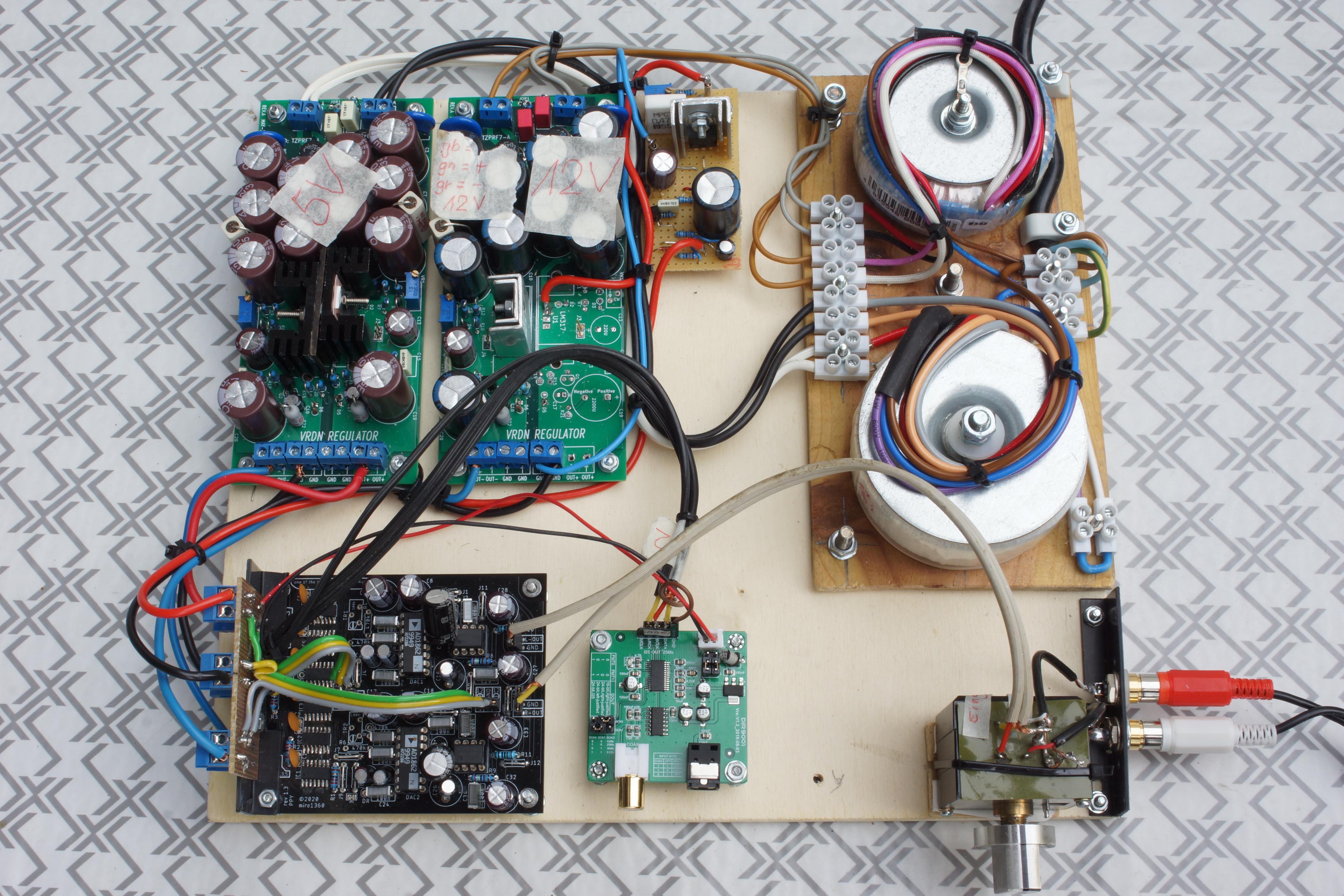

I just made it completing 2nd attempt of the DAC-board and it worked right away. Attached are shots of the DAC-board and of my wild bread board for the purpose of functional testing. After all the enthusiastic comments about the sound quality by the other members on this thread of course I was very curious and sure a bit of scepticle. Even though the componentry I used, others than the 1862 IC and the op amp, was leftovers from recent builds only and the op amp was the NE5534 simply because the price of €0.45 was unbeatable, I could not agree more to all the positive comments of the others. I was trying both baroque style chamber music as well as rock and indie. Clearly, the most significant difference I noticed compared with my Dacmagic 100 was by listening to rock music. I tried a CD version of Fleetwood Mac's "Rumours" and I have not enjoyed it that much before. I even prefer the sound better than in the old vinyl days (hoping my memory is half way reliable). "Albatros" was almost blowing my small d'Appo boxes. Listening to Bachs piano and lute sonatas the difference is less noticable. The sound is slightly warmer and the bass strings of the lutes are giving more bottom. I will no go ahead trying other opamps and maybe change some rubish componentry and possibly try other PSU's as well.
@JimK04
I do have a dir9001 board in the drawer and are planning to test it. The board used in this bread board setup is a Toslink to I2S converter by Banggood Hongkong at $18.- or so. It worked without any problems first shot. Other option is to find the I2S interface in my Kenwood player. Will let you know if my DIR9001 board works.
Hi Zapotek,
I like your choice with the 0.1 uf MKH caps. The MKC blue Ero are good (softer if you need softter tones) too as the Wima ("neutral") of the BOM.
Ways of improvements seing the two pictures if the addiction comes on this board or a next one.
Passive volume pots may ask clearer caps at the output of the DAC board.
If your amp has a cap at the input in serie after the RCA you can try the dac board without the DC blocking cap on it: wire strap instead. If not you can also try a different one : the green Nichicon ES bipolar or two Elna Silmic II of 220 uF/16V (or less : even better) in serie but oposit polarity to have a sort of bipolar : leads in serie : - + + - . Elna in serie will be a little less clearer than the bipolar Nichicon, personal taste. The bipolar standalone Elna is excelent too but harder to source, not something that not let you to sleep well though.
Shift register after the front end : nothing really wrong with your orange ceramic disc, but if class II i.e. non NPO/C0G (class I) better to go class I.
The shorter the wires between the Input of the DAC and the Spidf board the better. This fact remains even more important the day you will go with a better front end that SPIDF. Btw the Dir9001 is certainly the best spidf chip ever made. I would advice not to hack the I2S of your Kenwood player as I2S conection are made to be short non saying you risk to break the cd player but beginn to think about a Rpi 4 with an I2S reclocker Hat as the inexpensive Allo Kali : less than 100 euros for the two units. Also if you stream from USB output the JLSounds board for 120 euros with the shipment is also a good unit to bring more from Miro's board and the excelent AD1862 chips.
Of course as said the voltage regulators like the oaps is a good way of tweaking as well as said already.
I'm not a cable maniac but you really should change the RCA cable I see in picture two
for something a little better but not necessarily expensive. But the basic RCA cables given with the mass market devices ARE bad !

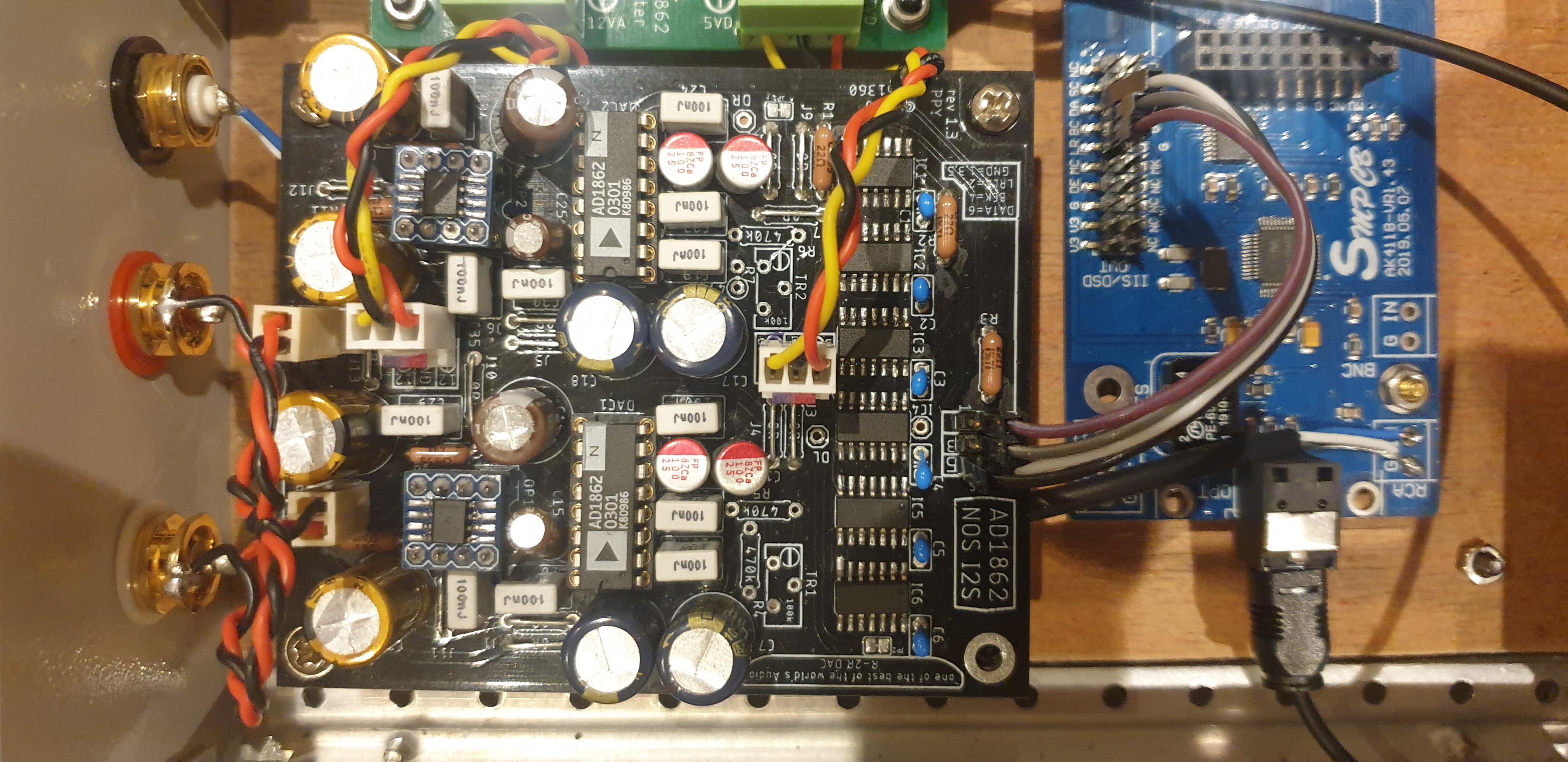

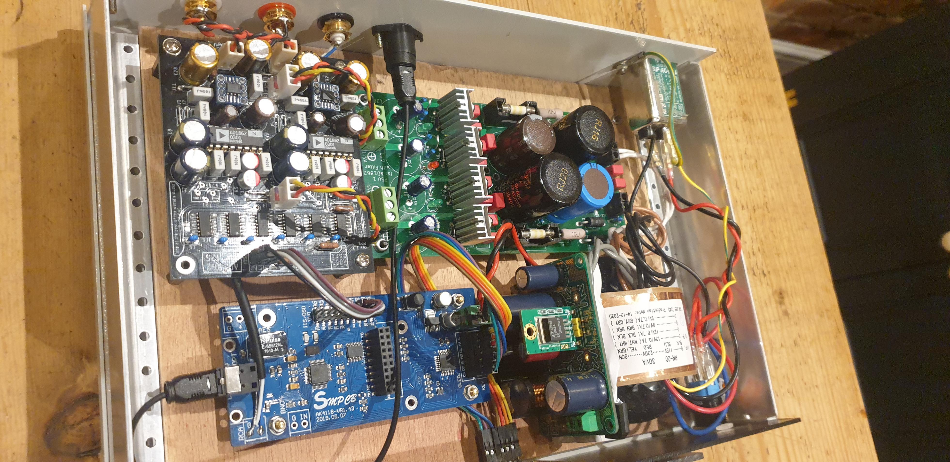

Got another one built up here too! I helped out another member on here whom wanted a built Miro DAC so I sold him my first build....minus the chips. And so I needed another and have built this one. I used different caps...SMR bypass and some polymers on the digital rails. Running OPA810 at the moment but I have 1656 on Vunce adaptors to try. I changed the psu for the spdif/i2s board for one of XRKs Cap Mx boards that has an LT1963 on it.
Sounding very good. I cannot tell you the differences to the previous build as it was some time ago I listened to it now.
A very nice sounding DAC once again. And I bought another set of chips from Paddy....just incase!
Next job is building up the Euvl/Ripster GB discrete IV stage. Surprised no one has that done yet!

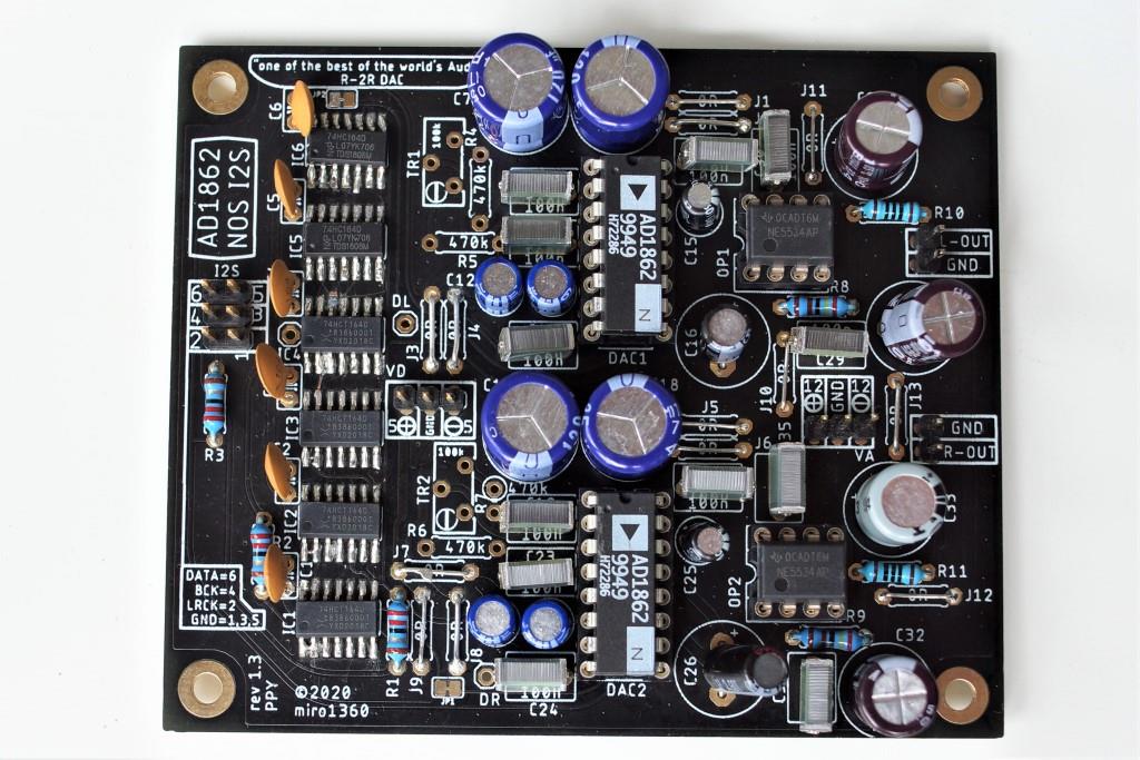

- Digital Line Level
- DAC AD1862: Almost THT, I2S input, NOS, R-2R
