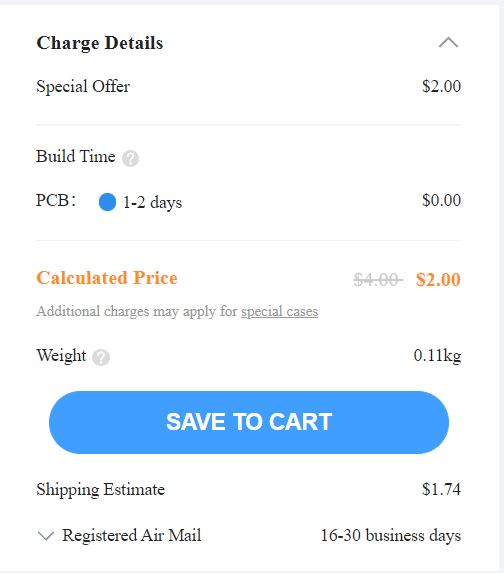

btw i tried to make quotation. is this real??? only $2 and $1.7 for shipment? that's crazy if it's true
i have bought many pcb for my build overseas, indeed it's not cheap
