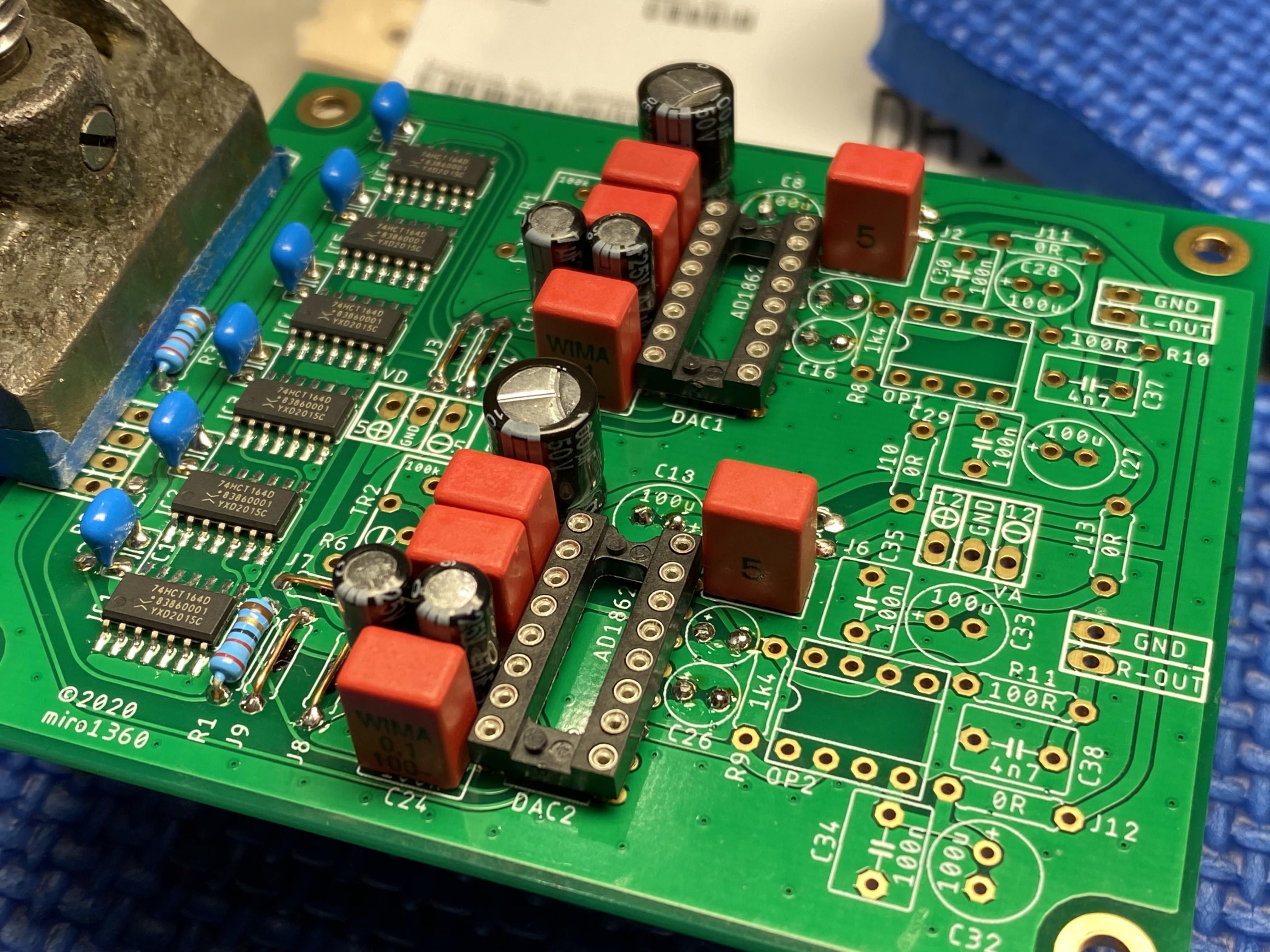

So far, with the Dac board built as spec’ed, I’ve tried AD1611, LM6171, Burson V5 & V6, all have sounded very good. I will build a second board with some modifications to allow the use of OPA860/861 OTA’s. Hopefully, I can get two working boards to quickly A/B listen.

... Hopefully, I can get two working boards to quickly A/B listen.
perfect Vunce, test it ... if it helps, I could create a small PCB for I/V socket, vertically oriented ... (with +-5V regulators on the pcb) ... or can you test on a breadboard pcb?

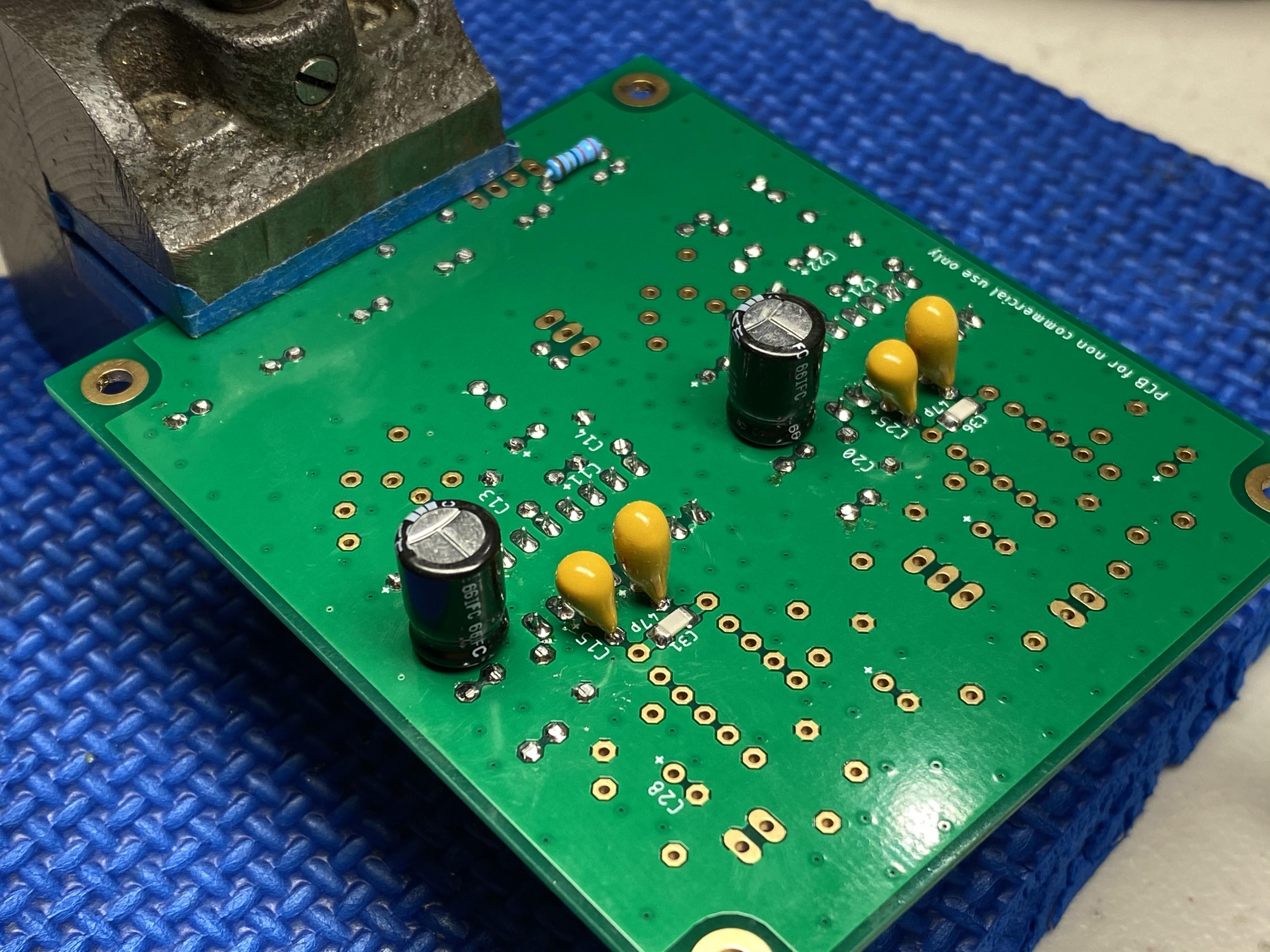

For anyone building Miros board, you shouldnt install the MSB adjustment components unless you plan to tune with an analyser straight away.
While it allows fine adjustment of MSB it will also allows the MSB to be severly misaligned causing massive crossover distortion, only a tiny fraction of the trimmer's range has precision the same or better than the chip without the MSB adjustment parts installed

Second board is ready for Transconductance Amplifier I/V experimentation. I will implement Miro’s schematics from posts #317 & #320 via breadboard.
