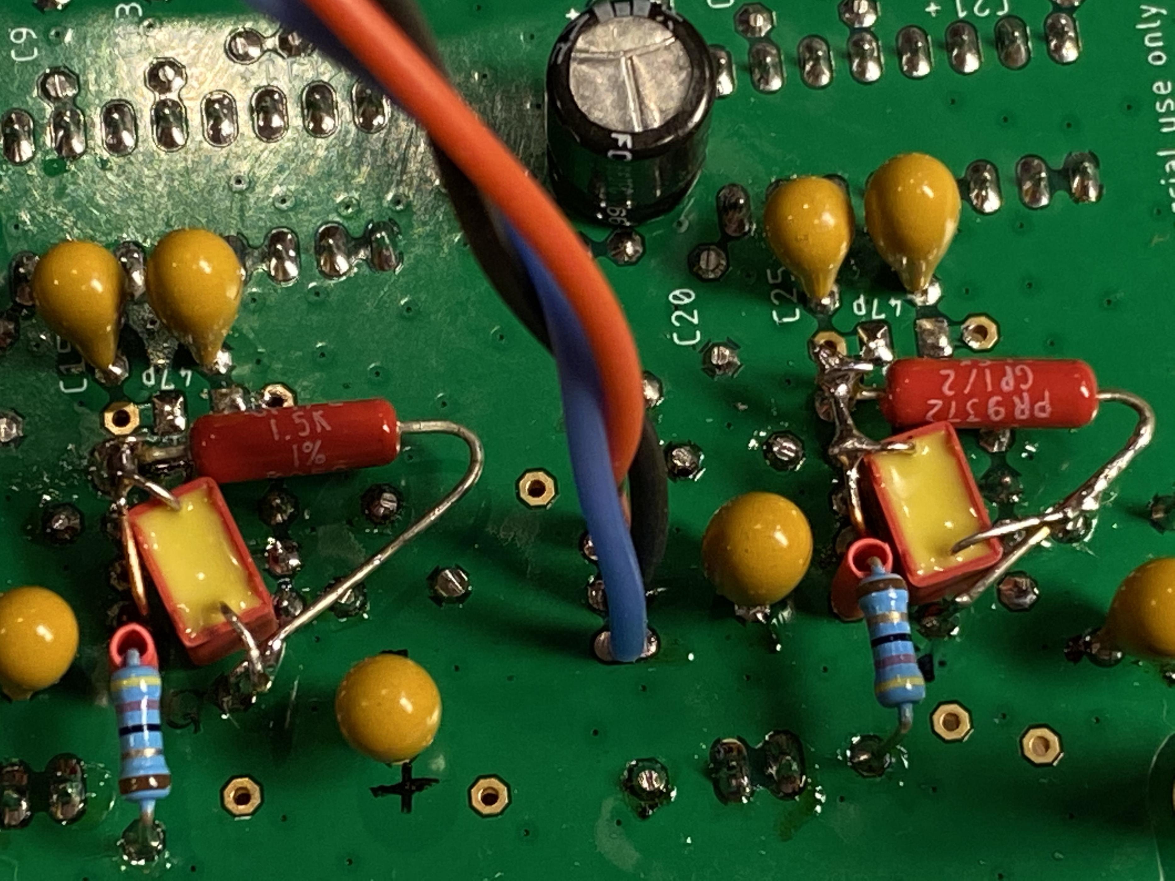

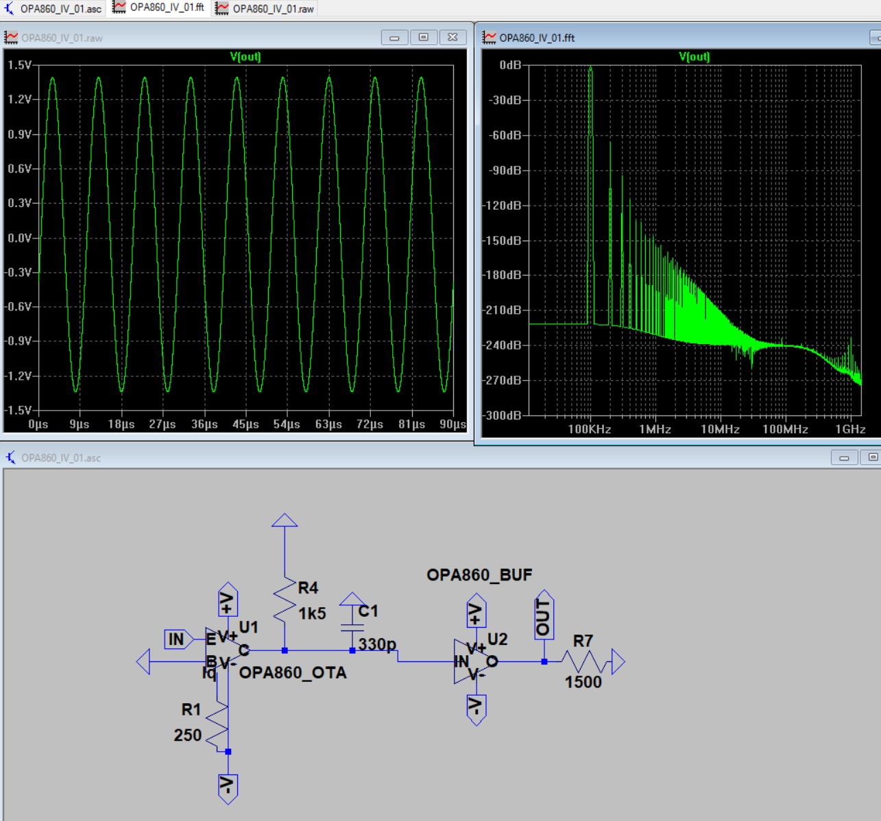

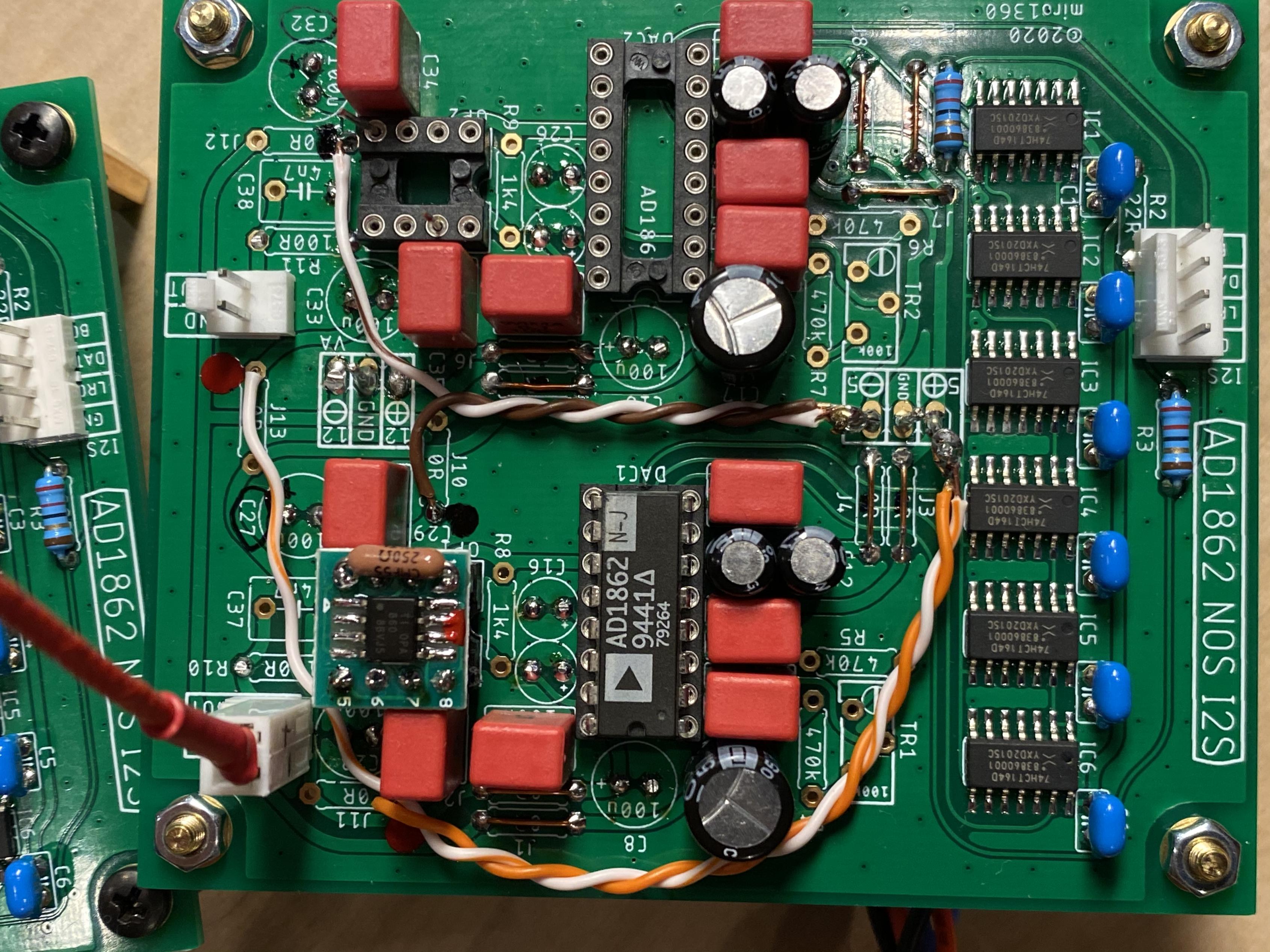

Hey Fellas,
I have the 5v psu section dedicated to the I/V circuit to power the OPA860’s. Miro’s SIM circuit is populated under the pcb, the 250R bias resistor is mounted directly on pins 1-4.
I powered up the circuit without any chips installed to make sure the voltages were proper with no shorts anywhere, all was good. I installed one AD1862 and one OPA860 and powered up slowly with a variac. At 3.5vdc I measured 60mV of offset. At full power, 5.1 VDC, the offset dropped down to 15mV.
The 860 does get hot. At first, I thought I had a problem, but I think that’s just the way it is. I have IC chip heatsinks I can bond to them just as a precaution.
I listened briefly just to make sure there was no funky things going on, I did notice the volume is very low.
The first board I built had a 1K4 resistor installed at R9, then I increased it to 2K4 and it the volume is perfect. Will increasing R4 on the OPA SIM schematic have the same result?
Also, I reduced the 100R output resistor to 47R.

Looks fine Vunce, temperature will be higher because the IC drops about 120mW (together with buffer). (R9 from the PCB has to be left unpopulated, because a different I/V is installed).
Also the change in R4 (in new I/V) increase the output voltage in the same way as the opamp I/V does.
When you disconnect the R9 (from PCB) then the output voltage should be higher (R4 and R9 were propably parallel).
