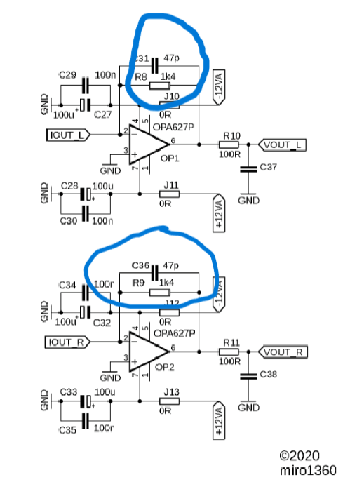

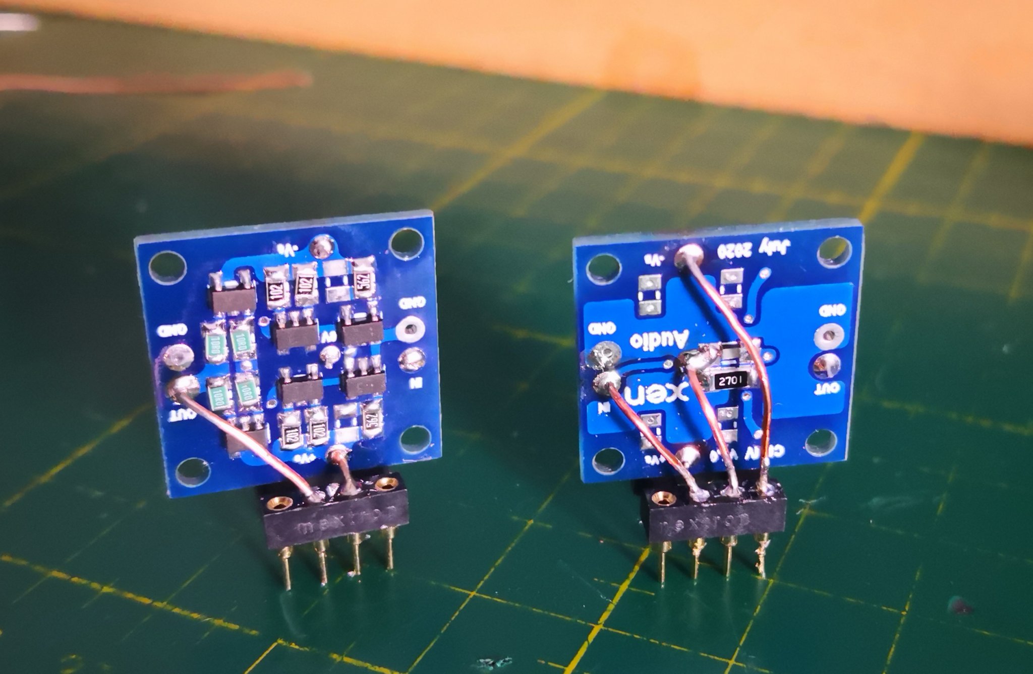

A word of warning for those building the XEN CM IV and using DIP8 plug-ins, like Paddy and Ripster did.
You MUST remove Riv and Civ from the miro board, and you must solder (SMD) Riv and Civ on the XEN boards.
It is NOT plug and play swap for DIP8 opamps.
If you want to go back to opamps later, you need to reinstall Riv and Civ on the miro board.

Just to be sure. Are these the Riv and Civ that you are referring to ?
YesView attachment 1046830

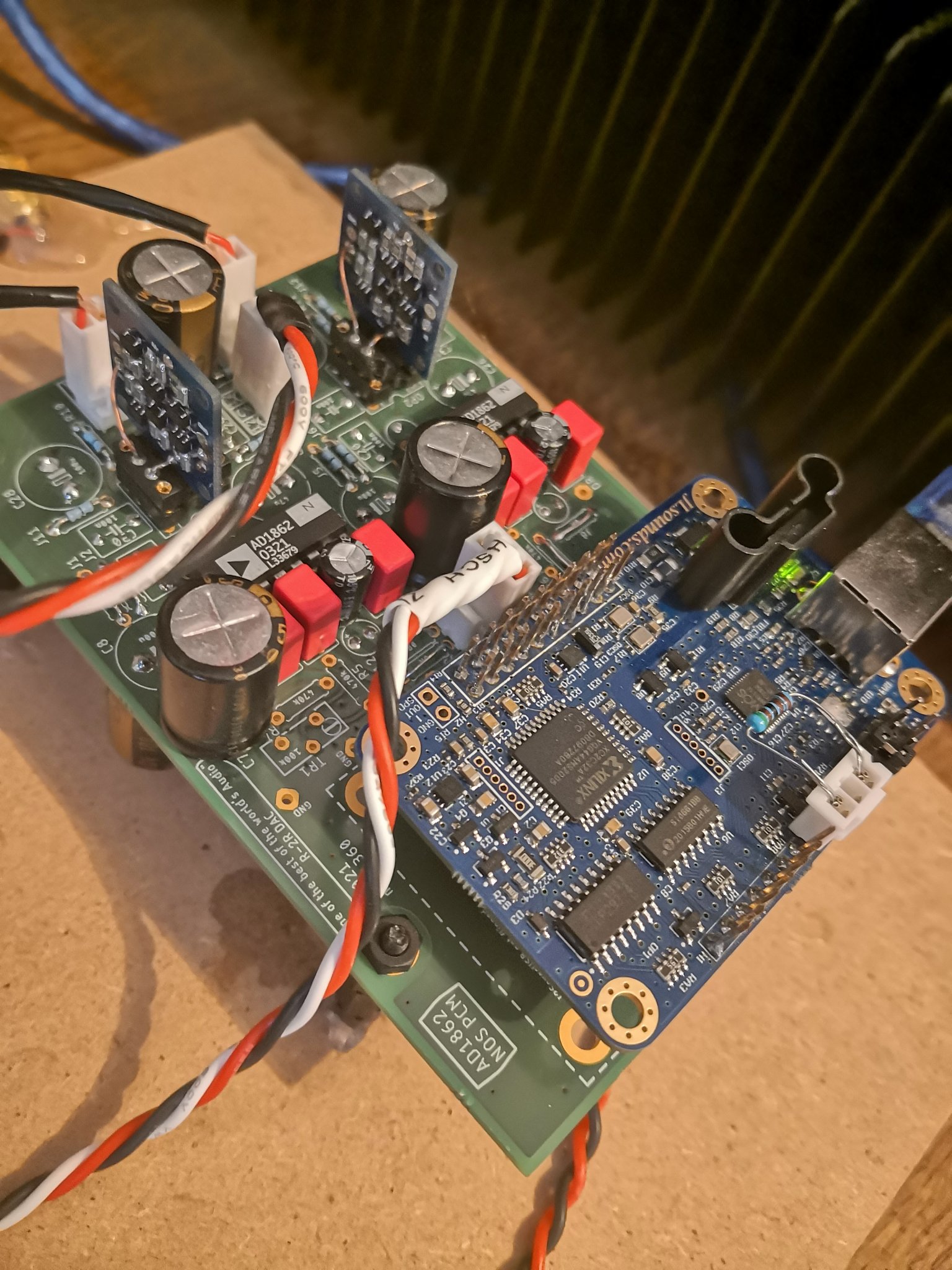

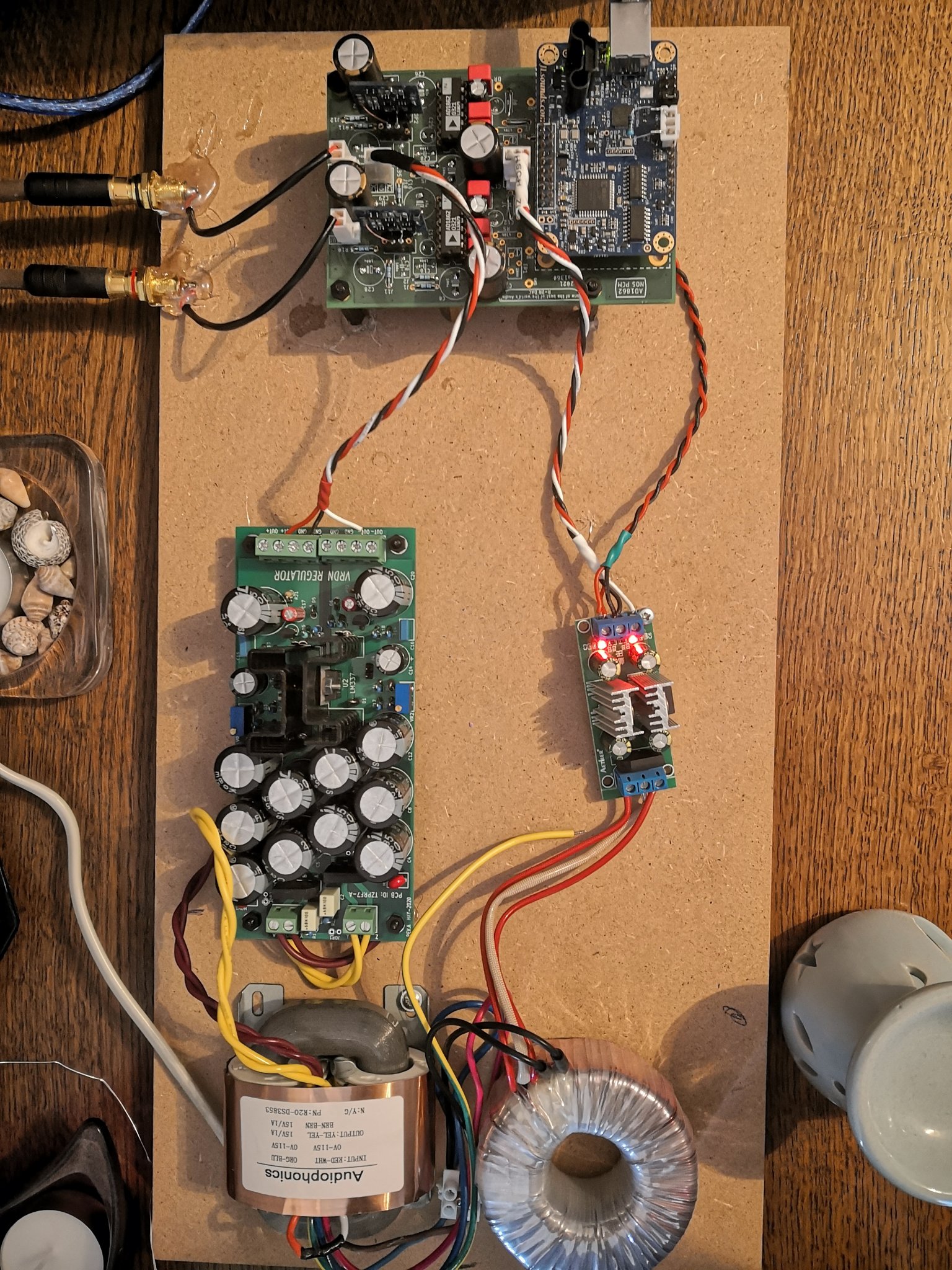

So my latest frankenstein just put a few things together laying around.. Need to find a better 5V supply. This is just some chinese board but I replaced the MC78xx chips. For powering IV I have built VRDN from Mark Johnson. New DAC board from Miro that has a jlsound i2soverusb header.. And CM IV from Patrick. I really like this IV stage from Patrick in my setup with My_ref amplifier and Elsinore speakers' bass is so clear and sharp I just can't stop listening. And vocals have also become more clear compared to burson V6. And everything remains as easy to listen as before no fatigue I could easily listen to this all day...
