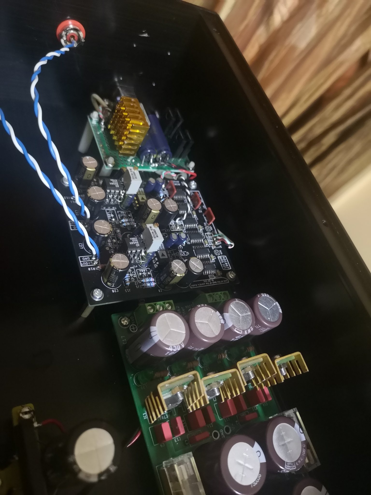

Thanks to Miro for the design and #jimk04 for sending me the boards. Finally put them into a chassis.

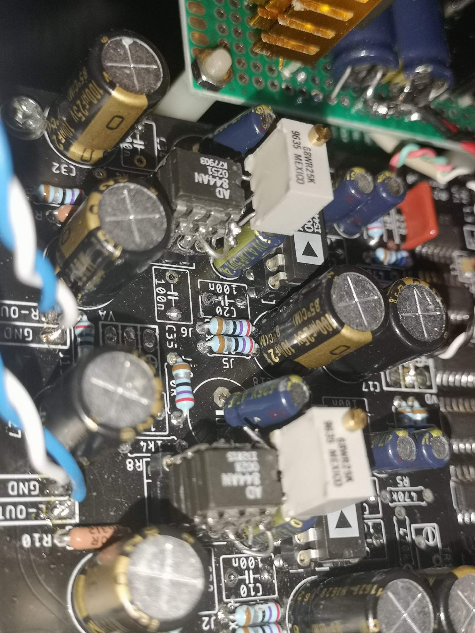

I had the opa627 installed initially and find it sounding lack of spatial quality in complex music. sounded flat and two dimensional. Installed a single AD844, well was better but not good enough. Stacking 3 of them, and wow...... i think it is the way for me. Currently taking the output from the buffered output of the AD844. I will experiment with taking the non-buffered output and connect them to an external buffer next.
Reactions: 1 user
very practical
could you please tell where did you connect trimmer to ad844 to null DC offset
