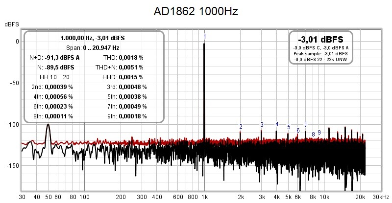

Hi Vunce, yes I populated the MSB trimmer components but I trimmed it by measurement. I guess my ears would not good enough and I am not the most patient guy...
Yet sound is pretty good now, but it was before as well. Maybe cleaner, maybe not, probably yes ;-)
